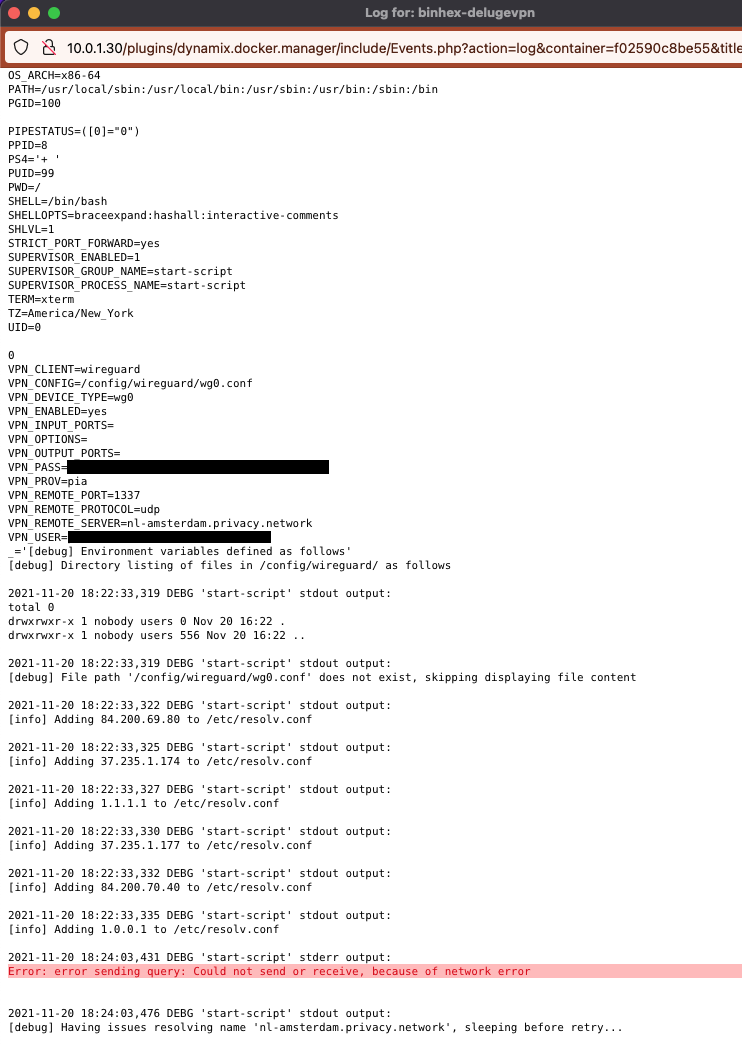

Also trying to migrate to Wireguard.  Except when I follow the directions with wg0.conf is not generated at start up.  Just get an empty folder.
121535234_ScreenShot2021-11-20at6_24_24PM.thumb.png.0fc6a2c85b849edd07bce42b2c393a2d.png
Edited by Flyinace2000
Say it with me everyone, it's always DNS.  Removed all the DNS Servers from the docker settings except for cloud flair and (for some reason) my routerIP (not my DNS server).  Restarted and it worked.
My router is an OpenSense box running Adguard.
Either way, up and running.
Yes the issue was with pia DNS which has sadly stopped working, so removing pia DNS from the list will get you going again.
