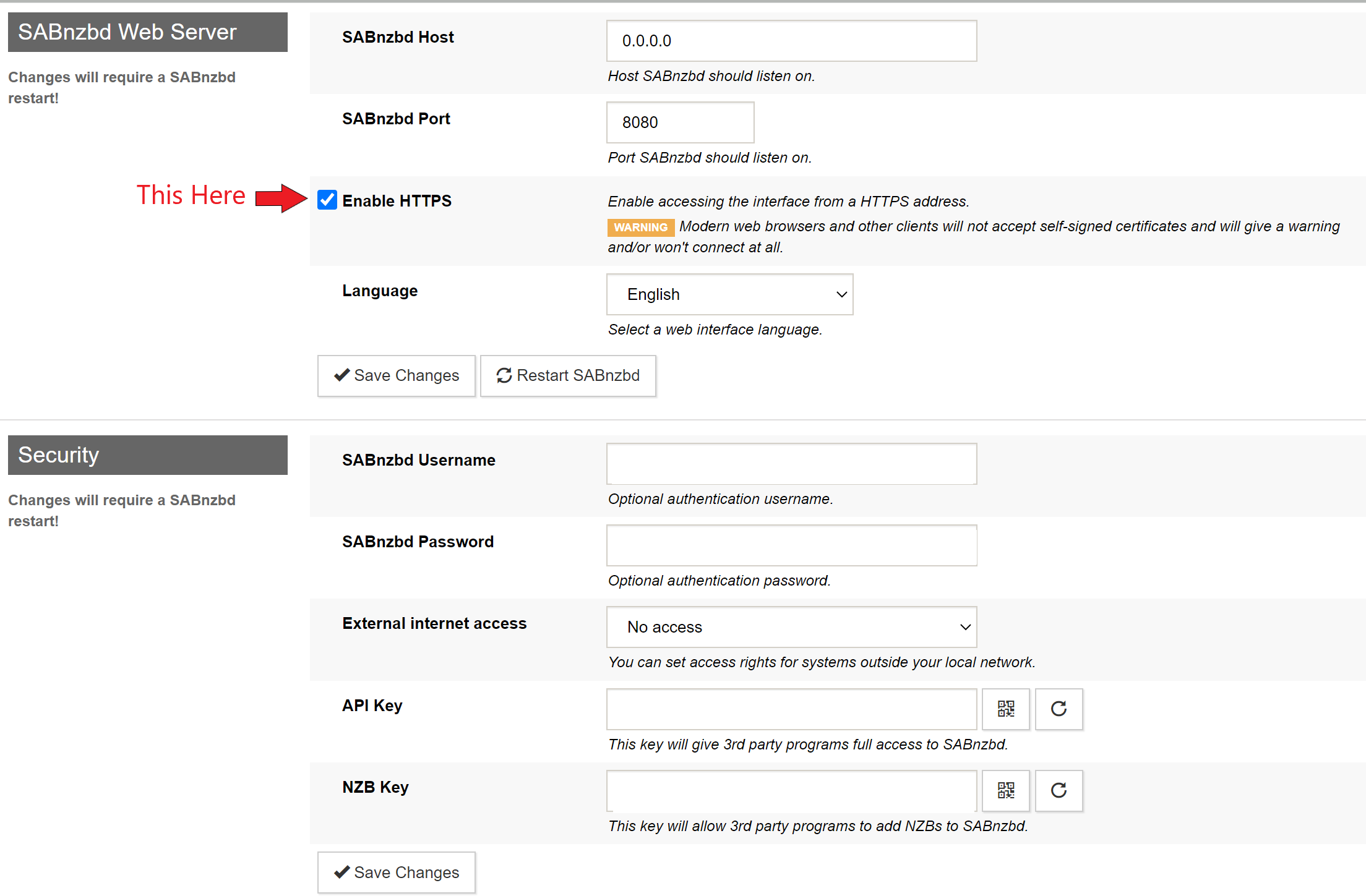

The above is not working for me.
It won't even let me disable listening on 443 (HTTPS) for SABNZBD, it keeps enabling on reboot. There is really no need for me to listen via HTTPS as I use SWAG for reverse proxy.
All my *arr applications talk to SABNZBD via HTTP and not HTTPS locally.

  • brawny had the answer in another thread that helped me. put simply, check  Local IPv4 address, under status and interface options (the wrench) in sabnzbd and make sure that they are the sam

I believe he is talking about the setting above the one you have in your screenshot, please see below.

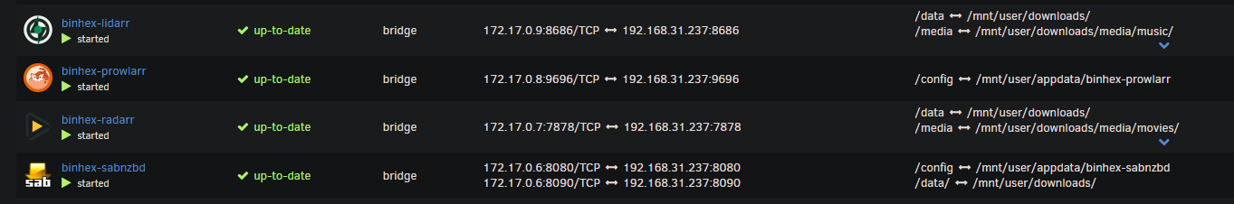

I am trying to get binhex-SABNZBD deployed on an alternative port in Unraid. I can get it deployed and working on port 8080 but I want/need to get it deployed on port 3000.
The config.ini keeps changing back to 8080 when I start the container.
I have tried changing the container ports before deploying and that didn't work, including selecting the advanced view and changing the port for the webui.
Is there a guide or something I am missing to get the port moved when deploying this on Unraid?

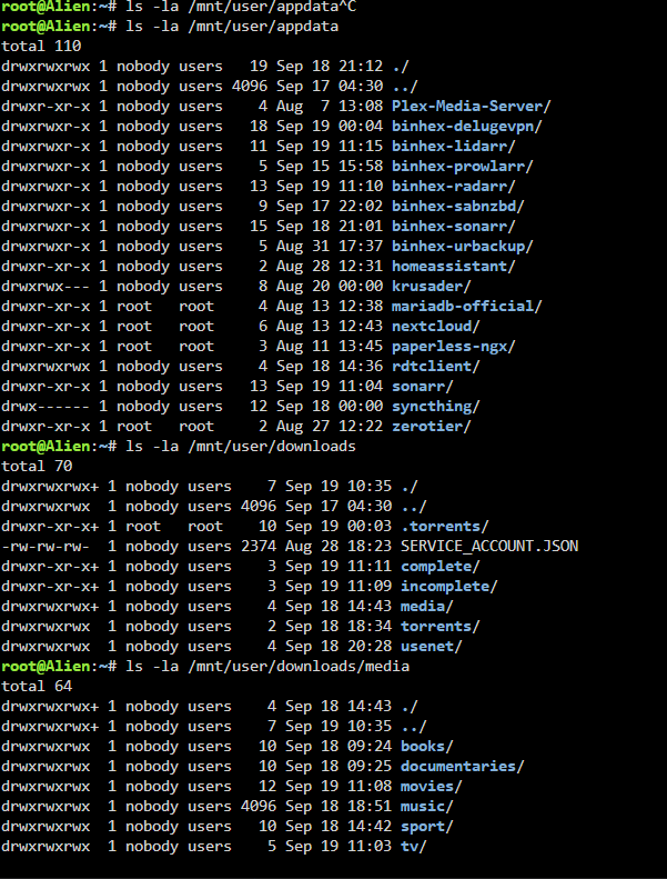

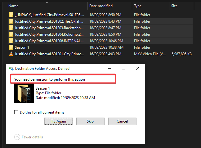

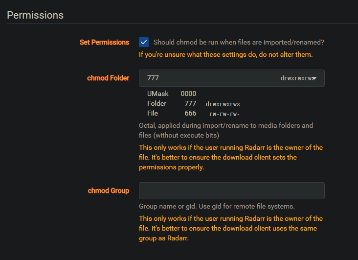

I have set up a new container and made some changes to the docker settings.
I am facing a permission issue now. When downloading with a specific category (e.g., "movies" to sub-folder "/movies", all works well and all permissions are set correctly.
When downloading just to regular download folder, the files are downloaded, but the folder (e.g., from a movie or music album) has wrong permissions. The files inside are fine though.
Any idea what could be causing this and what I can provide for troubleshooting?
Mapped drive is (unraid docker setting)
Container: /data/usenet
Host path: /mnt/user/appdata/sabnzbd/usenet
Completed downloader folder (in sabnzbd setting)
/data/usenet

I have permissions problems:
In windows explorer: I cannot move / edit / delete files
I have tried multiple file mapping combinations, docker safe new perms, windows permissions, and so far nothing has worked.
I'm not totally sure if there is something here also:
Although this option is not available on Sonnar anyway (that I can find anyway)
Any advice appricated
