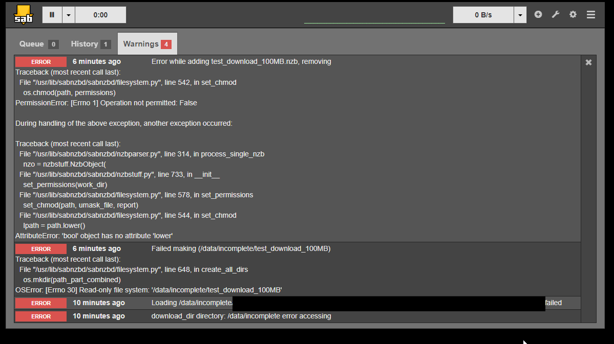

My install has been working fine for a while now, but when I checked it this morning im getting a lot of permission errors out of nowhere. Does anyone know what could cause this and how to fix it?
I poked at the server during lunch, it looks like the cache drive is failing and not allowing any new writes. Switching the /data/ share to use a different cache pool fixed the issue.

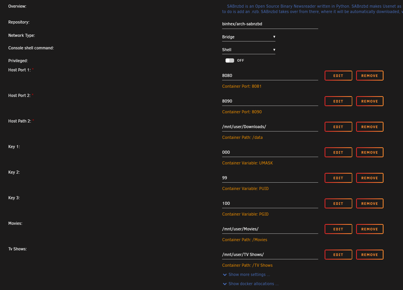

Is it possible to change the default /Data to /downloads/ looking at Sabnzd I can see that it says:
And it would be easy to just change it in the Docker:
The reason I would like to change it is that I have a working setup "Remote Path Mappings"
So I need for all download clients to look in the same defined path
Hope this makes sence to some that might have the same setup?

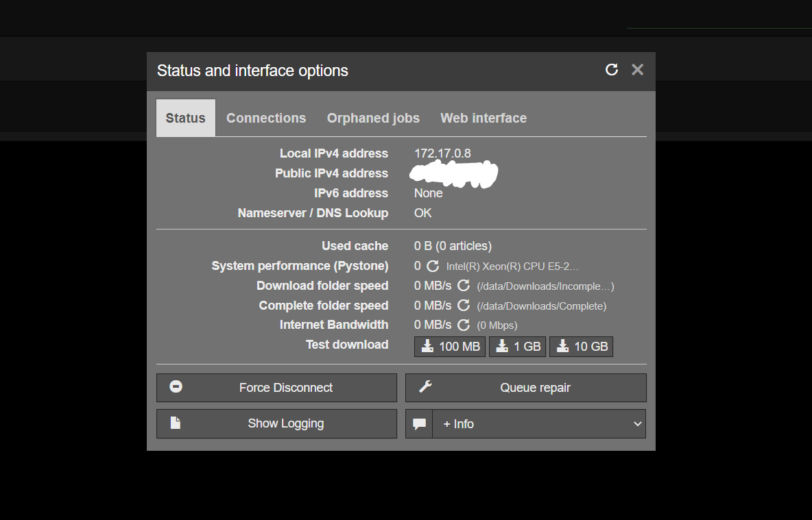

Hey all,
Sab has been tweaking for quite some time now. (quite honestly everything has) but one thing at a time.
It is constantly changing its IP on me and is throwing off Radarr and Sonarr. In the settings where you can change the host IP I have it set to 0.0.0.0. Maybe it's done on purpose or not but I can't actually change that value within the interface. And even stranger is what I see when I open the menu that I have attached. It says my local IP isnt 10.0.0.55 (which is the IP of my server). It says 172.17.0.8. AND EVEN WEIRDER is that the last digit changes every couple of days to 172.17.0.2. And then back again.
Like I said, I am having problems with sonarr, radarr, and deluge. So I am trying to hit the low hanging fruit first before I have to get the ladder if you get what I mean.
I have heard some people change the IP to be the public one and just use duckdns so that way this issue never will happen. I'd love some help doing that if anyone knows...
I have also attached sabs settings page in unraid if it helps at all.
When you tell Radarr / Sonarr the IP address of Sab, you don't tell it the container's IP address.  You give it the HOST's IP address and applicable host port (8080).  The container's IP isn't particularly guaranteed to be anything and will change with updates etc.

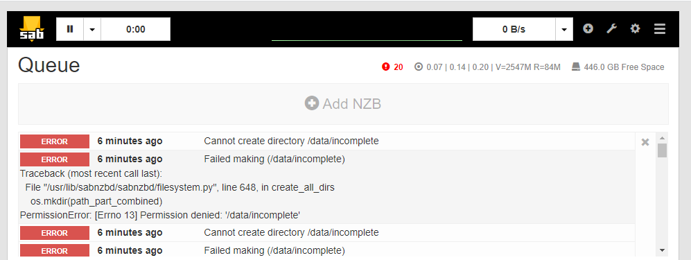

My volume mapping is data > mnt/cache/Downloads
Checking out that directory in MC, there was no dir called incomplete. I created one. Downloads started after clicking retry in SABnzbd.
Not sure if incomplete existed before, or downloads were occurring despite it not existing. I guess we'll never know. ;)

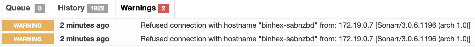

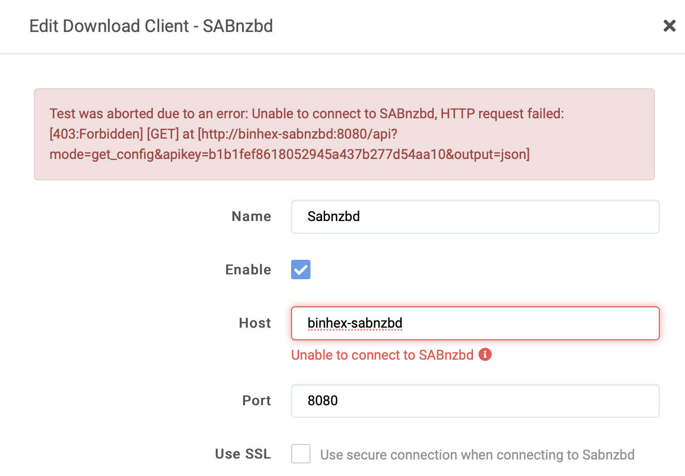

I've had a new issue with SABNZBD for a few days now. I'm not entirely sure when is started, but for some reason, neither my Sonarr nor my Radarr containers are able to add downloads to SABNZBD. They are all on the same custom network, and both of them can ping the SABNZBD container both by IP and by hostname. If I try to test the connection from either, I get the following:
Test was aborted due to an error: Unable to connect to SABnzbd, HTTP request failed: [404:NotFound] [GET] at [http://binhex-sabnzbd.privnet:8080/api?mode=get_config&apikey=b1b1fef8618052945a437b277d54aa10&output=json]
Here is my configuration screen:
I am also seeing the following warning in SABNZBD when I run the test:
Slightly stumped where next to go with this one. Any ideas?
Thanks.

On 6/4/2021 at 1:50 PM, Lumpy_BD said:
this is a bit odd, as the hostname specified in your screenshot is binhex-sabnzbd NOT binhex-sabnzbd.privnet, try specifying ip address instead of hostname, you could also always try a restart of your system, perhaps something has screwed up your custom network.
