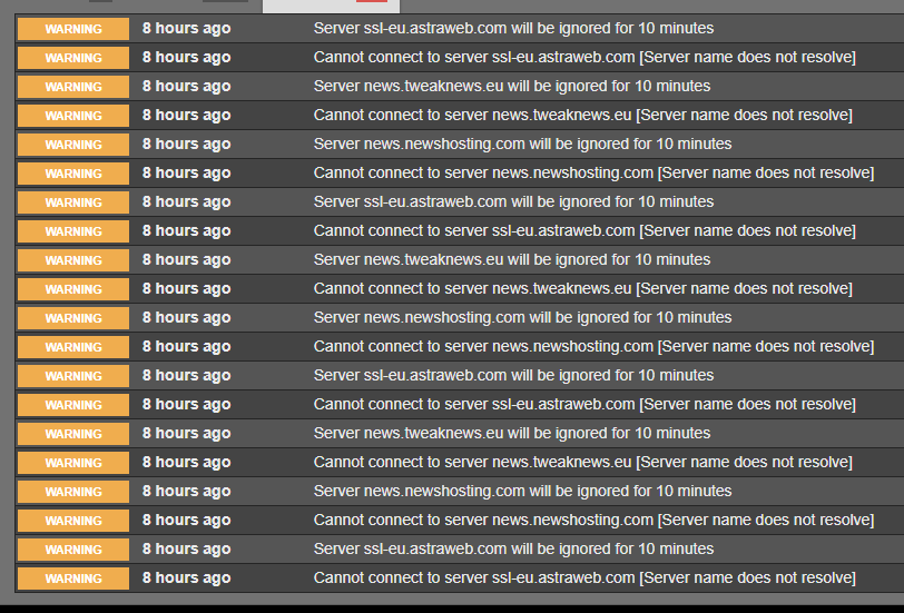

On 8/31/2018 at 4:37 AM, newoski said:
Suddenly getting lots of errors connecting:
WARNING 2 hours ago Too many connections to server news.newsgroup.ninja
WARNING 3 hours ago Server news.newsgroup.ninja will be ignored for 10 minutes
WARNING 3 hours ago Cannot connect to server news.newsgroup.ninja [Server name does not resolve]
WARNING 3 hours ago Server ssl-eu.astraweb.com will be ignored for 10 minutes
WARNING 3 hours ago Cannot connect to server ssl-eu.astraweb.com [Server name does not resolve]
WARNING 7 hours ago Server news.newsgroup.ninja will be ignored for 10 minutes
WARNING 7 hours ago Cannot connect to server news.newsgroup.ninja [Server name does not resolve]
WARNING 7 hours ago Server ssl-eu.astraweb.com will be ignored for 10 minutes
WARNING 7 hours ago Cannot connect to server ssl-eu.astraweb.com [Server name does not resolve]
WARNING 8 hours ago Too many connections to server news.newsgroup.ninja
What kind of logging/info would be helpful to troubleshoot? I'm on the latest stable Unraid, latest SABnzbdvpn update

Been getting a lot of timeouts lately.  All is well when I use the SABnzbd client.  But SABnzbdvpn is getting these timeouts.
Too many connections are because the client is retrying before the server realizes that the old connections are dead.  Instead of using news.newsgroup.ninja, try using the IP that it resolves to.  My guess is that we are all getting timeouts because there is a bug in SABNZBDVPN.  The timeouts are causing the retries which are causing the too many connections.
