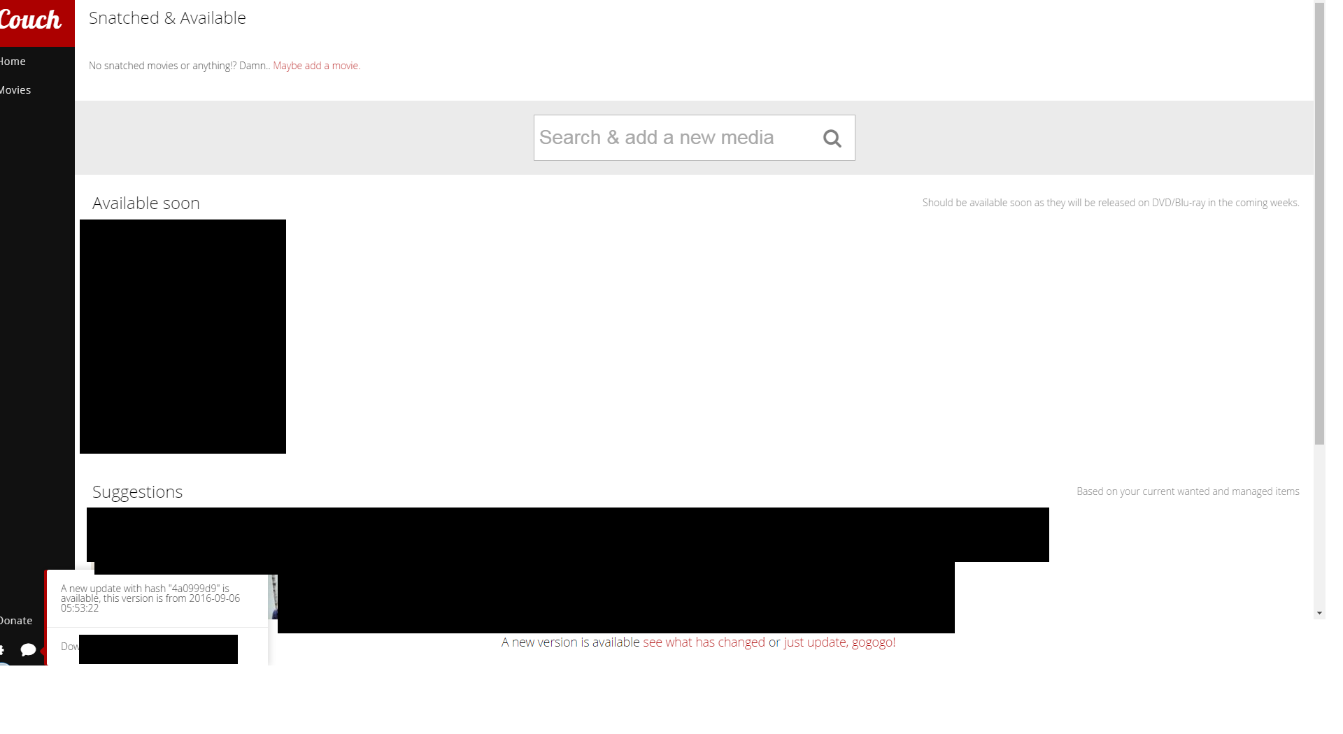

Strangely enough, my CP (non-git) just announced it has an update available... lol
Hmm odd, there hasn't been a new release since 2015, I just double checked and that's still the case. In assuming it's set to pick up github releases only.
Sent from my SM-G900F using Tapatalk
See attached.
See attached.
Ahh that's the latest commit to master, I know that because I recognise the hash :-) its the same one I used to build couchpotato git
Sent from my LG-V500 using Tapatalk
Also, just realized im using lsio version of CP, oops!
