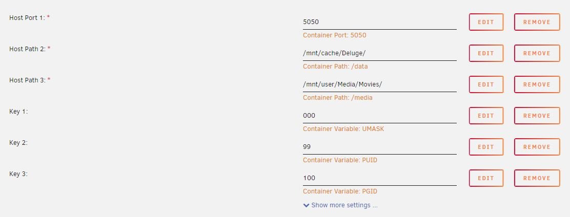

I think I need help. I have just installed Couchpotato and I am in the progress of setting up my folder locations etc, but even time I click on a folder lcoation to browse to that folder I am presented with a black box. and no options to navigate out to the right location.
I have check  my settings locations and there look OK,as I compare them with sonarr.
example when I go to enter in my movie folder location I get this.
any ideals ?
My first thought would be to drop Couchpotato and go install Radarr.
But also, why is your host path going to /mnt/cache/Deluge/
Shouldn't it be /mnt/cache/couchpotato/
The reason for the path is mainly quest work. I will retry the above link when i get home.
And the reason for CP is becouse i like the application
