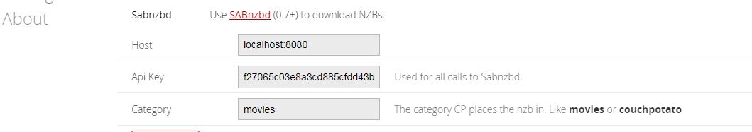

Fist off thanks Binhex for providing this docker, i have been able to setup most things without issue but i do have a problem with setting the sabnzbd ip address in the downloaders section.
Every time i change it from local host to the ip address i hit test it comes back successful i exit go back in and it is back to local host this is stopping me being able to setup a connection to sabnzbd.
Anyone any ideas?
I have gone and directly change the settings file to the ip address but its not picked up in the web interface, if i restart the docker the settings file is changed back to local host.
This happens on Bin Hex docker and linuxserver docker, so seems i may be doing something wrong? I don't think its permissions as all other settings remain persistent.

Maybe check the config file in appdata/ directory.  Check where you have it setup to save the config file and then you could try to edit.

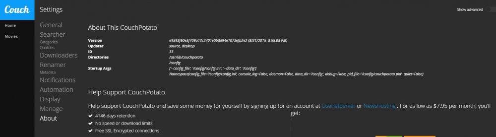

the container works fine, but it is possible to upgrade to the latest Git version.
My current version is 4a0999d9 (6.9.2016)

i can update to the latest master commit sure, but i wouldn't guarantee this will fix the omdbapi issue, as CP is not really being developed any more, and the issue (i would guess) is a change of api at the omdb end, and until that change is fixed in CP it will remain broken, i would encourage you all to migrate to  Radarr:-

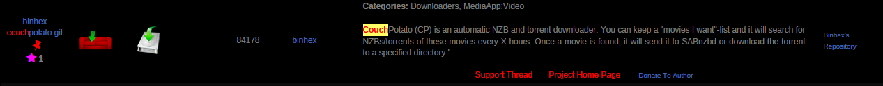

Maybe I'm being a bit slow - wouldn't be the first time...
I found "binhex couchpotato git" in CA:
But when I click the "Support Thread" link, it brings me here.
I've been running the "regular" "binhex couchpotato" for quite a while:
for the most part it seems to be working reasonably well, but there have been a few minor glitches.
A) is this the proper support thread for the "git" version?
B) if I install the "git" version, do I have to manually reconfigure everything or can I copy my current appdata\couchpotato directory contents to the new appdata\couchpotato-git (or whatever it will be called) directory to maintain my existing configuration?
C) Should I really just move on to Radarr and figure out how to get that working instead?
yep i got lazy :-), couchpotato and couchpotato-git are both supported in this thread, and as i have just deprecated couchpotato i dont think i will bother seperating it.
impressive for software that was last released in 2015! (talking about github "release" here) :-)
A) yes
B) you SHOULD be able to just copy your config across and it SHOULD pick it up - not tested, so be cautious when doing this.
C) if i were you, yes.
ha nice ref to monty python, "i feel better, you're not fooling anyone!)

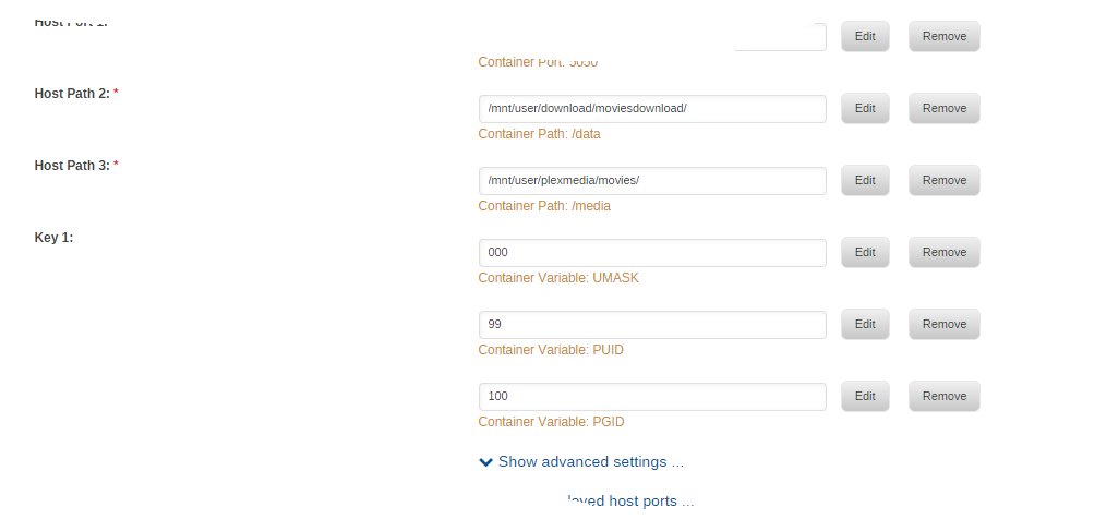

Hi, i think i have a brainfart here.. cant seem to understand how to setup couchpotato within docker.
Se attached pictures for docker setup and settings in couch. But i cant seem to get the files downloaded to right directory, and the renamer to get into action.
Anyone can give me a step by step here? thx.
