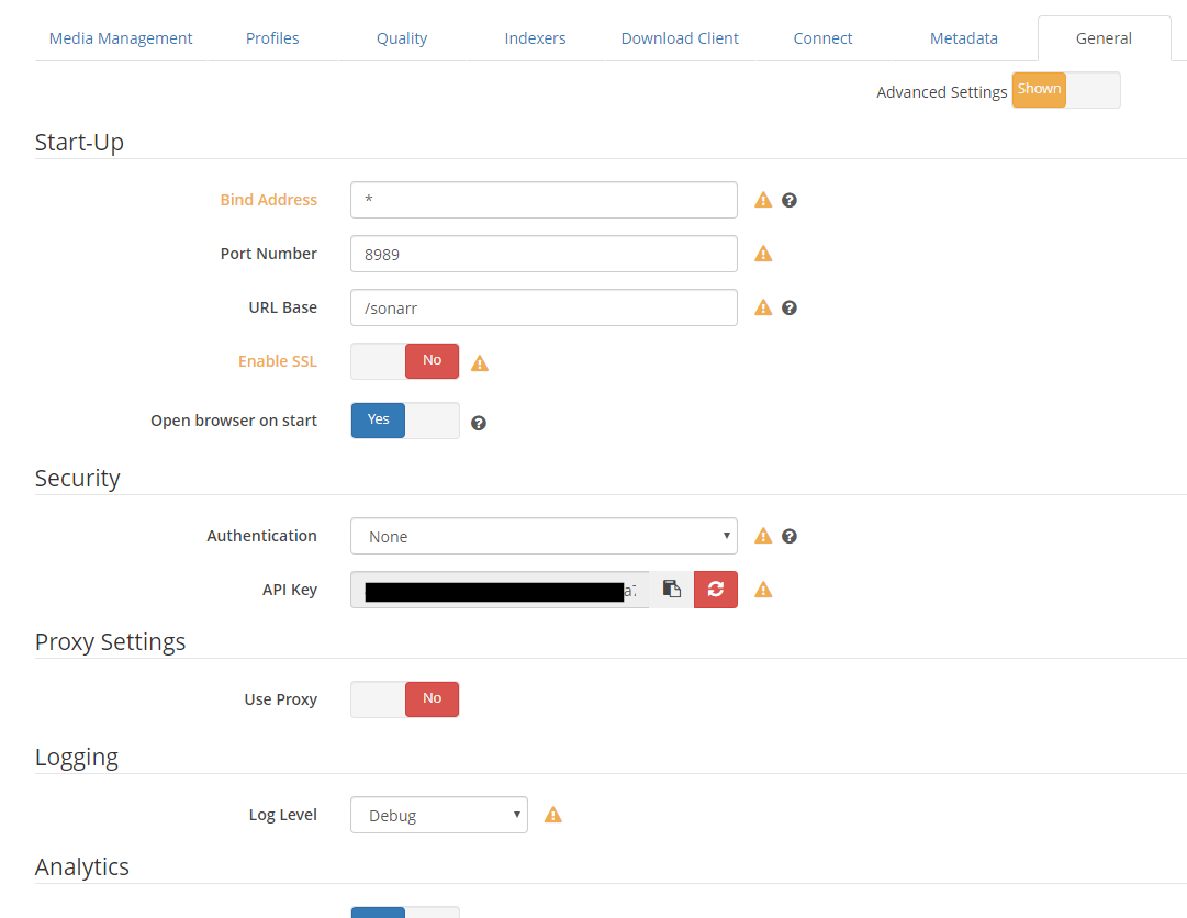

Hello.
Ive looked through many of the pages in this thread looking for my answer.
Currently i have access via http.
I am unable to figure out how to access the gui via https.
Container variables as default settings.
Port 1 8989
Port 2 9897
I assumed 9897 was for https.
In sonarr container i set https and put that port in. Saved the settings.
Then restarted the container.
I can still only access rhe gui via http.
http://<host ip>:8989  Fine
https://<host ip>:8989 fails
https://<host ip>:9897  fails
Any help would be appreciated.
Thank you

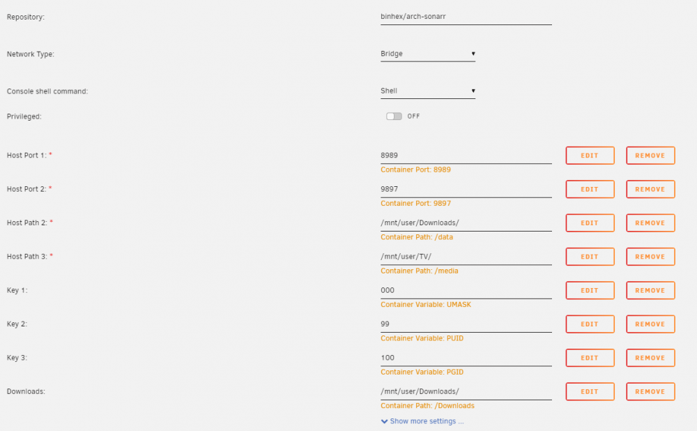

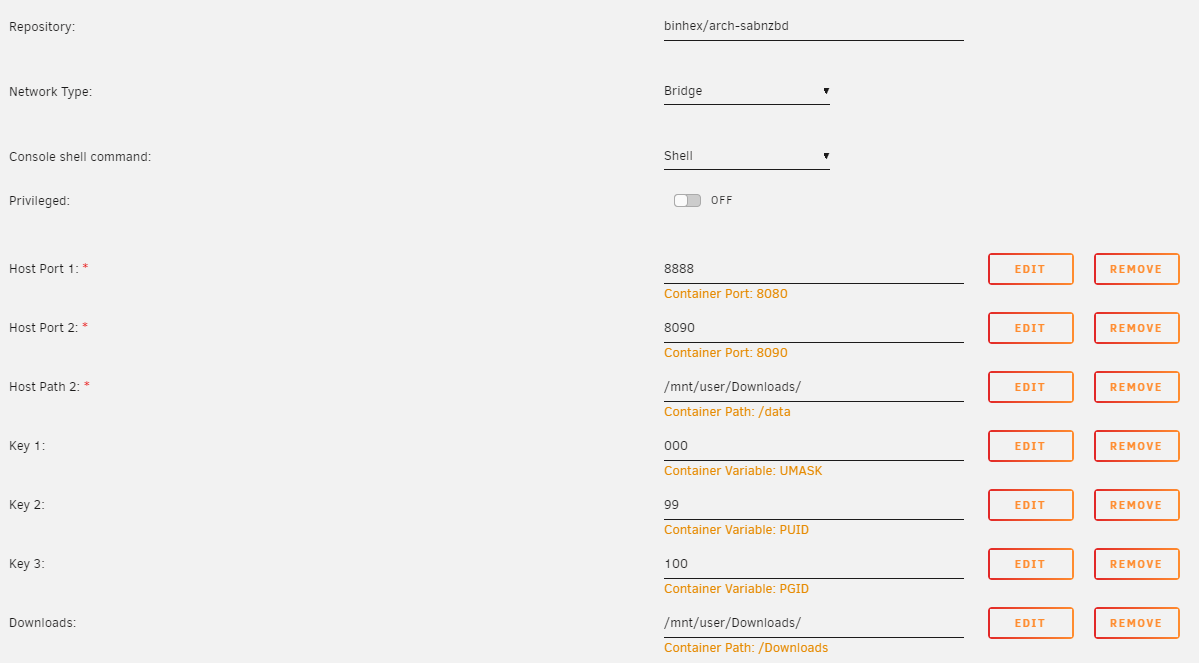

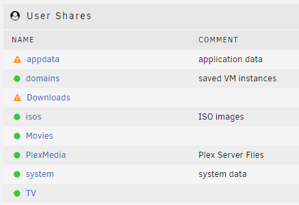

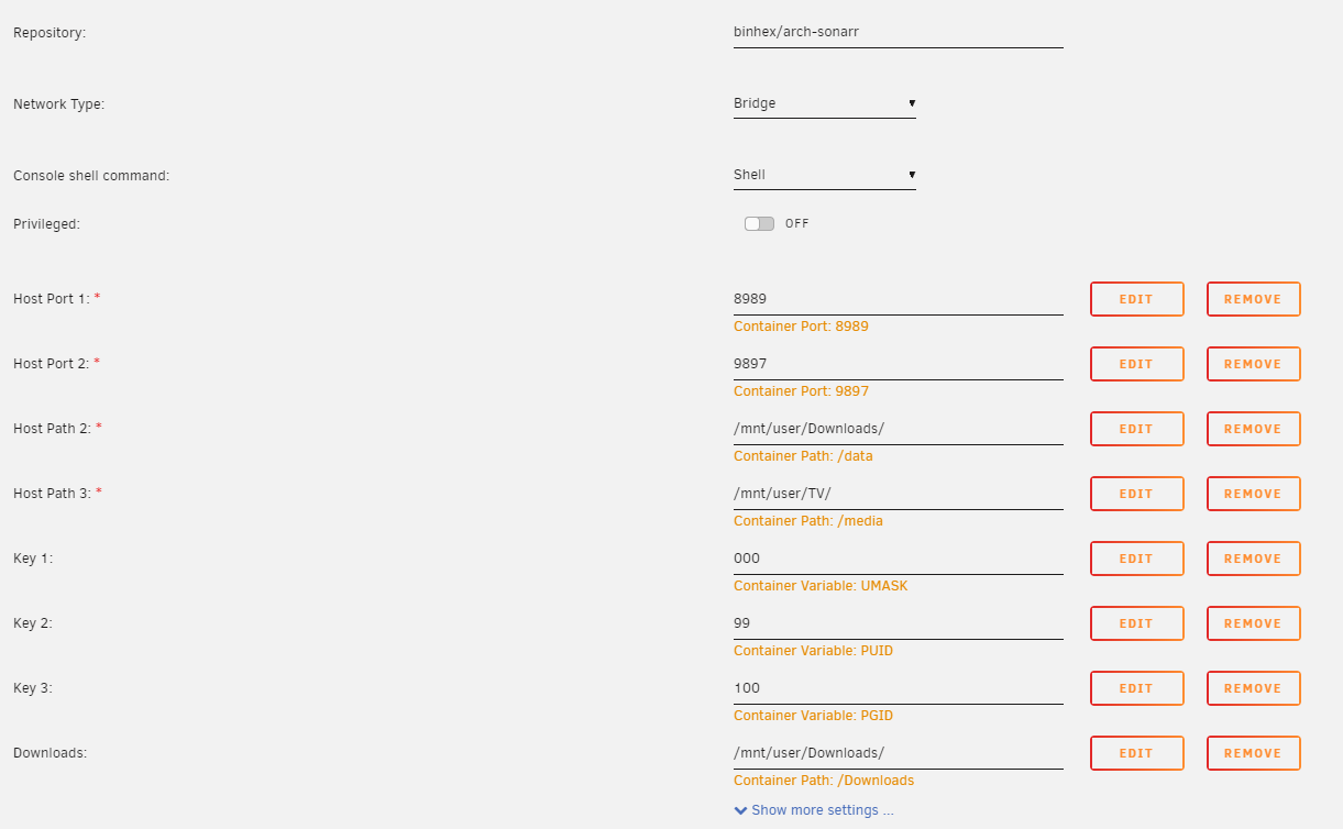

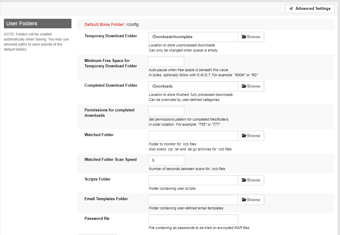

I read through that and I think I have everything 100% accurate in the settings, here are the images:
SONARR
SABnzbd
Sonarr doesn't seem to have any settings that I can find to tell it where to check for files that SABZ downloads.  I am assuming "Host Path 3" is the location where it pushes the files to after they are downloaded?  Maybe I am thinking of that incorrectly as well.
SABZ - everything the same, so folders looks like:
I still think I have something wrong.

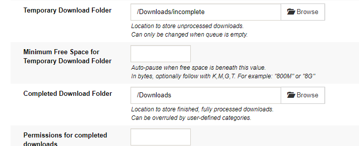

indeed you do, from the screenshot in sabnzbd your temporary download folder is set to /Downloads/incomplete, but /Downloads does NOT exist in the container, what DOES exist is /data, so you could set it to /data/incomplete.
same deal for completed download folder, you have it set to /Downloads, that doest exist, set it to /data.

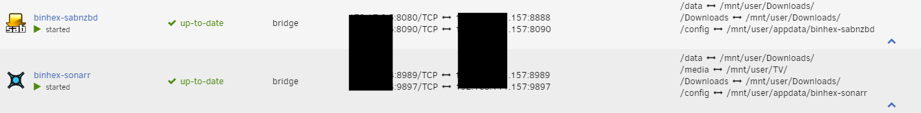

to clarify this, take a look at the snipet from your unraid config screen, note the path after 'Container path' is set to '/data'
Edited by binhex

The container does not know anything about your shares unless you map them to a location in the container. So if you want access to anything in you shares you first need to map it to a directory in the container. Say you want access to you tv folder, on the host side you set your tv folder path, and on the container side you need to "mount" that folder to a directory we can call /media as an example. So the container does not know anything at all about your files on your server unless you map them to a directory in the container. I know it's all confusing at the start, but we've all been there :P
So your tv folder share would then be /media in the container

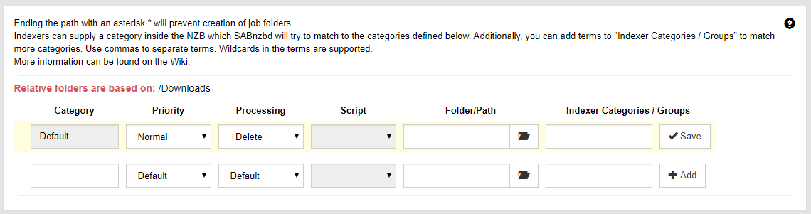

Sure, here are some settings:
SAB - Folders
SAB - Categories
This essentially says it will store in /Downloads any file (because no categories are sent up).  As a result, it stores it at:  /data <-> /mnt/user/Downloads

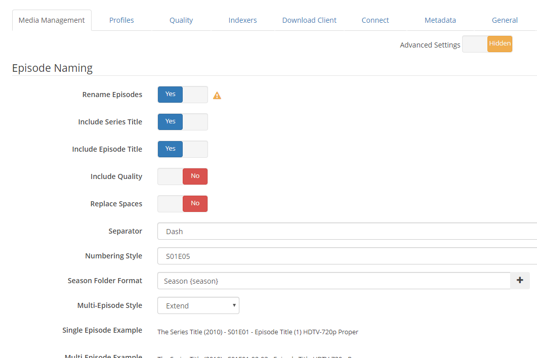

SONARR - Media Management

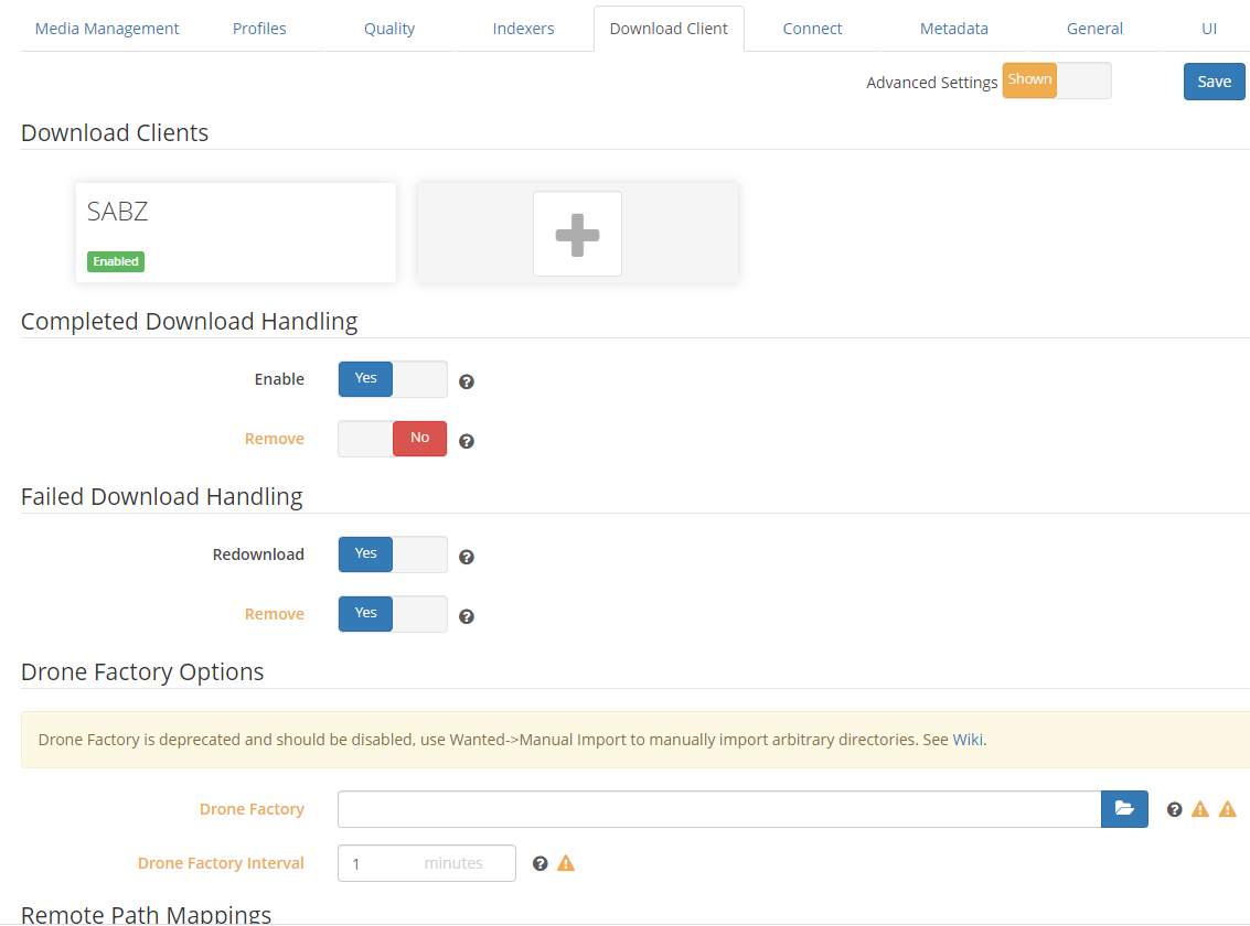

SONARR - Download Client
No remote mappings required as far as I am aware, they are all local folders mapped in the container
Yes, I did know most of that... but mostly out of trial and error :)   That is why in SONARR, I have:
Which maps /media to the /TV share, which relates to TV in the User Shares here:
Which then relates to:  /mnt/user/TV/
It definitely is confusing at first and I think I got that right.. I do NOT know if SONARR just 'knows' about that /media mapping or if it is looking somewhere else for the downloads.
But I thought you changed the settings in sab after the comment from @binhex? But you haven't, please read his post again. You settings is wrong, remember the /downloads location doesn't map to anything on the host side.
I didn't - that was why I asked so many questions like about selecting that location (so, SAB knows about it if I can select it) and all the files are going there (so, SAB knows about it).  I mean... SAB is doing its job well.  SONARR just doesn't know the files are there (IMO).
/Downloads has all the downloads
/Downloads/incomplete has anything that is incomplete
So.. SAB is downloading and placing the files correctly - which means it understands where it is mapped.

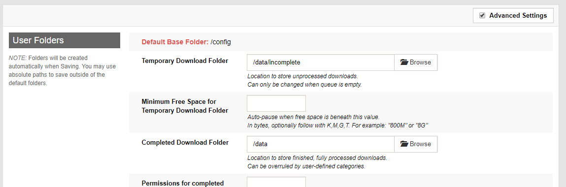

Changed now:
I'm not convinced on this one - but only because my files were in the right spot.
No, you are wrong, That's why sonarr is unable to find the downloads. Yes sab might have the /downloads folder, but that doesn't mean it's correct, Please read the 2 last pages again.
ok.  That is just my ignorance of the whole container and mapping thing :(  Sorry about that.  I am trying to download something else and will find out what it does with it once complete now that I have fixed those folder issues.
