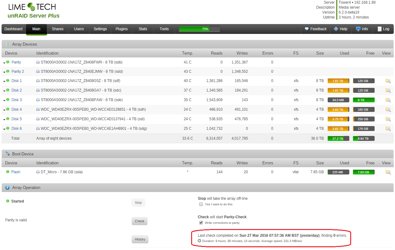

Yesterday did a rebuild of a 4TB disk, it's now indicated as the last parity check, also because the rebuilt disk was 4TB and the parity is 8TB average speed is incorrect.

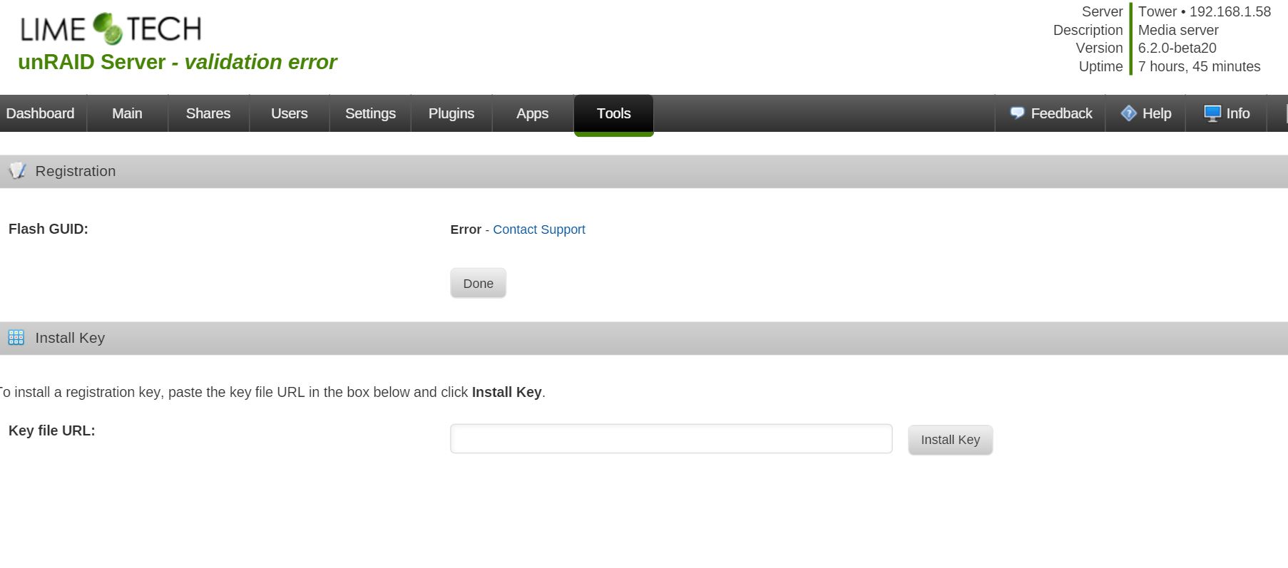

Yup the license check is still a piece of crap. Whatever was done in this release is even worse then the previous two. Previously in 18 and 19 i could reach the unraid web gui and would be told invalid license. Now in 20 the web gui won't load at all until i get a WAN connection, this means i have to manually go patch in a router to get internet access for the license check. It is as retarded as it sounds !!
I really don't know why more focus isn't placed on resolving this rather poorly thought out license validation and wasting effort on throw away inclusions like updating firefox in the console gui who no one asked for / wants / even needs.

Currently waiting for LT to respond to fix a license validation problem.
