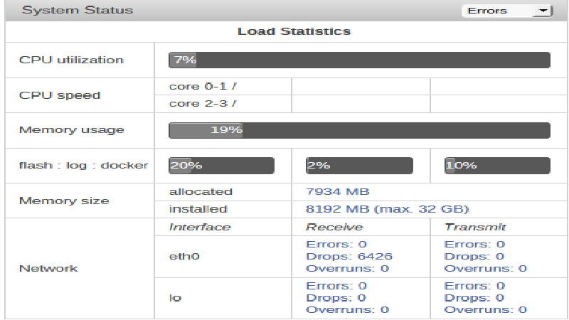

I have found that the CPU core speeds are now not being shown since updating to b20, they were shown correctly in b19?
I assume you read the earlier posts about CPU speed display?  You need to provide more info, such as your diagnostics, and perhaps screen captures from both beta19 and beta20 for comparison.
Please find attached screenshot, diagnostics to follow
Thanks for the screenshot, the non-display will be corrected in the next version.
also my cpu cores are in seperate fields now. before and after pics attached. is that new??
Yes, it's now shown as "thread pairs" instead of sequentially listing each core, two-per-row.  If you don't have hyperthreading (or disabled it) then you'll see one core per row otherwise you'll see the two threads that physically make up a cpu core per row.
