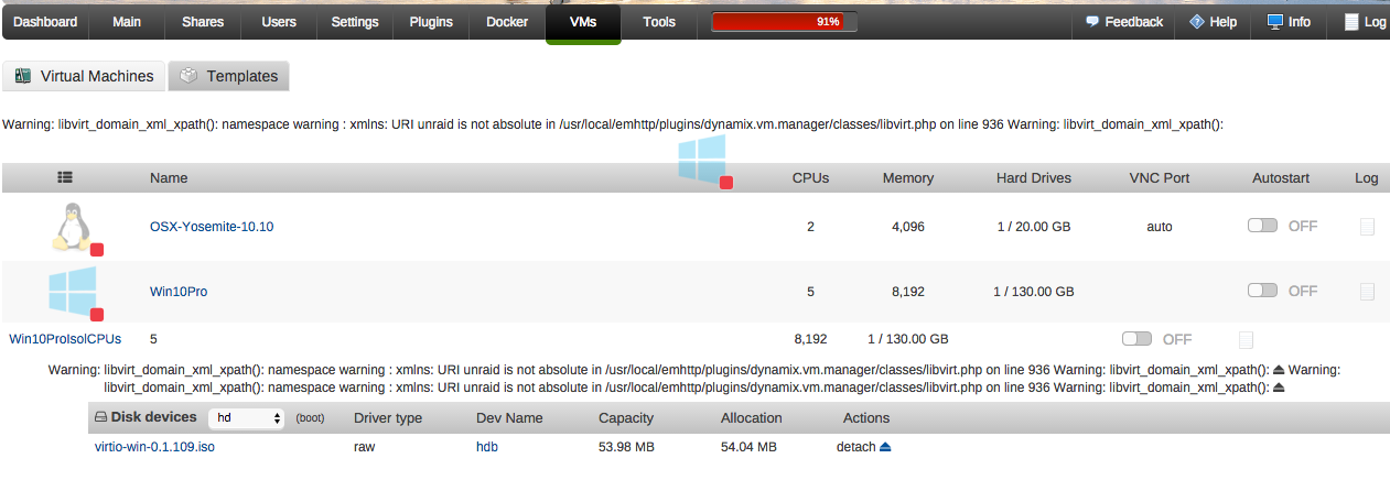

Docker updates worked perfectly but now I am having some issues getting my Win10 VM updated.
I went into the VM tab and attempted to "edit" the VM (Win10ProIsolCPUs) so that it would update to the new settings. I may have done something wrong during that process because now the VM wont start and their are errors displayed on the VM tab. See screen capture.
I have copies of my old XML file and copies of the Win10 disk image. Should I attempt to fix this current "edit" or would it be better to use a template and import the existing Win10 disk image and then make changes to the generated XML if needed?
edit

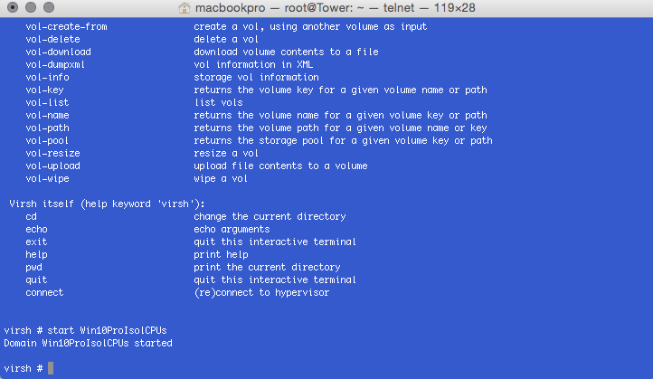

I went into terminal and Virsh to see if I could start the VM from there. It reported that the VM started and when I turned on my TV the VM was being passed through Audio and Video as well as USB controller and attached devices. See screen shots.
The VM tab is still showing errors and the dashboard is no longer showing my working Dockers or VM's
Diagnostics attached
