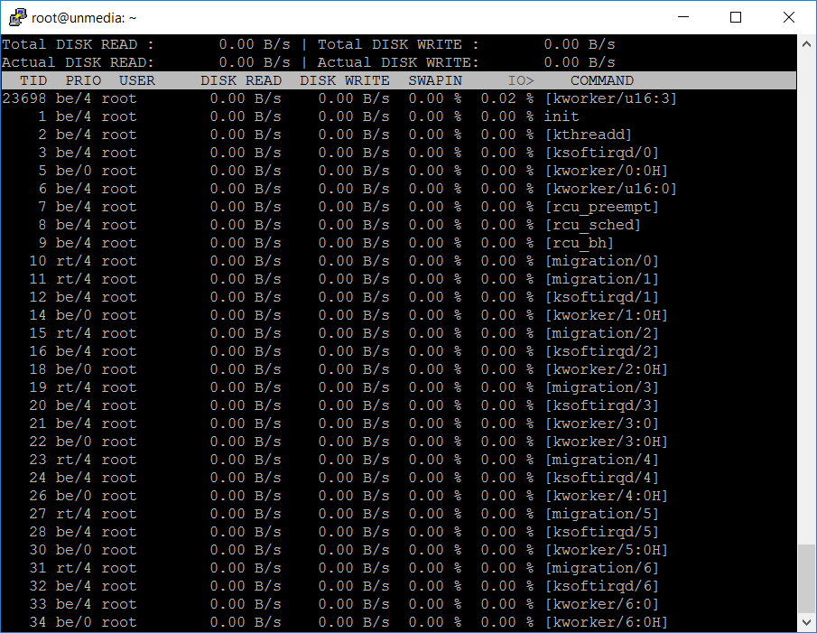

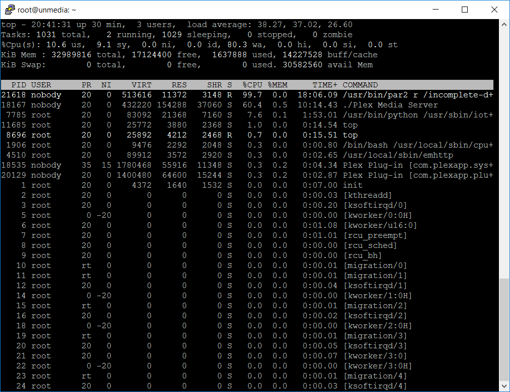

Did a little more testing related to the high load/unresponsive server tonight.  I re-enabled all the disabled dockers and queued up some downloads.  I now have a par2 repair stuck in the download queue that puts enough IO strain on the server to have it lock up within 10 minutes of booting.  I've rebooted 3 times to ensure that it will lock up consistently.
I then did something daring (or maybe stupid  :o ) to eliminate the possibility of it being the dual parity.  I unassigned both my parity drives and rebooted the server to see if it would lock up.  The good news is that it locked up with 10 minutes of booting, so I'm now assuming it does not have anything to do with the new/changed dual parity code (sorry for doubting you Tom!).  The bad news is I'm more stumped than ever as to what it could be.
Below is what top and iotop are reporting at roughly the same time.  The server is sitting in an unresponsive state right now, although my previously connected ssh sessions continue to update the top and iotop screens.  You'll notice that the top command shows high load and the wa figure indicates its waiting on IO of some sort.  But the iotop doesn't show any significant disk use.  In fact there is no disk use and if I leave it long enough the drives spin down as per their settings (seen in syslog and dmesg).
I'm not enough of a Linux guru to figure out where to look next, so if anyone has suggestions on what next steps could be, please pass them along.  Thanks!
top:
top - 20:53:21 up 42 min,  3 users,  load average: 38.53, 38.31, 32.92
Tasks: 1031 total,   2 running, 1029 sleeping,   0 stopped,   0 zombie
%Cpu(s): 10.7 us,  9.2 sy,  0.0 ni,  0.0 id, 80.2 wa,  0.0 hi,  0.0 si,  0.0 st
KiB Mem : 32989816 total, 17111804 free,  1649940 used, 14228072 buff/cache
KiB Swap:        0 total,        0 free,        0 used. 30570024 avail Mem
  PID USER      PR  NI    VIRT    RES    SHR S  %CPU %MEM     TIME+ COMMAND
21618 nobody    20   0  513616  11372   3148 R  99.7  0.0  29:55.60 /usr/bin/par2 r /incomplete-d+
18167 nobody    20   0  432220 162120  37060 S  60.2  0.5  17:19.48 ./Plex Media Server
7785 root      20   0   83092  21380   7160 S   6.9  0.1   2:42.74 /usr/bin/python /usr/sbin/iot+
8696 root      20   0   25892   4212   2468 R   1.0  0.0   0:22.84 top
  292 root      39  19       0      0      0 S   0.3  0.0   0:00.22 [khugepaged]
11685 root      20   0   25772   3880   2368 S   0.3  0.0   0:21.00 top
    1 root      20   0    4372   1640   1532 S   0.0  0.0   0:07.00 init
    2 root      20   0       0      0      0 S   0.0  0.0   0:00.03 [kthreadd]
    3 root      20   0       0      0      0 S   0.0  0.0   0:00.21 [ksoftirqd/0]
    5 root       0 -20       0      0      0 S   0.0  0.0   0:00.00 [kworker/0:0H]
    7 root      20   0       0      0      0 S   0.0  0.0   0:01.18 [rcu_preempt]
    8 root      20   0       0      0      0 S   0.0  0.0   0:00.00 [rcu_sched]
    9 root      20   0       0      0      0 S   0.0  0.0   0:00.00 [rcu_bh]
   10 root      rt   0       0      0      0 S   0.0  0.0   0:00.01 [migration/0]
   11 root      rt   0       0      0      0 S   0.0  0.0   0:00.01 [migration/1]
   12 root      20   0       0      0      0 S   0.0  0.0   0:00.08 [ksoftirqd/1]
   14 root       0 -20       0      0      0 S   0.0  0.0   0:00.00 [kworker/1:0H]
   15 root      rt   0       0      0      0 S   0.0  0.0   0:00.01 [migration/2]
   16 root      20   0       0      0      0 S   0.0  0.0   0:00.02 [ksoftirqd/2]
   18 root       0 -20       0      0      0 S   0.0  0.0   0:00.00 [kworker/2:0H]
   19 root      rt   0       0      0      0 S   0.0  0.0   0:00.01 [migration/3]
   20 root      20   0       0      0      0 S   0.0  0.0   0:00.07 [ksoftirqd/3]
   21 root      20   0       0      0      0 S   0.0  0.0   0:00.09 [kworker/3:0]
   22 root       0 -20       0      0      0 S   0.0  0.0   0:00.00 [kworker/3:0H]
   23 root      rt   0       0      0      0 S   0.0  0.0   0:00.01 [migration/4]
   24 root      20   0       0      0      0 S   0.0  0.0   0:00.06 [ksoftirqd/4]
   26 root       0 -20       0      0      0 S   0.0  0.0   0:00.00 [kworker/4:0H]
   27 root      rt   0       0      0      0 S   0.0  0.0   0:00.01 [migration/5]
   28 root      20   0       0      0      0 S   0.0  0.0   0:00.02 [ksoftirqd/5]
   30 root       0 -20       0      0      0 S   0.0  0.0   0:00.00 [kworker/5:0H]
iotop:
Total DISK READ :       0.00 B/s | Total DISK WRITE :       0.00 B/s
Actual DISK READ:       0.00 B/s | Actual DISK WRITE:       0.00 B/s
  TID  PRIO  USER     DISK READ  DISK WRITE  SWAPIN     IO>    COMMAND
4945 be/4 root        0.00 B/s    0.00 B/s  0.00 %  0.03 % [kworker/u16:12]
    1 be/4 root        0.00 B/s    0.00 B/s  0.00 %  0.00 % init
    2 be/4 root        0.00 B/s    0.00 B/s  0.00 %  0.00 % [kthreadd]
    3 be/4 root        0.00 B/s    0.00 B/s  0.00 %  0.00 % [ksoftirqd/0]
    5 be/0 root        0.00 B/s    0.00 B/s  0.00 %  0.00 % [kworker/0:0H]
    7 be/4 root        0.00 B/s    0.00 B/s  0.00 %  0.00 % [rcu_preempt]
    8 be/4 root        0.00 B/s    0.00 B/s  0.00 %  0.00 % [rcu_sched]
    9 be/4 root        0.00 B/s    0.00 B/s  0.00 %  0.00 % [rcu_bh]
   10 rt/4 root        0.00 B/s    0.00 B/s  0.00 %  0.00 % [migration/0]
   11 rt/4 root        0.00 B/s    0.00 B/s  0.00 %  0.00 % [migration/1]
   12 be/4 root        0.00 B/s    0.00 B/s  0.00 %  0.00 % [ksoftirqd/1]
   14 be/0 root        0.00 B/s    0.00 B/s  0.00 %  0.00 % [kworker/1:0H]
   15 rt/4 root        0.00 B/s    0.00 B/s  0.00 %  0.00 % [migration/2]
   16 be/4 root        0.00 B/s    0.00 B/s  0.00 %  0.00 % [ksoftirqd/2]
   18 be/0 root        0.00 B/s    0.00 B/s  0.00 %  0.00 % [kworker/2:0H]
   19 rt/4 root        0.00 B/s    0.00 B/s  0.00 %  0.00 % [migration/3]
   20 be/4 root        0.00 B/s    0.00 B/s  0.00 %  0.00 % [ksoftirqd/3]
   21 be/4 root        0.00 B/s    0.00 B/s  0.00 %  0.00 % [kworker/3:0]
   22 be/0 root        0.00 B/s    0.00 B/s  0.00 %  0.00 % [kworker/3:0H]
   23 rt/4 root        0.00 B/s    0.00 B/s  0.00 %  0.00 % [migration/4]
   24 be/4 root        0.00 B/s    0.00 B/s  0.00 %  0.00 % [ksoftirqd/4]
   26 be/0 root        0.00 B/s    0.00 B/s  0.00 %  0.00 % [kworker/4:0H]
   27 rt/4 root        0.00 B/s    0.00 B/s  0.00 %  0.00 % [migration/5]
   28 be/4 root        0.00 B/s    0.00 B/s  0.00 %  0.00 % [ksoftirqd/5]
   30 be/0 root        0.00 B/s    0.00 B/s  0.00 %  0.00 % [kworker/5:0H]
   31 rt/4 root        0.00 B/s    0.00 B/s  0.00 %  0.00 % [migration/6]
   32 be/4 root        0.00 B/s    0.00 B/s  0.00 %  0.00 % [ksoftirqd/6]
   33 be/4 root        0.00 B/s    0.00 B/s  0.00 %  0.00 % [kworker/6:0]
   34 be/0 root        0.00 B/s    0.00 B/s  0.00 %  0.00 % [kworker/6:0H]
   35 rt/4 root        0.00 B/s    0.00 B/s  0.00 %  0.00 % [migration/7]
dmesg | tail -n 50:
...[snipped]...

I'm in no way an expert here, but what's curious is that the internal bridge is set up, then disabled.  That would leave anything using it hanging.  That may not be important though, as nothing has had time to begin using it.
Some possible steps to alter what's happening, try removing dnsmasq from the equation (don't know if you can).  And try disabling avahi, just to see if anything changes.  And perhaps try it without the internal bridging.
Thanks for the feedback.  I've been waiting for my parity to rebuild since last night before trying any of your suggested changes.  However, while the parity was rebuilding I did slowly start enabling dockers and monitored their effect on the load of the system.  I went in thinking Plex would be a huge load on the system, but in the end I was able to load all dockers except Sabnzbd.  Once the parity rebuilt, I enabled Sabnzbd and the load went through the roof and the web ui stopped responding.  Sniffing around while that happened, I noticed that for some reason I was unable to read (ls) the Incomplete folder (on disk 7, not user share) that Sabnzbd was also trying to read from when it hung.  After a reboot I started a btrfs scrub on the drive in question to make sure it wasn't an FS error that was causing Sabnzbd to lock up, which would in turn took out the web ui.
So while the jury is still out until the scrub is finished (i'm 1TB into a 3 TB drive), it seems that if I don't run the Sabnzbd docker then all is well.  My server was stable enough to rebuild dual 4TB parity drives in about 15 hours without Sabnzbd running.
Interestingly, as a test I've created an Ubuntu JEOS 14.04 VM and installed Sabnzdbd there.  It has been happily running stable for the last hour or so, even with the host server load staying above 15 on the system.  So it's almost as though Docker is choking when Sabnzbd would have a lot to process, but KVM keeps chugging along.  I would have the thought with less overhead in Docker it would perform better.
So, again thanks for the suggestions, but I'm reluctant to try them at the moment as things are somewhat stable, with everything at least working.  I still need figure my way through the various combinations of technologies, but in the end it is amazing what this one box is doing.  It's:
