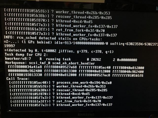

After upgrading from 6.1.9 it will not boot properly, keeps saying that it's looking for /dev/disk/by-label/UNRAID. Double checked and label is fine, so I assume that new version does not like my USB key, which is: Bus 002 Device 002: ID 0781:5567 SanDisk Corp. Cruzer Blade
Installed 6.1.9 back, restored config, booted immediately.
I saw a post yesterday where someone had problems similar and it was because, although the key was called UNRAID it had been entered using an OS that did not use English as it's language.
Is there a chance that this also applies to you?
No, using English. Also tried beta21 with clean install (no previous config or any modification) and same happened.
I'd try another USB key with a fresh install and just see if it boots.  It makes me wonder if it's a problem with your USB key...
That should be the way, but not going to buy a new usb key just for testing :D since 6.1.9 stable works fine
Still, included the usb identifier, maybe some dev will add an exception for it ^^

Just scans for LABEL=UNRAID and then fails to find it somehow
Bus 003 Device 003: ID 0781:5571 SanDisk Corp. Cruzer Fit

I had the same issues on every beta I've tried for 6.2 :P
I'm now steering clear of the betas for a while haha ;)
Could you try another Flash Drive and see if you have the same problem?  Just to see if it boots.  With two of you having virtually the same problem, I can't believe it is cockpit error!
For those having problems with the flash drive, I had the same issue with one of my servers, booted fine with v6.1 and not with v6.2, reformatting flash dive didn't help, but this did if you have a Windows pc.
Backup your flash drive then open a command prompt window as administrator, then type, in this order:
-diskpart
-list disk
-select disk x (x=your flash drive)
-clean
-create partition primary
-format fs=fat32 label=UNRAID quick
-active
-assign
-exit
-close cmd window
-copy unraid files
-execute make_bootable as admin
It should work now.
The issue is the cruzer fit.  I have the same thing.
Here's how to manually test it.
When it scans for the UNRAID label, remove/reinstall the USB key.  You'll see it picked up right away and it'll boot normally.
That's obviously not a longer term solution, but it will allow you to boot manually.
