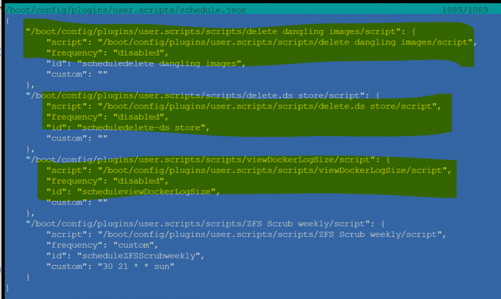

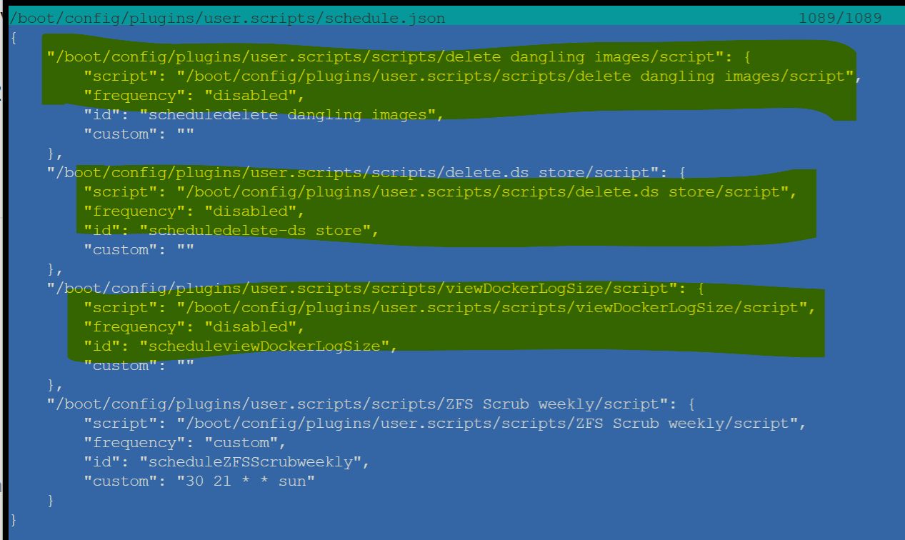

Hi @Squid
I just found out something weired and maybe of interest regarding the behaviour of the "User-Script" plugin.
If I just regularly delete a script in the GUI, the script itself is being deleted in /boot/config/plugins/user.scripts but within the schedule.json file the scripts definitions from the deleted scripts are still there.
(see picture in spoiler: the marked ones have been deleted before)
Spoiler
In fact, as long as the script-file itself does not exist any longer, it would not be a problem.
But 1.) every time this schedule.json file is loaded by the plugin, it loads old, already unnecessary stuff.
And 2.), going one step further, imagine what could happen if you create a script with the same name or the same file-name or if you create a script manually and put it into this directory with the same file name?
Of course, all this may be a problem just in rare circumstances but in my opinion the file and config handling of plugins in such important systems like a NAS should be as correct as possible to prevent from unintended errors as good as possible.
At this point, nevertheless, a *BIG* thank you for this plugin. It helps a lot!
Regards DaKarli. 🤗
Yes that's correct.  It was a design consideration to make everything a ton easier and also handle if the user manually deleted the scripts.  The script execution engine checks for the existence of the script before executing to handle this.
Then it should show up on the list with the same settings as the one previously deleted.
Ok, so if the script exec engine checks this before, like I said, it may be no problem.
So it would be no problem either to manually delete old entries from the .json file if someone wants to go this extra step.
Regarding your 2nd point, I just want to add that the risk is somewhere else. If you add a different script but with the same name, you may not be aware that this new script will be executed by the old line in the .json file right after you saved that file.
But just as I already said, these may be rare circumstances and I just wanted point to possible risks with the handling being like it is.
Cheers ! 😉

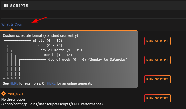

There's a typo  on the link to "What is Cron" on the /Settings/Userscripts page.
It goes to corntab.com instead of crontab.com
Did you try the link?
corntab.com is the place I always go.
crontab.com domain is for sale.
Doesn't seem to be working for me at the moment though.
Huh, I'm sure I tried it last night but it was pretty late! My bad🤦
