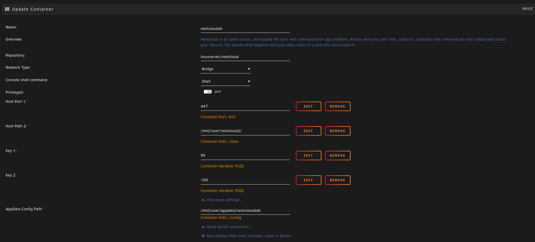

9 hours ago, Aspect said:
@saarg Unfortunately fresh install is having same issue (screen shots of new install)
ill do my best this time to provide the information you need to assist.
30908583_Screenshotfrom2021-04-2420-39-48.thumb.png.2a748efe47a32e269719741f49a968f8.png753960693_Screenshotfrom2021-04-2420-40-12.thumb.png.5d37a23dfc2ef621a1fcdd245be938fa.png
I have no idea what is wrong in your setup, but it is something local to you as it works here on a fresh setup and my existing install.

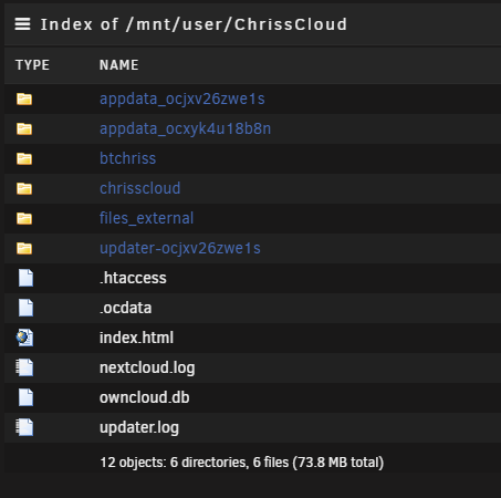

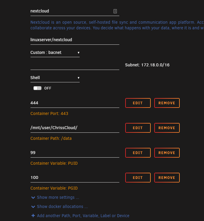

6 hours ago, saarg said:
Do you use the IP to connect to nextcloud or reverse proxy limited to Lan only?
i only use the ip, my unraid server 192.168.1.45 and port 444

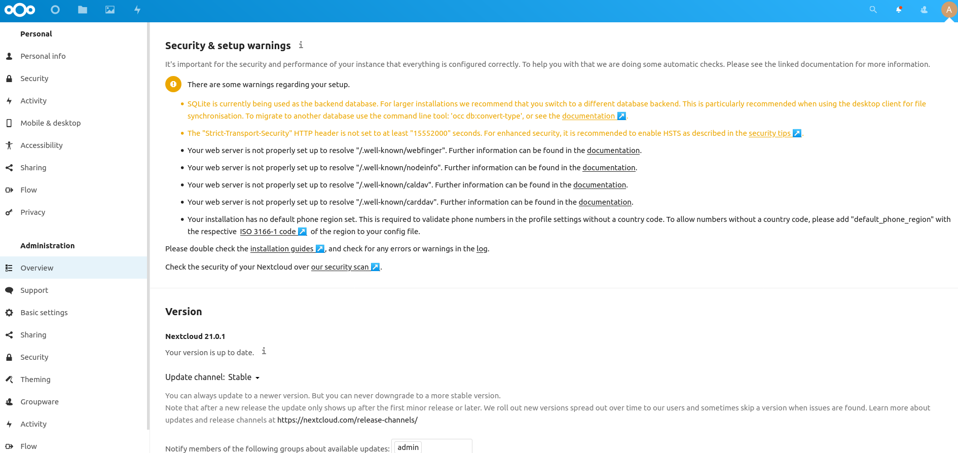

23 minutes ago, skois said:
Seems like it completed successfully  ;)

I've created a share for my nextcloud data.  I've created a few users but I don't see a folder created with their user name and I don't know where their files are going.
Also, can I add an existing share to be able to upload files to a certain folder?
You have to be more specific.
* You created a share in Unraid and mounted it into the Nextcloud docker as /data?
* You created a share IN the nextcloud? If so, with what users did you shared it? Can this users see the share?
* Also i'm not sure what you mean with your last question, because it can also imply both of the above points.
Yes, I created a share in Unraid, named the share Nextcloud and mounted that as the /data.
I didn't create a share in Nextcloud.  I thought creating the users would create user folders within the Unraid share to see their files.  I have uploaded photos from a users account but I cannot see those photo in Unraid.
As for the last question, I also have a share in Unraid called Photos.  I wanted users to have access to this folder as well to upload photos to this specific folder.
Post your nextcloud config ( click on docker > edit) (with the advanced option turned on, top right corner button)
And also the share you created on unraid

The users I created aren't in the Unraid share Chrisscloud.  There should be three, brad.chriss, tammy.chriss, peggy.chriss
The admin user I created (ChrissCloud) is there, and another user btchriss, which has been deleted is still there
