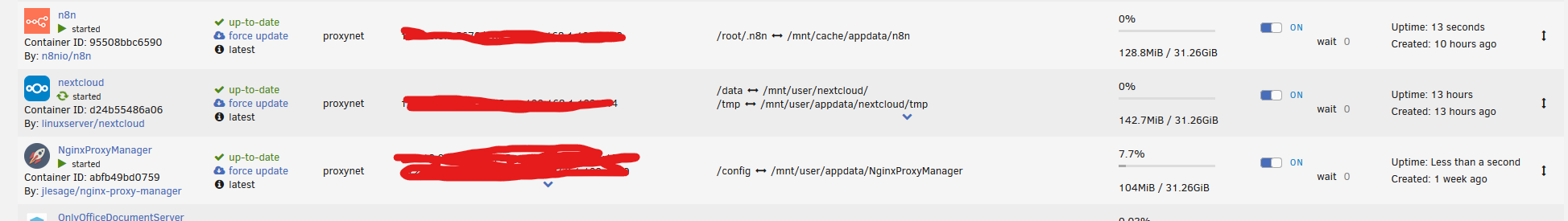

Hey thanks for getting back so quick. So i tried this but it didnt work. I copied and pasted that into ngnix proxy manager and then went to the advanced tab and pasted it there but still no luck
I think in nginx proxy manager, on the advan Ed tab you need to wrap everything in
Location /{ everything here }
Sent from my Mi 10 Pro using Tapatalk

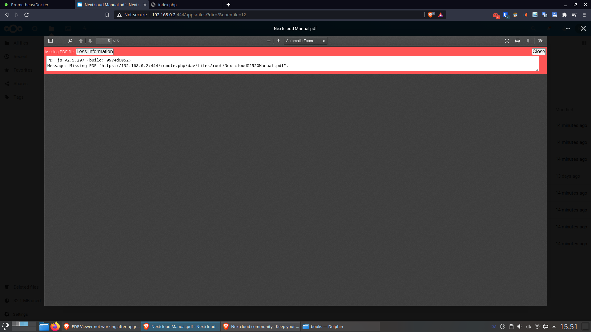

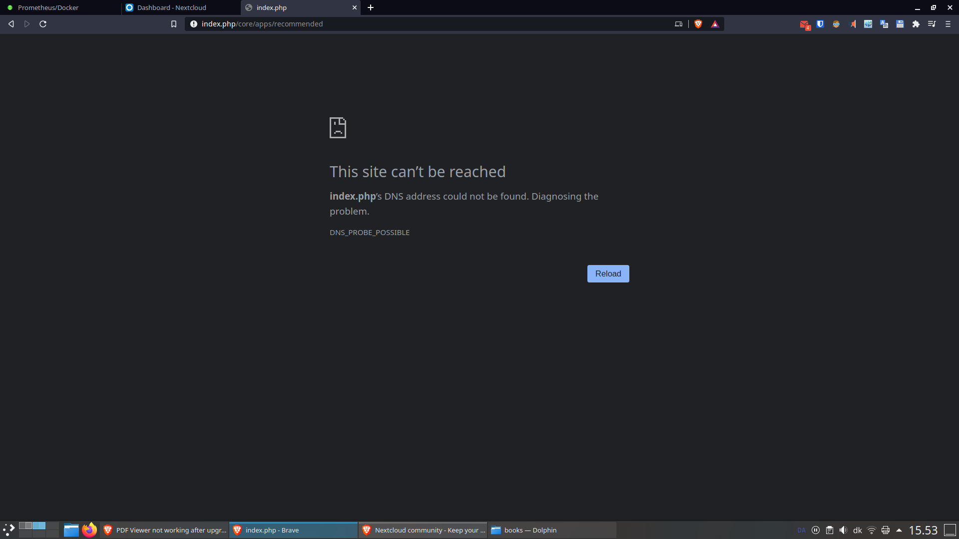

Hello I am just starting using nextcloud and if there is any more information I should provide let me know.
I have been trying to setup nextcloud on UNRAID with a mariadb dabase and it was working fine with 21.0.1 but when I upgraded to 21.0.2 or even did a complete clean install there was some problems with the demo PDFs. I can include my own and they seem to work but I just don’t understand what to make of it.
Also when installing(fresh or upgrade) 21.0.2 I get an error on page below
https://index.php/core/apps/recommended
and it does not redirect me to the dashboard as it did in 21.0.1 when installing. Nextcloud seems to work but just have to manually navigate to it.
I have attached a picture of the error on the index page after install and how it displays the demo-PDFs.
Any input is very welcome and if you know some material that might be useful please let me know.
EDIT.
It seems to be an error with the current version(21.0.2)
- https://github.com/nextcloud/files_pdfviewer/issues/381
