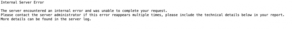

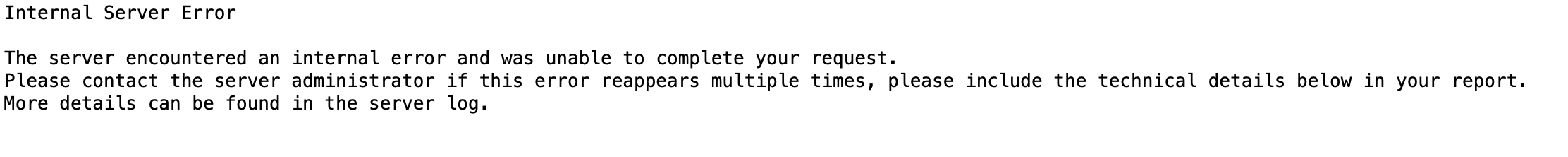

On 6/23/2021 at 12:56 AM, GitBoxer said:
I have, for months, been trying to upgrade from NC20 to NC21.  Whenever I give it another go, I always get stumped here:
This is what I see in the WebUI after I restart NC:
Something about OC_App.php.  I've looked everywhere for a solution to no avail.  Anybody have a solution?  Thanks in advanced!!
I put a post up on page 195.  Try that.

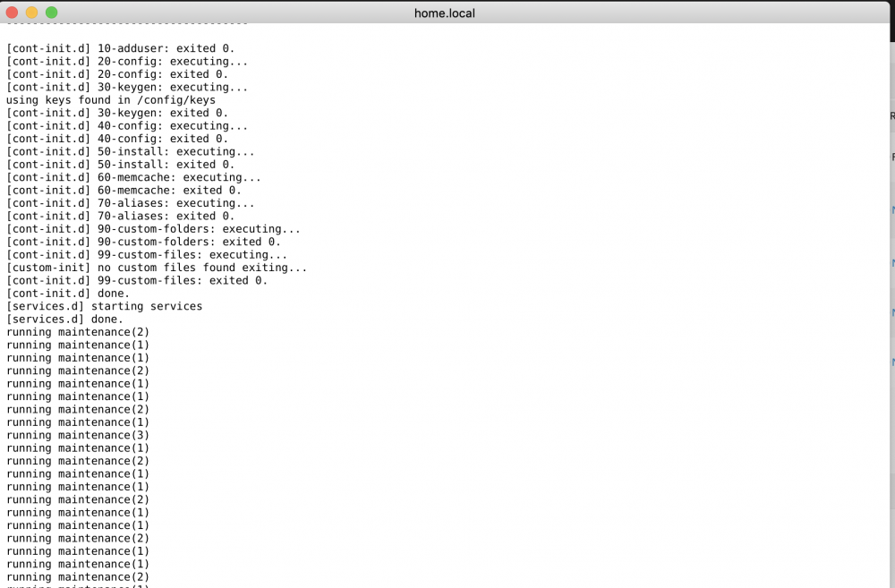

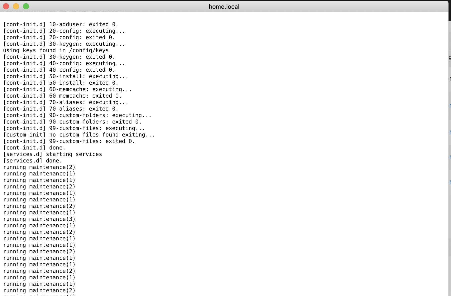

Dear all,
I am having issue of maintenance in log of nextcloud docker. this happen when I restarted the server.
this is blocking the GUI and I cannot access next cloud login page. the screen shot is attached.
any help is much appreciated!
Kind regards,
Link to comment
there is prolly a reason why its in maintenance mode, you can try edit the config.php
located at \\yourserver\appdata\nextcloud\www\nextcloud\config
  'maintenance' => false,
but may rethink what you done so it is currently in maintenance ...
