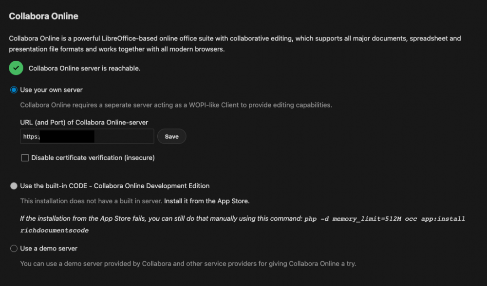

Collabora released new version 6.4.10.9, 3 days ago. that might do it for you

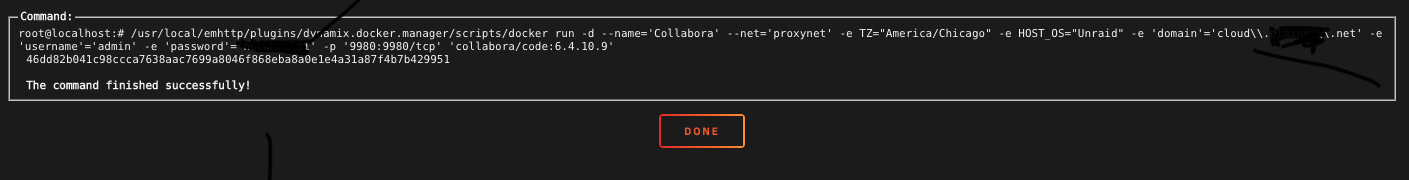

So, still no dice upgrading to 6.4.10.3. I downgrade to 6.4.9.3 and it immediately works fine.
Collabora must have changed something specific that inadvertently affects the functionality of mine in which the current way it is configured. Any idea where I can find change logs that would potentially elude me to what may have changed on their end?

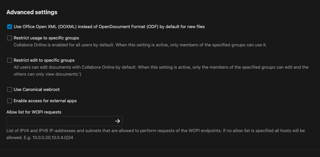

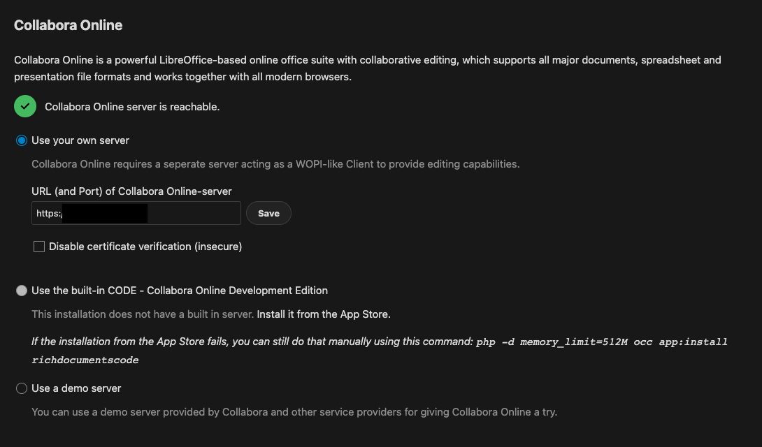

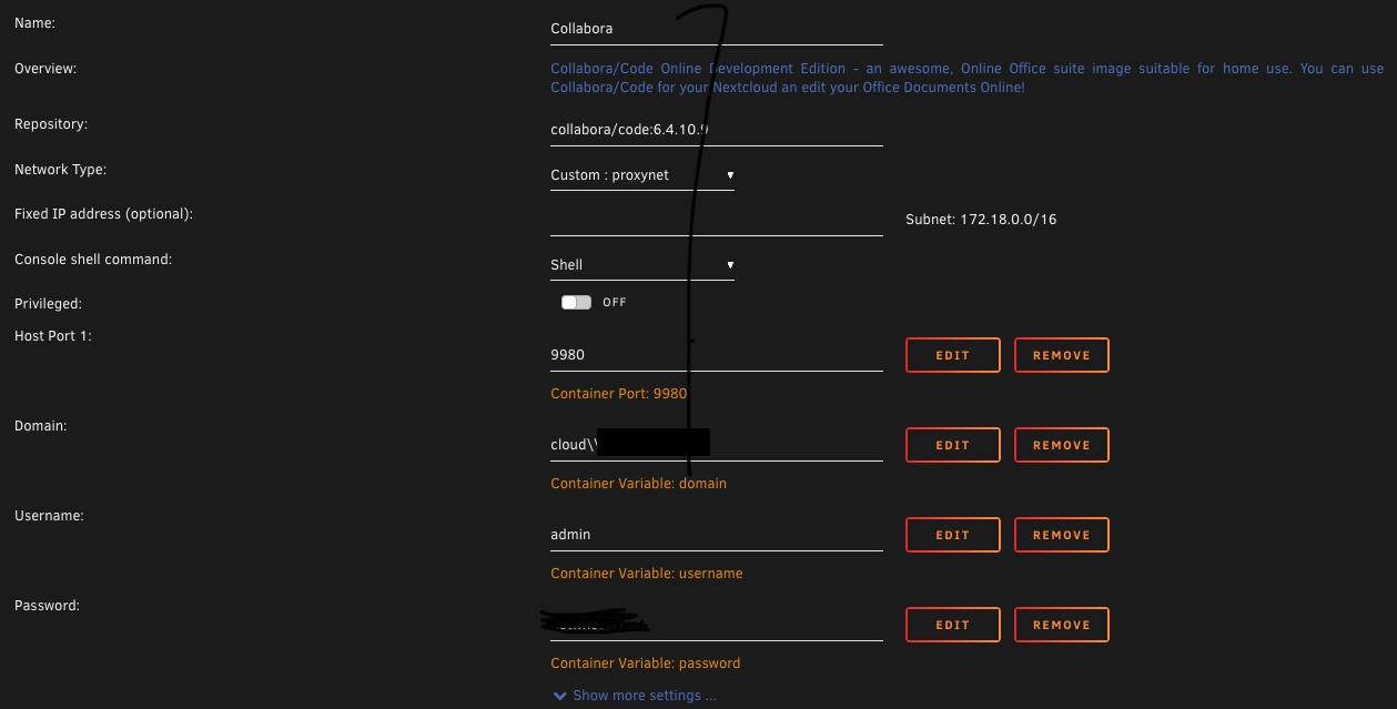

Taking a quick gander do you see anything totally Awry on my part?
(Been SO long since I set it up; it's just always worked but I think initially some years ago I had used SI1's config tutorial)

Could issues be related to newest version of Collabora AND the newest plugin app thing you have to install in Nextcloud to use Collabora as a WOPI or whatever? NC V 21.0.3 if it matters?
First, try 6.4.10.9 (not .3) ;)
Second on your collabora docker template, try changing from cloud\\.domain\\.com to cloud\.domain\.com (single backslash), I think this was a change introduced in 6.4.9.* but was still backwards compatible.

First, try 6.4.10.9 (not .3) [emoji6]
Will report back. Yes did do .9 I fat fingered what I typed. .9 should show in pic I think.
None the less yes maybe the 1 slash thing is it.
Thanks so much; will report back soon

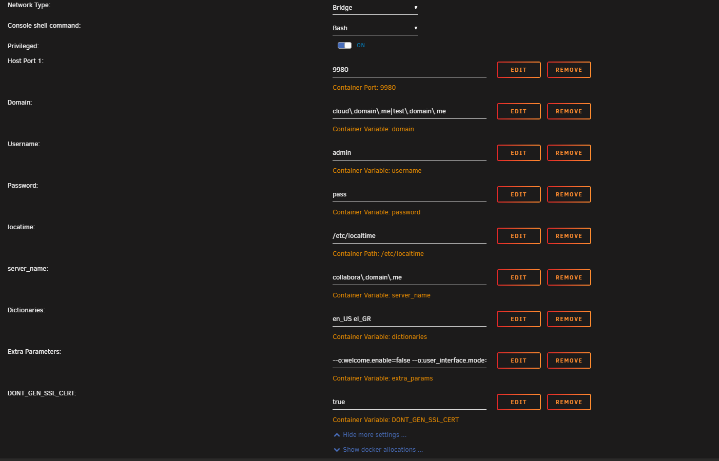

Skois, still no dice. Ugh. No idea what’s wrong. Maybe I need to wipe container and start over. Ugh I dunno [emoji30]

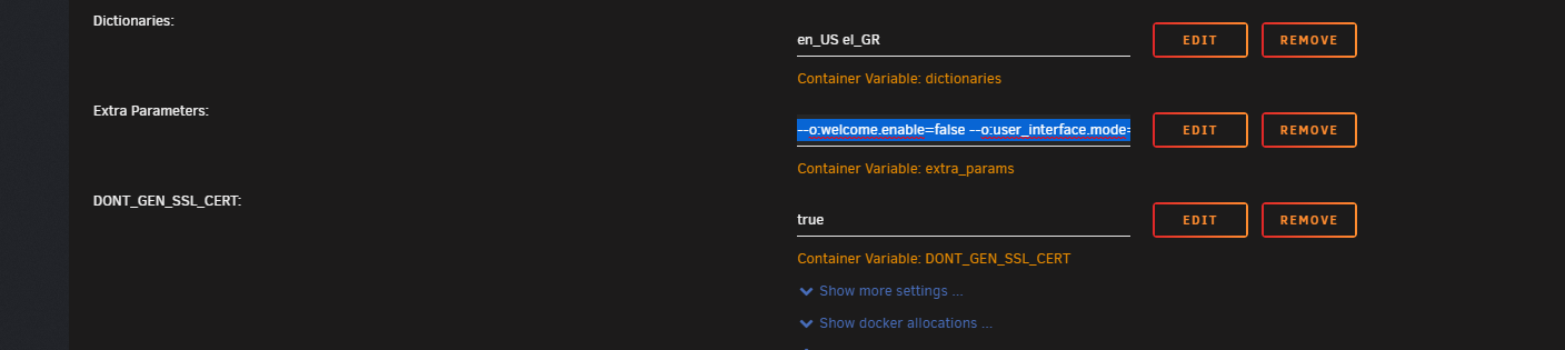

10 minutes ago, blaine07 said:
Skois, still no dice. Ugh. No idea what’s wrong. Maybe I need to wipe container and start over. Ugh I dunno emoji30.png
Try adding those in the photoimage.thumb.png.bf6f4b5ab363c1ff34084310963fe08a.png
`extra_params`   variable have the following `--o:welcome.enable=false --o:user_interface.mode=notebookbar --o:ssl.enable=false --o:ssl.termination=true`
I also have a variable `server_name` which have `collabora\.mydomain\.com`
