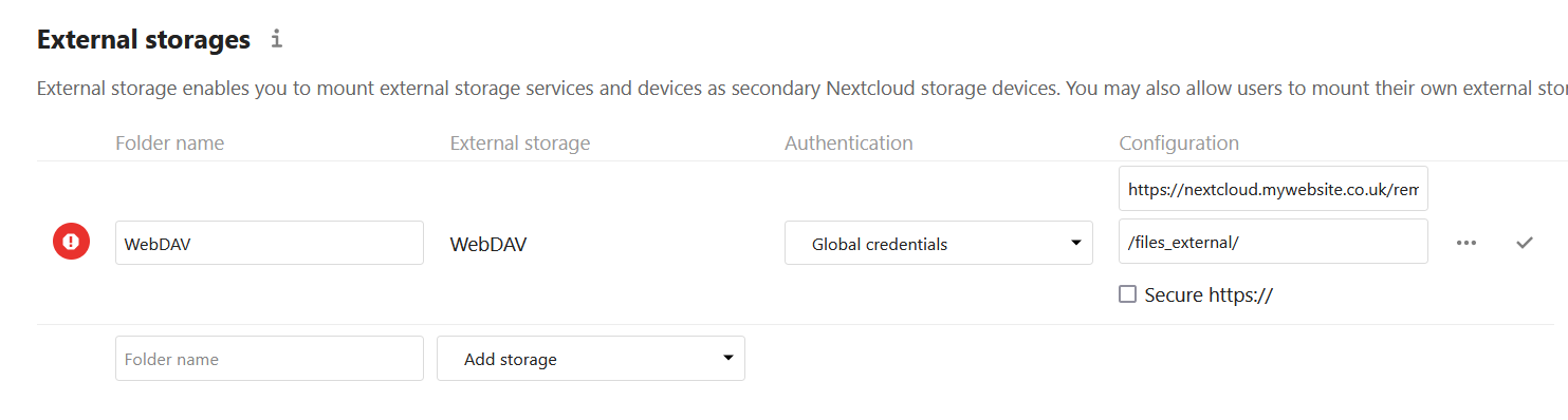

17 hours ago, Trozmagon said:
Hey Guys, I’m looking for a solution to what I assume is a strange use case and I can’t quite think of a search term to explain it easily so here I am with the long winded version so see if anyway can put me on the right path.
I’ve just setup next cloud and have my admin user setup, NextCloud will only ever be used with this with this single account. What I want to do is have only 2 folders, both of which are shares live in a dedicated pool called cloud.
I want these folders to be both accessible via SMB and via NextCloud so I have my folders mapped as such
  • /config > /mnt/cache/appdata/nextcloud
  • /data > /mnt/cache/appdata/nextcloud/data
  • /data/singleuser/files > /mnt/cloud
This is working great except I want the ability to modify files both from NextCloud and on the FileSystem but NextCloud doesn’t see the files if they’re moved into the folder via SMB because they’re not being synced, does anyone know of a way to have files automatically sync into NextCloud if they’re dumped into the users file folder?
I’m not against running another Docker App to handle the syncing but I would assume syncing the files at they’re current location would cause some issues.
Anyone have any ideas on how to achieve this?
Thanks in advance.
You best bet would be mounting the share are external storage (check appstore).
* Delete the /data/singleuser/files > /mnt/cloud bind.
* Mount the `/mnt/cloud` share as external storage in nextcloud with the external storage app.
* Just remember  it will show as a folder in your root folder in nextcloud. So you need to add/edit/remove files only inside this folder.
 All other files in the root dir of nextcloud user profile will be stored in /data > /mnt/cache/appdata/nextcloud/data
Also, you might notice some performance loss, and you need a bit of extra config for some apps to not ignore this folder. (e.g. Preview Generator)
Link to comment
Mate this is almost perfect, thanks!
It is a little slow to notify clients that there's something to sync so I'm hoping there's some tweaks I can make here to speed it up.
Thanks Mate :).

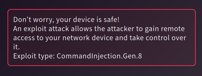

On 9/2/2021 at 11:48 PM, thomas said:
@linuxserver.io
Lately I have some CVE attacks on my Unraid due to Nextcloud container using nginx v1.18.0. The attacks are being blocked by Netgear Armor (Bitdefender) and I only receive a notification that it was blocked and it says there is a vulnerability due to nginx v1.18.0.
Is there a way to update nginx to a newer/secure version?
Thanks
Our nextcloud container use version 1.20.1 of nginx, so update your container. If its updated, it's not our nextcloud container that is the issue.
Edited by saarg
  • Like 1
Link to comment

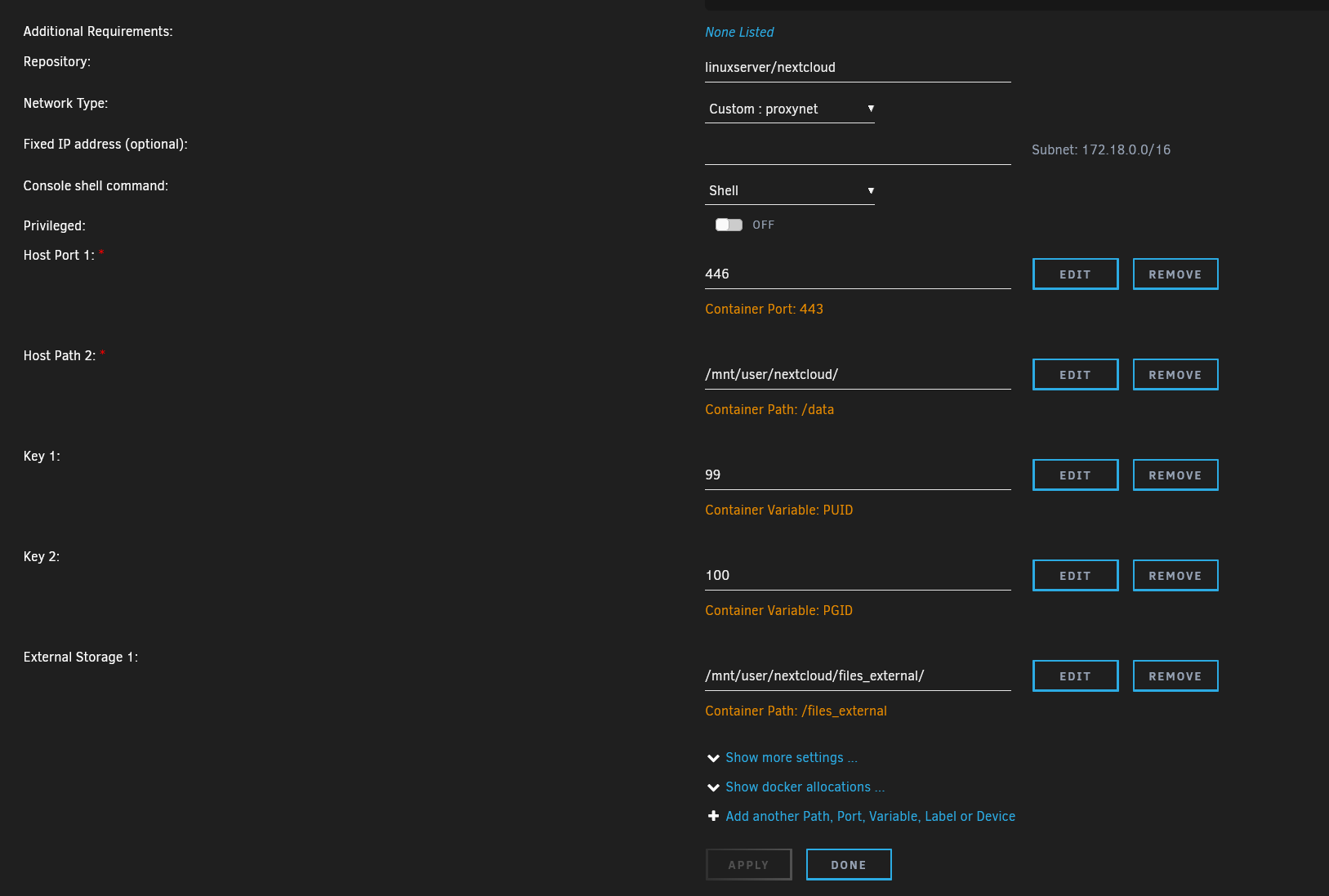

Help please :/
Im trying to create an external strorage mount for paperless-ng using the app in nextcloud
1. I have installed the external storage app in nextcloud
2.  I am trying to make a storage path in the docker template but the docker wont start when I add this field
Obviosuly im doing something wrong, even read the help pages and im still stuck, Id appreciate your help.
