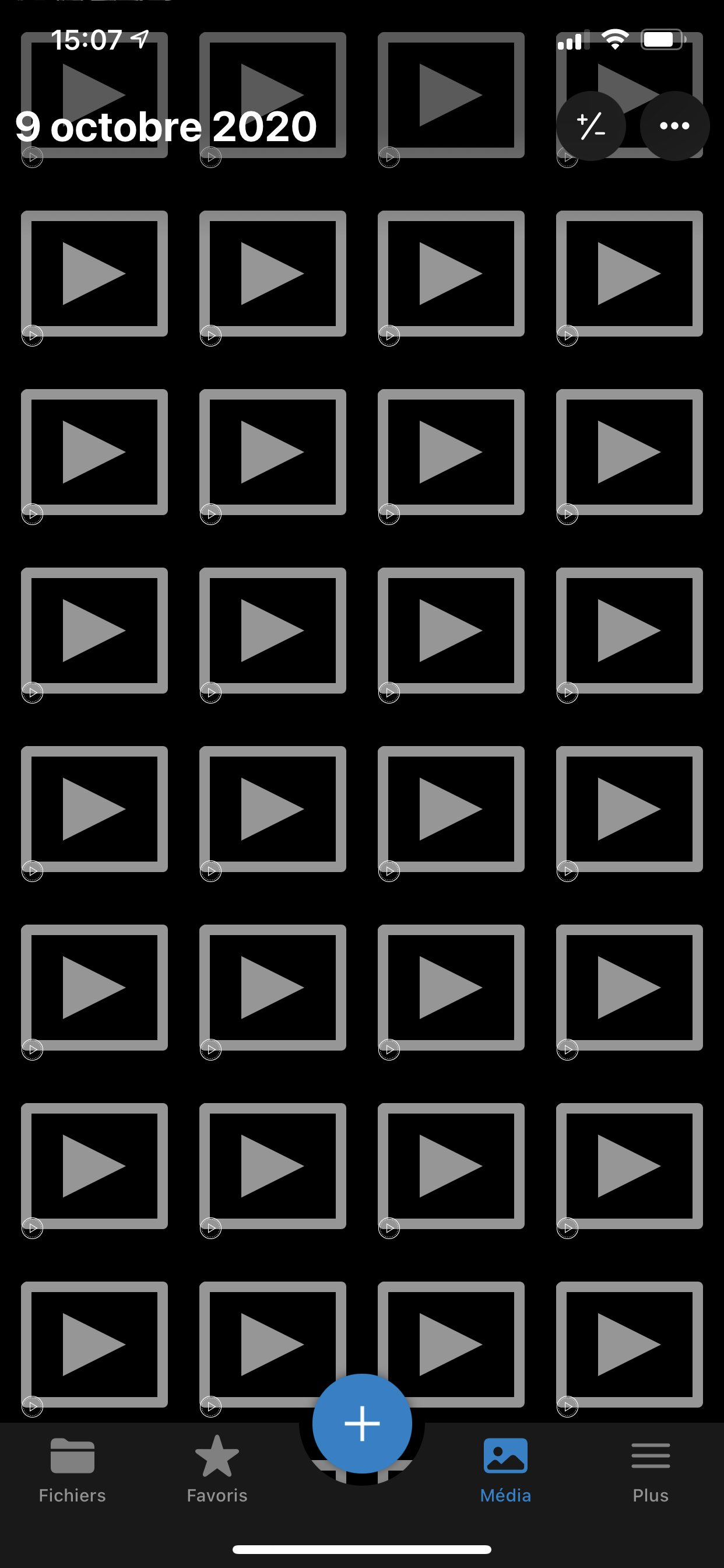

On 11/29/2020 at 9:08 AM, thymon said:
Hi all :)
How pre-generate Thumbnail video ?
It works correctly on web browser but not on iOS app.
I must open video file to generate thumbnail for iPhone...
Did you figure out how to do this?
There are a few posts in this thread asking how to generate thumbnails for video files, but nobody ever gets an answer :S
From what I gathered, one needs to install ffmpeg. Does anyone know how to do this and make it interact with NC?
If you can see the thumbnails in the web, there is 2 reasons you don't see them in the iOS app.
1) Server doesn't have the right size thumbnail for the app
2) Its a bug and it should be reported on https://github.com/nextcloud/ios

I actually cannot see any video thumbnails, either on the web interface or in iOS.
I quoted the other post since it looks to be related to my problem in some way.
Nextcloud official documentation clearly seems to indicate that in order to generate video previews/thumbnails, you need to install ffmpeg and configure your config.php file with the following lines :
'enable_previews' => true,
'enabledPreviewProviders' => [
        'OC\Preview\Movie',
        'OC\Preview\MP4',
The problem is that I don't know how to integrate ffmpeg.
There is a ffmpeg docker available for unRAID (FFmpeg mkvdts2ac3), but how to make it interact with Nextcloud, that I do not know.
I also found some other online resources, but I don't know how to use code lines like "apt install ffmpeg" on unRAID (or in general for that matter)!
Edited by gustomucho

After tinkering with this for a while, it seems the solution is much simpler than I thought.
For some reason, the only step required is to modify the config.php file.
No need to install ffmpeg or even to enable the app "Preview Generator" inside Nextcloud.
I'll leave what I did here if it can help anyone looking to generate thumbnails for video files :
1. Go to your config.php file located at /mnt/user/appdata/nextcloud/www/nextcloud/config/config.php
2. Just before the end of your config file, add the following lines (after the 'installed' => true,) :
 array (
    0 => 'OC\\Preview\\TXT',
    1 => 'OC\\Preview\\Image',
    2 => 'OC\\Preview\\MP3',
    3 => 'OC\\Preview\\Movie',
    4 => 'OC\\Preview\\MP4',
You can also add other file types that you require (mkv, avi, etc.)
