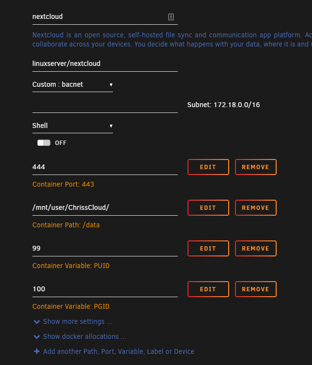

I started all over again.
I wiped and deleted the unraid share.  I deleted the DB. And I uninstalled the nextcloud container.
I created a new unraid share and db.  I downloaded the nextcloud container and pointed the /data to the unraid share.
I have it running and can upload files.  At least I can in nextcloud.  I can see them on a user's dashboard.  The unraid share doesn't have any files I've uploaded.
This is puzzling to me.  Where are the files being stored?  I have the unraid share set to use the cache.

image.png.a7f9fdd3bd76ca27c40aebc45008f975.pngWhat did you set this Data folder while installing?
It was already set to /data and in the container was set to my unraid share
A little late to the party, but you made two users with the same name, only difference was the difference in capital letters. If you look in the picture of your /data folder you can see that all user folders are in small letters, so that will be a problem.
As for the issue athat there are no folders in the share you chose for /data when installing it fresh, that sounds like you didn't set the path to /data when you went through the installer.
Do you see the folders if you check the directory inside the container?
Well I didn't have two users with the same username.  However I did figure out what happened during the second install.  At first the data folder was set to \data then an error occurred with the db connection.  After correcting that I hadn't noticed the data directory was changed to www\nextcloud\data or something like that....
Now after the three install,  it all works

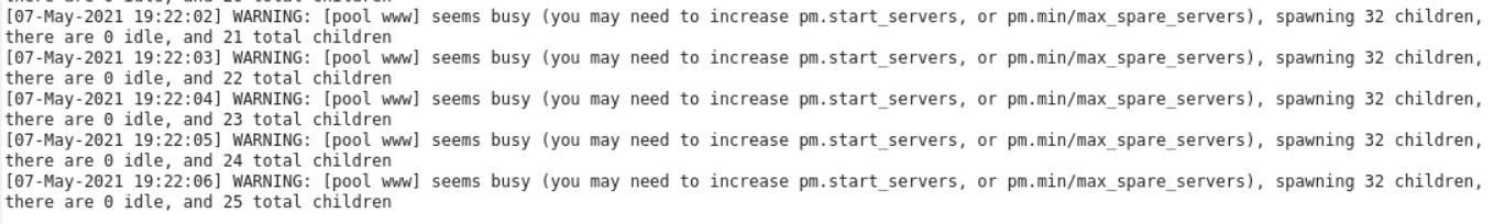

My php error file reports this error:
WARNING: [pool www] server reached pm.max_children setting (5), consider rasing it
Can that be the cause of the slowness I experience?
If so, how do I change it?
Try adding 'pm.max_children = 120' in the 'www2.conf' file. It is possible that this should go in the 'php-fpm.conf' file instead but i'm not sure.

Looks like i have the same problem:
I deleted the nextcloud.log (+5MB) file yesterday and my disks went idle. Today a new log file popped up in the data share. The info inside the log-file is about 'mail, smtp settings error'. I forgot to copy before i deleted the file...
Thanks, seem to have worked, now I am getting this error instead tho:
And the speed issues that started after updating to Nextcloud 21 is still there, aka slow switching between menus of nextcloud itself, like dashboard, files, or going to settings, is so much slower than before I updated to 21. (from 20)
I think it might be related to NC 21 pinging the CPU much harder for some reason?
EDIT: after some googeling and changing min max spare and start servers, the numbers are only getting larger??image.thumb.png.352db3217a4d3b64cea2f5bc7db6fbe7.png
And its only me that access the server and this is only happening when I access next cloud via web, does not happen if I do it via app.
EDIT: I think I found part of the slowness issue....
For some reason I tried to test in private browsing, there it was fast as it was in NC 20.
So I thought, thats weird, so I deleted cookies related to nextcloud and my site, and changed nothing.
Then I tried disabeling one and one browser plugin, and it got fixed.
You know what plugin caused it? Dark Reader. A plugin that is only supposed to make sites darker.
Why would it cause that, both the slowness and excess PHP children on my NC server? (yes, the errors is gone)
EDIT: the PHP error still happens but site is much faster.
Edited by Mihle
