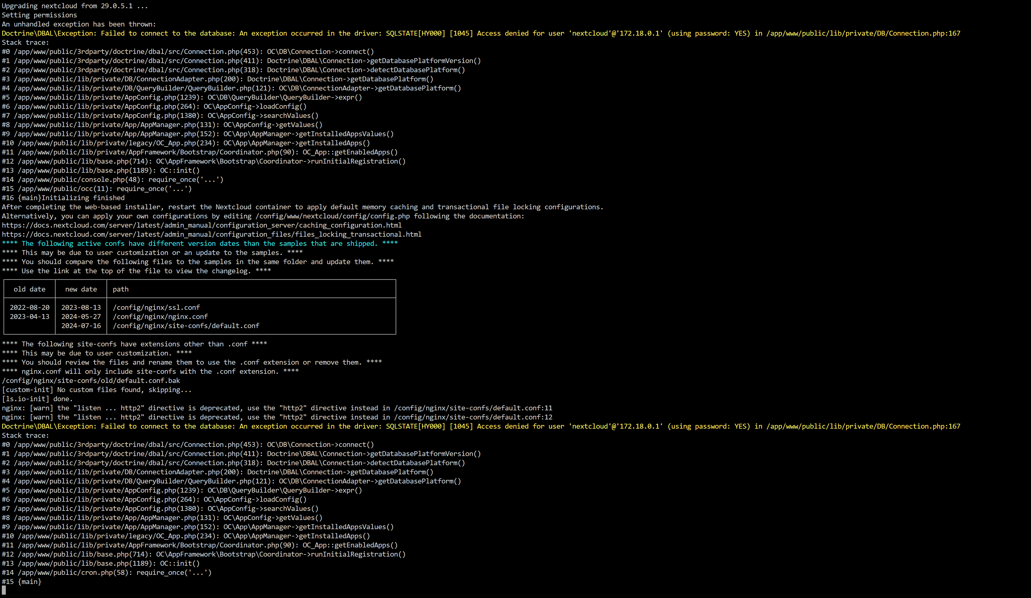

and my protocoll starting Nextcloud

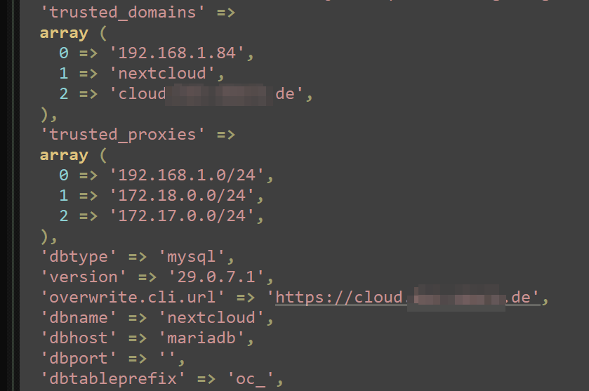

7 hours ago, alturismo said:
may try removing those 2 entries
  'overwritehost' => 'nextcloud.xxx.info',
  'overwriteprotocol' => 'https',
shouldnt be needed as over...url is given already, here from mine
Thank you! That helped so far, that I can access the browser login page now locally again....
I still can't access it from somewhere else...

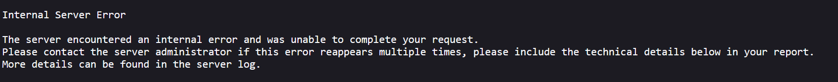

10 hours ago, Greygoose said:
my nexcloud just stopped working...  Ive searched and im a little lost, is it reddis causing it, im unsure how to locate the issue.
Does the NC docker run at all?
Is the Redis docker running?
The information out is only as good as what goes in. Ie. You'll need to elaborate.
Have you changed anything recently? Ie. Upgraded, changed config files, nginx or reverse proxy?
Edited by Geck0
