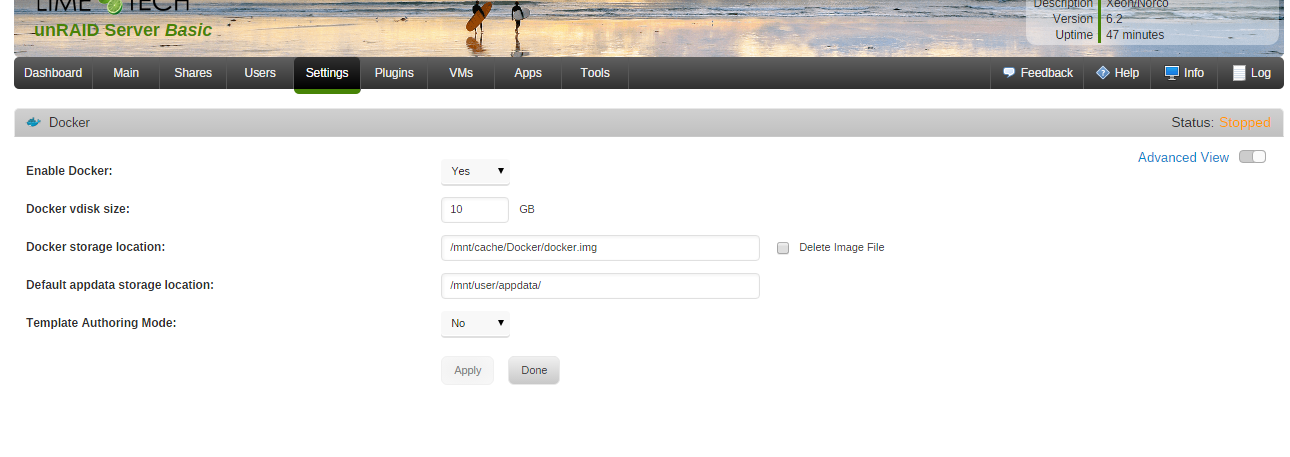

So I casually updated from 6.1.9 without reading anything first. All my installed dockers are missing(Plex, Plexpy, Deluge). In layman's terms(for my stupid ass that thought it would be cool to upgrade right before bed without reading anything)....how do I get these back?

Sep 15 23:18:29 Zeus emhttp: shcmd (522): set -o pipefail ; /usr/local/sbin/mount_image '/mnt/cache/Docker/docker.img' /var/lib/docker 10 |& logger
Sep 15 23:18:29 Zeus root: /mnt/cache/Docker/docker.img is in-use, cannot mount
Sep 15 23:18:29 Zeus emhttp: err: shcmd: shcmd (522): exit status: 1

You'll have to post diagnostics.  Without the specifics on how 6.1.9 was setup its kinda hard to say.
But, quick and easy answer will be to manually delete your docker.img file wherever its stored, recreate it in the the default system share (not explicitly required to be in that share, but its nice and easy) and then re-add your apps back via CA's Previous Apps section.  After the downloads are complete, everything will be back to normal.  You won't even need to adjust the templates.  They'll be filled out the same as before

It's been a while since I did this, but I think I created the docker.img on my cache drive. I can't even remember how I set this up...sucks having to relearn this all over again. So just use CA to install right over the same paths? Will I lose all my Deluge and Plex settings?
You won't lose a thing if you go to CA's Previous Apps section and install it from there.  The templates will be the exact same as what you were running under 6.1
