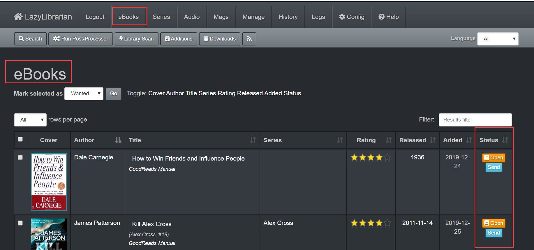

1 minute ago, beaverly72 said:
Yeah, when you go to the eBooks tab, if the book has been downloaded you should have a button on the far right-hand column labeled Send.
I must be using a totally outdated version of LL. Can you post a screenshot? I don't have an eBooks tab.
Here it is...
Here it is..
Well then. My install must be totally borked, it looks nothing like that.
Sorry, I can't really help much if I can't recreate the issue.

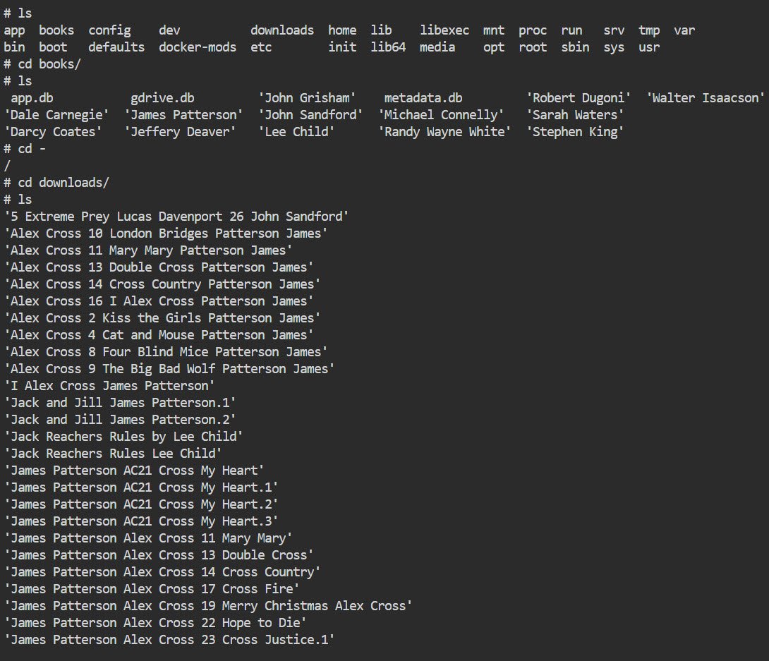

On 12/25/2019 at 8:13 AM, jonathanm said:
Without further documentation, best guess is that your container paths don't match. If you have /downloads -> /mnt/user/downloads in one docker and /data -> /mnt/user/downloads in the other docker, the files won't be found, because /downloads and /data are different, even though they point to the same destination on the host.
7 hours ago, Squid said:
I attached a screen capture to one of the previous posts, which shows the /downloads and /books paths for the container.  Are these incorrect?
16 hours ago, beaverly72 said:
I am not sure of a way to have LL show the path to me
You can get to the command line inside any of your dockers by clicking on its icon on the Dashboard or Docker page and selecting >_ Console
@Squid, @trurl, at first I was convinced it was a container path mismatch problem, after digging a little I'm not so sure any more. It seems like an issue with LL, not linked to the downloading container. The path not found reference is apparently when trying to do a send operation internal to LL on a file already properly referenced inside LL.
It does seem odd to have /downloads pointing where it is, and there may still be an issue there, but I'm not sure it's what's causing this error.
Ahhh okay, I am certainly not well informed when it comes to containers and what all is in the container's file system.  No matter how obvious it seems. :)  I have attached a screen capture that shows what is in both books and downloads.  That's as far as I knew how to go in the path, I wasn't sure how to get further with the names with single quotes around them.
4 hours ago, Squid said:
The mapping for /downloads has to match exactly with all apps exactly, and based upon it I doubt that it does
https://forums.unraid.net/topic/57181-docker-faq/?tab=comments#comment-566086
Okay so I may have had /downloads incorrect in LL.  For other containers (sonarr, radarr, etc.) I have /mnt/user/downloads/completed for LL I had /mnt/user/downloads/completed/books.  So it seems like I need to remove books from the download path in LL correct?  Where this doesn't make sense to me is that the downloaded books are being moved to the LL /books location just fine, from what I can tell.  It's just when I go to send it to my ereader that is says it can't find the file.  When the file seems to be in the path that it says it can't find it in.

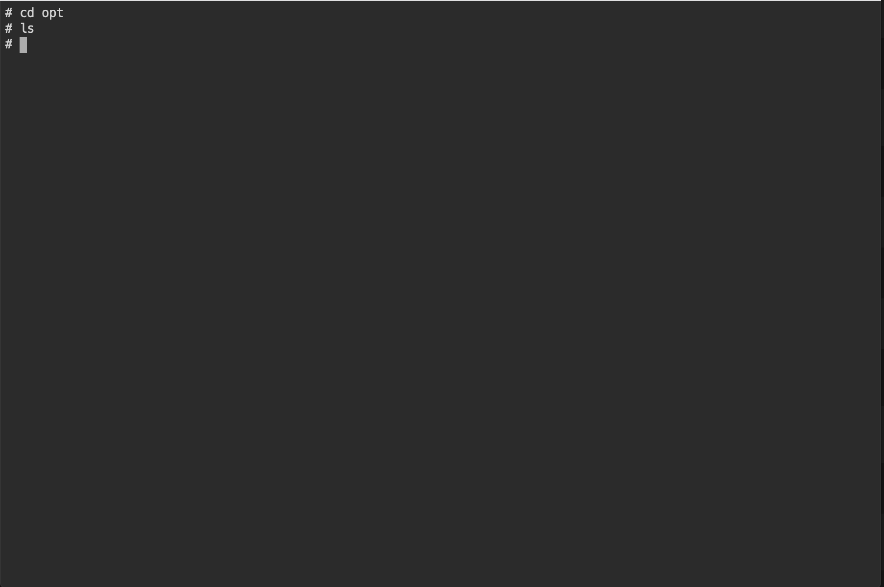

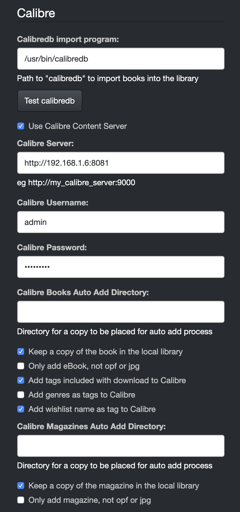

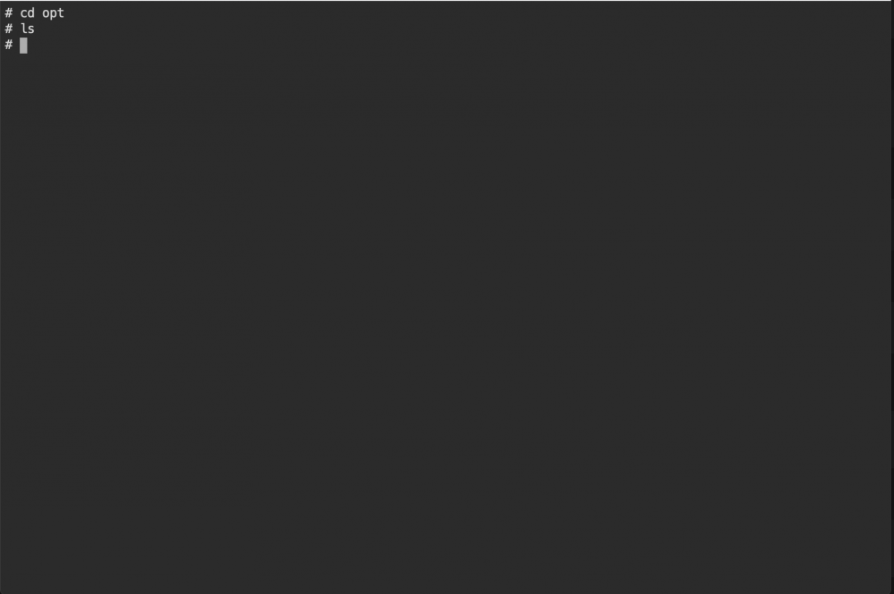

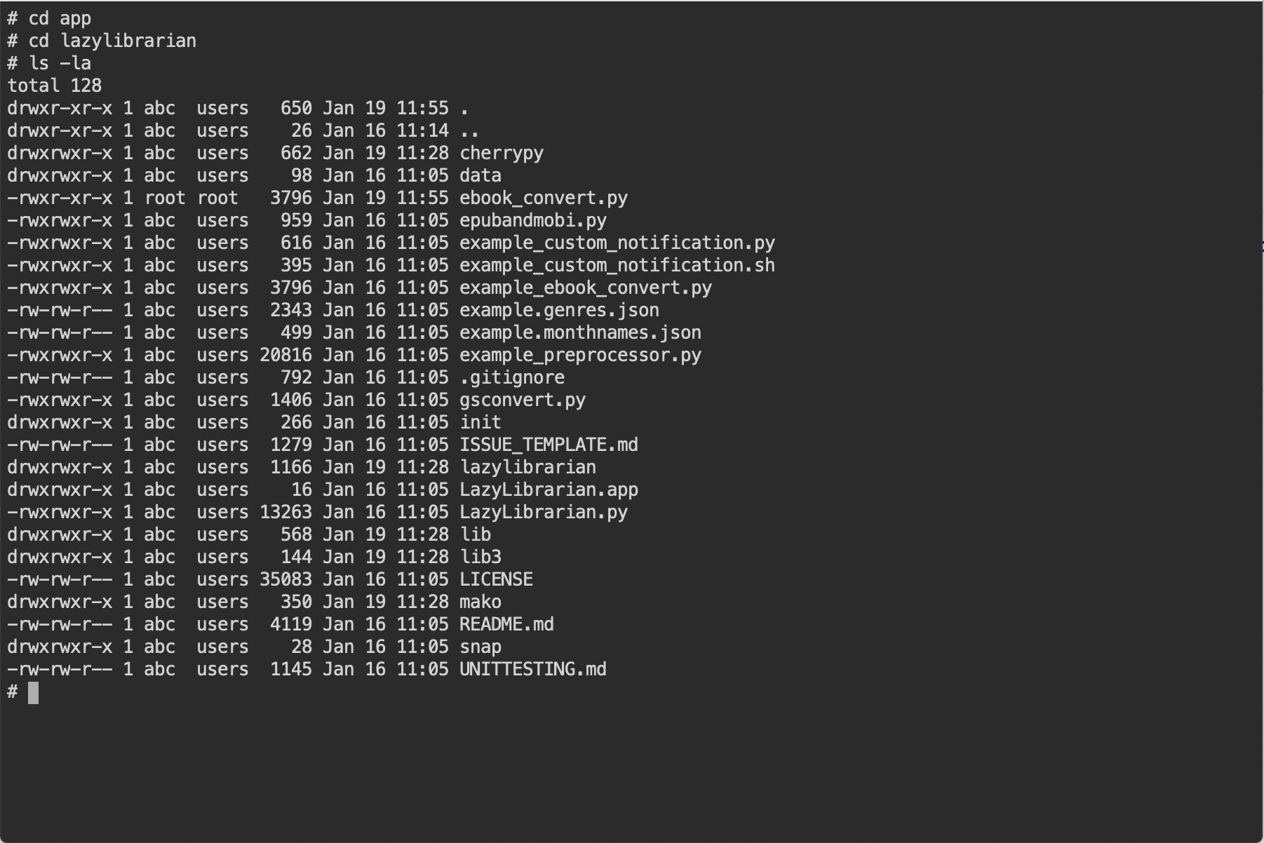

Last thing I am trying to do is run the converter in the preprocessor.  I have a couple of questions/issues...first I see the example_ebooks_convert.py in /app/lazylibrarian/.  I added /app/lazylibrarian/example_ebook_convert.py to the preprocessor program field, but it keeps saying...
Preprocessor returned 1: res[] err[runScript exception: FileNotFoundError [Errno 2] No such file or directory: '/app/lazylibrarian/example_ebook_convert.py': '/app/lazylibrarian/example_ebook_convert.py']
Also, in the script it wants to define the full path of ebook-convert if it does not exist in the same path as the script (I assume).  Since I don't see it in /app/lazylibrarian/ I checked and it seems like others have defined the path as /opt/calibre/ but this path seems to be empty.  I am not sure what I am supposed to use here.
