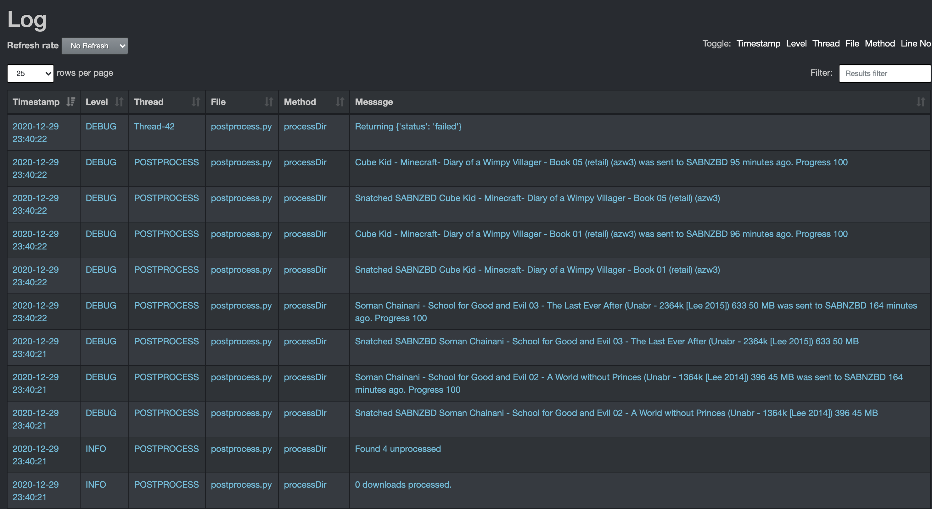

Hi all. I am having an issue where LL successfully finds a book and then sends it to SABNZBD where it is successfully downloaded but then LL does not process the completed download. Pretty much this issue on GitHub.
It's odd because the completed downloads WERE being processed at some point today but then stopped suddenly. The only change I had made was to setup a Calibre library. My Calibre library is kept in its own share (following SpaceInvaderOne's setup) at /calibrelibrary and is NOT under /media/books.
The prior LL files that were processed successfully are set to their respective </media/books/Author/Book Title> subfolder and Calibre then looks in /media/books to import/make a copy to the share /calibrelibrary
I understand the LL project itself has not been updated for the last 2 years or so but if anyone has the post-processing working, I don't mind to do periodic manual Importing to Calibre itself. TIA!
debug.zip
Edited by junknstuff
Added image & debug file
My current workaround is to manually add the LL BookID to the end of the downloaded file directory then run the post-processor, which is better than nothing, but I'm not sure what I'm missing for a truly automated experience.
The workaround was found in this Git issue from 2018

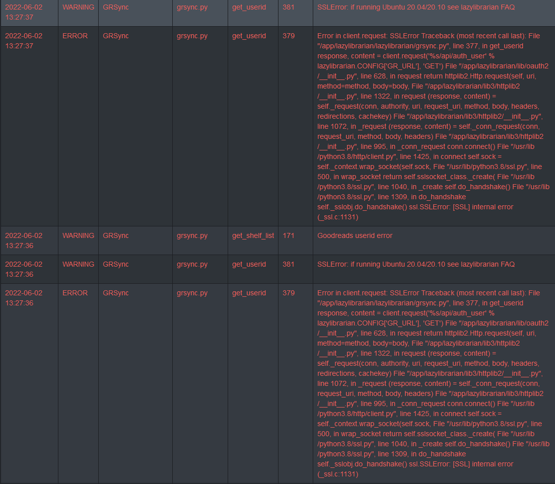

As of the latest update, goodreads sync no longer works. The error message in logs is shown here:image.thumb.png.dbaee8fb112d7bbd3f513d7d79476dd2.png
The error message directs me to the FAQ (https://lazylibrarian.gitlab.io/faq/) which mentions issues with SSL in Ubuntu 20.04+. Is there any intention to change the relevant SSL packages in the container image so that this works again?
