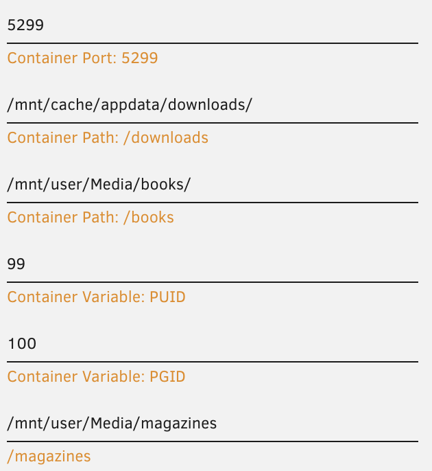

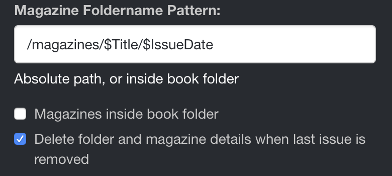

Hi.  Need some help to get magazines into their own folders.  After setting the following details, all downloaded magazines go to /books, per magazine.
Hi, anyone?

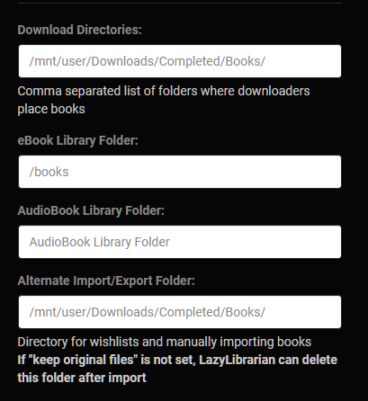

Hello,
I am new to Unraid but not to LazyLibrarian. I have LL up and running on unraid using nzbget and deluge. The program searches and sends the info to the downloaders fine, they then download the files to /mnt/user/Downloads/Completed/Books/ but I can not seem to get the postprocessing to work. I get
Download dir ['/mnt/user/Downloads/Completed/Books/'] not found, using /config
and
[/mnt/user/Downloads/Completed/Books/] is not a directory
I have tried as many different variations of the path that I can come up with and no difference, what simple thing that any fourth grader should know am I missing?
Any assistance is greatly appreciated
Chas
You have to mount that path by adding another path maping when editing the template of say /downloads to /mnt/user/.....
I'm sorry if I am being stupid, but I thought that was what I was doing here, no?
I know that the alternate should be different, but I was just trying to see if I could get the program to import from there if it wouldn't move in post processing.
