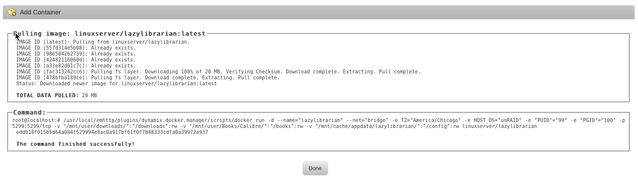

Two issues, one of which makes configuring it further difficult.
I've just installed this fresh; there was no app data folder to start.

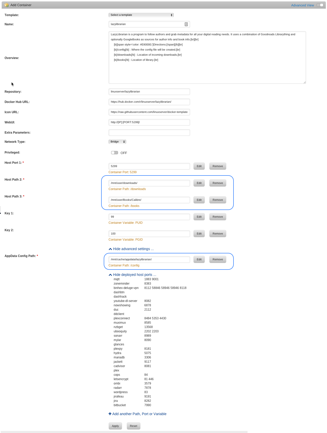

Docker setup: [I only changed the indicated fields]
Startup showing docker command:
It's running, and lists the IP as I'd expect.

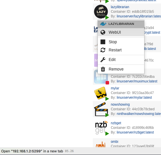

The WebUI menu item seems to be pointing to the right place:
Issue 1:

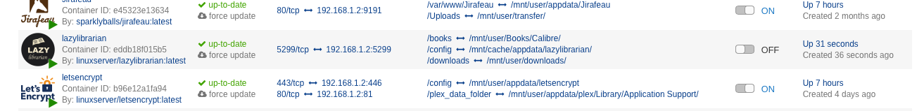

When I select "WebUI" from the menu, or click the "192.168.1.2:5299" link, I get this:
The URL in the address bar is now 127.0.0.1:5299.  If I edit it to 192.168.1.2:5299, the UI loads.  I can then bring up the settings panel, but clicking the save button gives me the can't connect because it's again going to 127.0.0.1.  Changes are saved, but I have to edit the URL again to get back to the UI.
