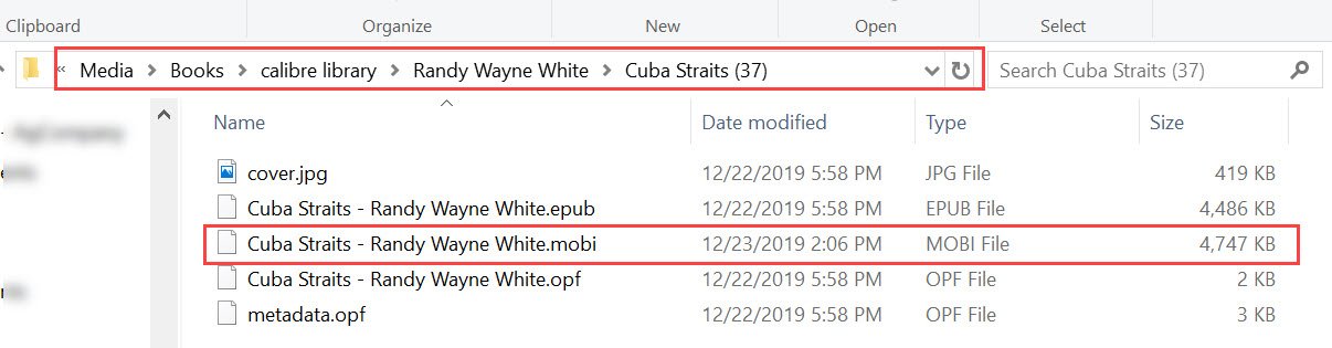

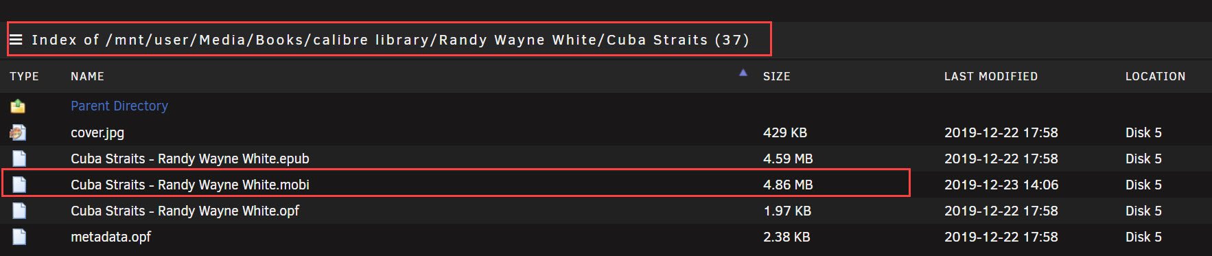

Having an issue sending books.  The log states that the ebook is missing, but I check the path and it’s definitely there.
Missing eBook Randy Wayne White, Cuba Straits [/books/Randy Wayne White/Cuba Straits (37)/Cuba Straits - Randy Wayne White.mobi]

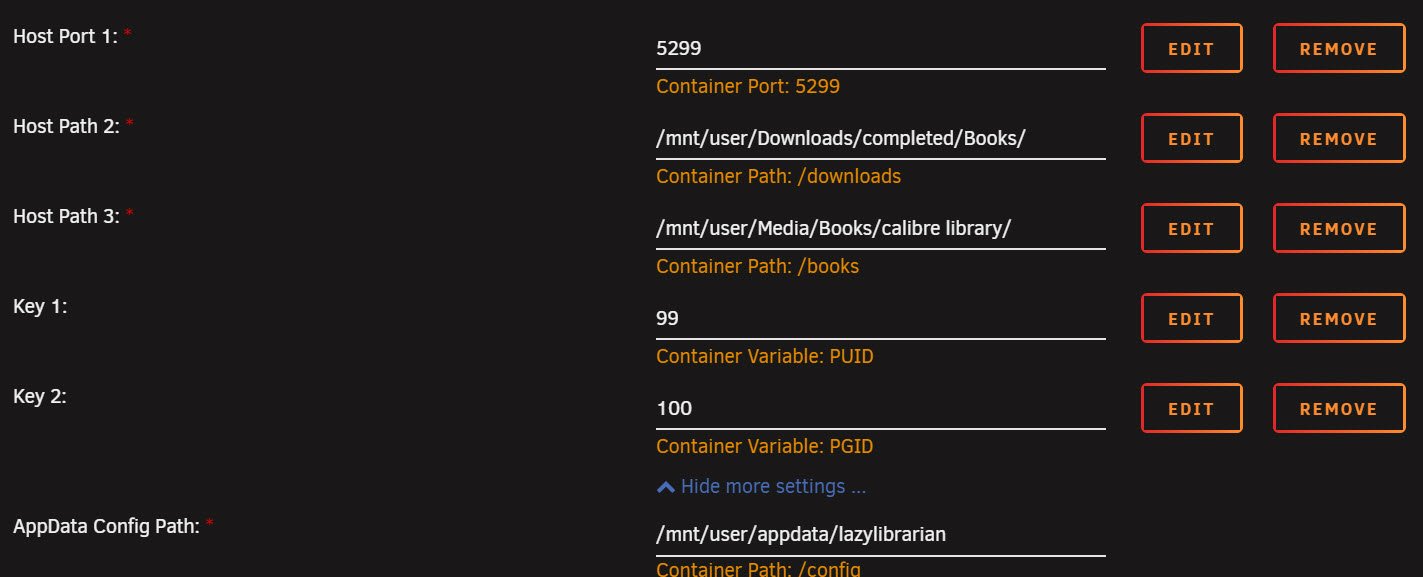

Without further documentation, best guess is that your container paths don't match. If you have /downloads -> /mnt/user/downloads in one docker and /data -> /mnt/user/downloads in the other docker, the files won't be found, because /downloads and /data are different, even though they point to the same destination on the host.
I don't think that is the case, but I have included some screen captures that I wasn't able to obtain with the original posting.
Let me know if there is anything else I can provide.  Thanks!

I can download the books fine, and they are then moved to the /books path.  The issue is when I click the send button in the UI to send the mobi file to my ereader.  That is when I see in the log that it cannot find the file, but the file is actually there.  LazyLibrarian has the correct path and file name, and the must see the files as it shows it as available to send to my device, but for some reason doesn’t see the file when attempting to send it to my device.
