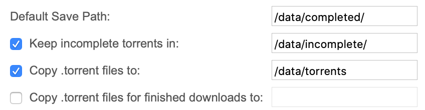

Hey,
I set up my system with binhex/radarr and binhex/qbittorrent and everything is working fine, except that I think it's not hard linking the movies but copying. I'm suspecting that because the inode is different. I double checked all the paths and read about the common issue with hard linking not working if they are on different volumes. But in my case they have the same path.
The "completed" directory of qbittorrent. The inode of the file is 86915752 here.
ubuntu@host:~/services/qbittorrent-movie/qbittorrent-data/completed/A Movie 1988 720p BluRay DD5.1 x264$ ls -lahi
total 9.7G
86917158 drwxr-xr-x  2 ubuntu ubuntu 4.0K Oct 17 21:26 .
86914936 drwxrwxr-x 28 ubuntu ubuntu 4.0K Oct 17 21:26 ..
86915752 -rw-r--r--  1 ubuntu ubuntu 9.7G Oct 17 21:26 A.Movie.1988.720p.BluRay.DD5.1.x264.mkv
The media directory of Radarr (which is then also the directory that Plex watches, but that's not important in this case). In here the inode is listed as 87568780. Different than the one in the complete directory. Assumption: It's a copy!
ubuntu@host:~/services/radarr/media/A Movie (1988)$ ls -lahi
total 9.7G
87572498 drwxr-xr-x  2 ubuntu ubuntu 4.0K Oct 17 21:29  .
87557920 drwxrwxr-x 21 ubuntu ubuntu 4.0K Oct 17 21:27  ..
87568780 -rw-r--r--  1 ubuntu ubuntu 9.7G Oct 17 21:26 'A Movie (1988) Bluray-720p.mkv'
My paths in Docker Compose look like this:
QBittorrent:
     - /home/ubuntu/services/qbittorrent-movie/qbittorrent-data:/data
Radarr:
     - /home/ubuntu/services/radarr/media:/media
In Radarr the path in the Movie Editor looks like this, which should be correct and also the movies end up in there, just not hard linked.
In QBittorrent the paths are set to the container path based on the mounted /data directory.
Based on everything I read in the FAQ this should all be correct, after changing around things a lot to get it running in the first place.
Would be very grateful for any pointers! 🙏
Thank you!

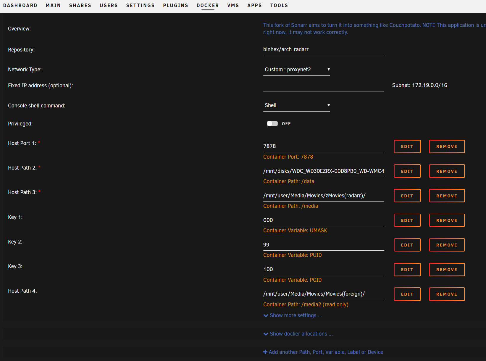

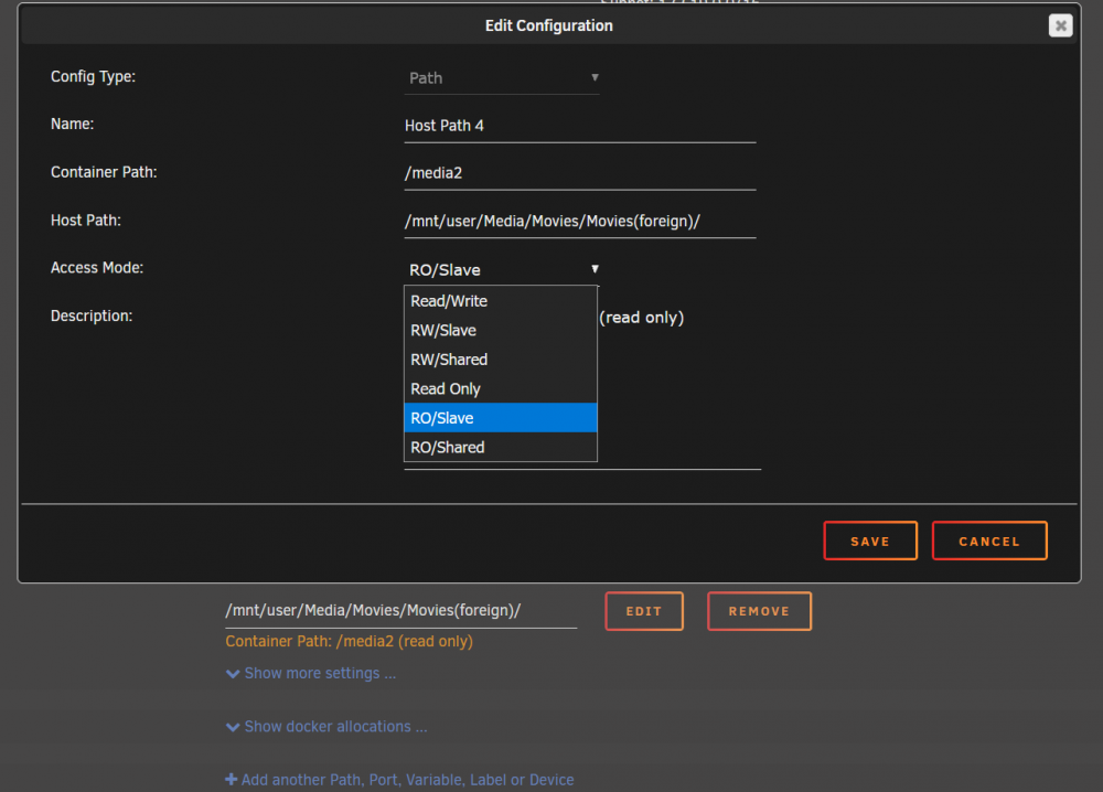

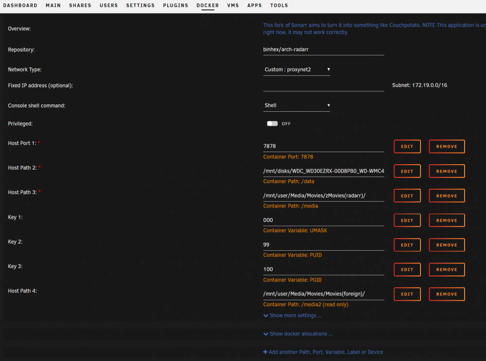

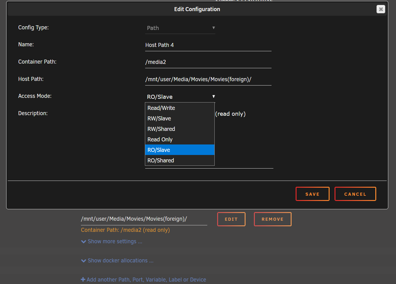

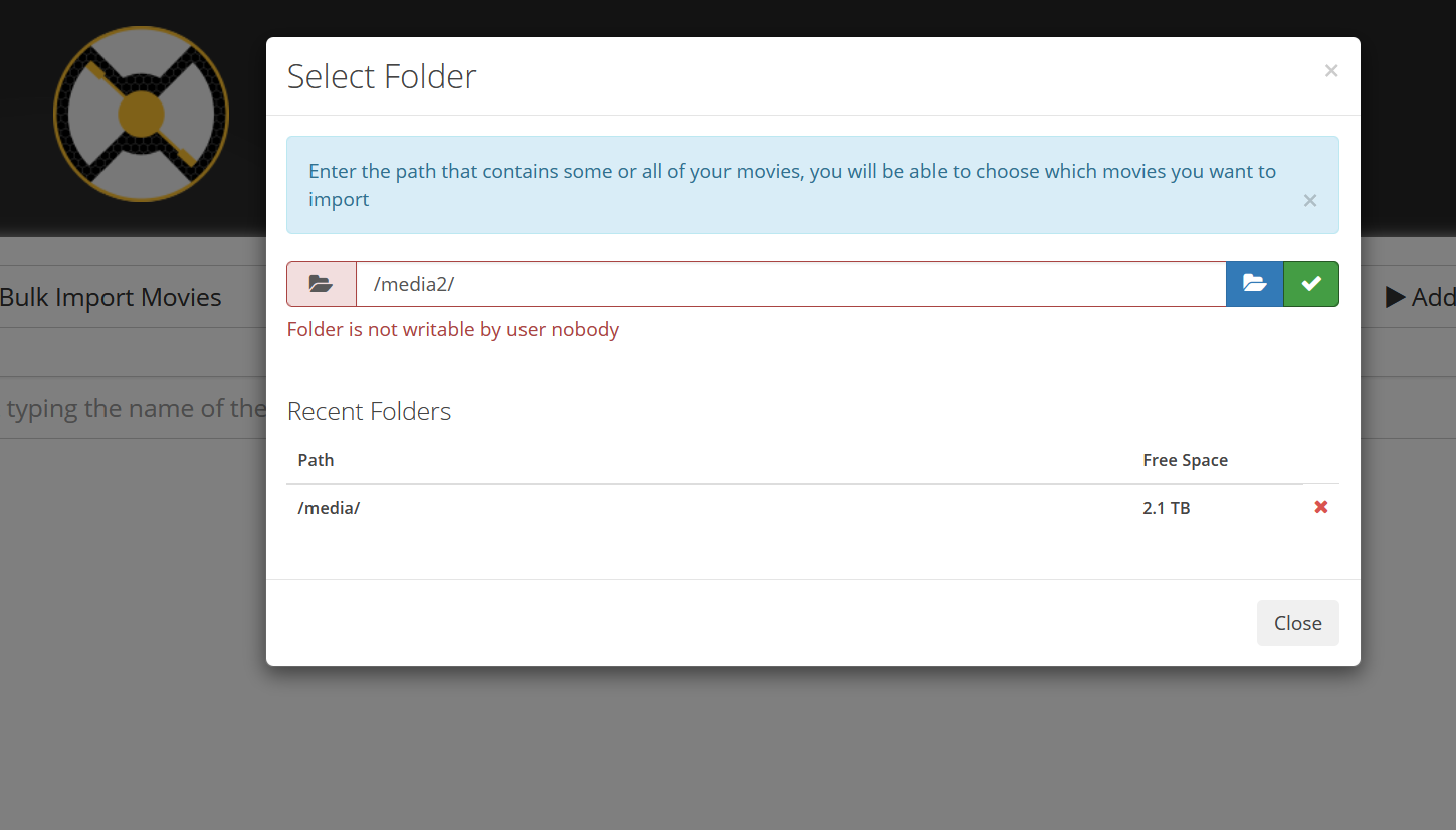

Hello,
I'm trying to add a second media source for radarr. I want this source to be only readable by radarr, so I don't accidentally change or delete them.
I went the following way:
I tried all of the read only options:
My Problem is that when I try to bulk import from that second media location, Radarr wants write permission:
So is there a way to force radarr to import anyway? I know this is more a Radarr question than a UnRaid one, but maybe someone can help me or point me in the right direction.
Thank you.
You might struggle there, as part of the underlying philosophy of Radarr is that it is in control of your library.  Because it's primary function is to put files into your library as it finds them, write access is assumed.
Are you doing this as you have a share that you want it to be aware of, but do not want it to change (that is, you've got the files as you want them)?  If so, you might have to set it to set it to Read/Write and import the titles as "Not Monitored".  I've got mine set up like that for one share, but can't remember how I did it.  Somebody else may better answer this, but I've got a feeling that when you import titles into Radarr using the bulk import facility, all titles are set to "Not Monitored".  That way, Radarr will never touch them unless you ask it to manually.
As a side-note, you'll need to mount your "/data" as RW/Slave, if you haven't already.
Not what I wanted to hear but thanks. I guess I will keep that seperate after all then.
Cheers
NP.  If a title is set to "not monitored", then Radarr is aware of it but will not touch it.  It therefore can't be added again.

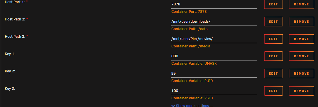

So i assume this is just a mix/mess up on my side. But since some major hardware changes, and a accidental format, my 'import' option on radarr/sonarr just takes forever.
Backstory: Upgraded hardware over thanksgiving from an i7-8086k // 32gb ram // 48tb (4 drives) // 512gb cache to a 2990wx Threadripper // 128gb ECC // 96tb (8 drives) // 512+1024gb cache. This being said, came right up and i went to add my 4 new drives and upgrade my key, i accidentally formatted my 512 SSD cache loosing my Appdata folder and VM's. So at this point i've set it all back up, but when i go to manually import a video via radarr or sonarr where it used to take 5 minutes or less, it now can take 30m-2hrs.
I assume its a Host Path setting of some kind.
Or some other setting
I'm making a lot of mistakes (like formatting cache), which of course i will blame on too much turkey, but any help would be greatly appricated. I have over 100 new movies to add and i'll be changing my 1080p content to 4k, but not if it takes 2 hours to import.
ok so your config for the container, whilst a bit whacky (storing movies under a share named Plex?) looks ok, im assuming you have no networking issues on your home lan right?, so check dns resolution is working ok on the host, also just make sure your download rate looks ok, it probably will be but worth checking. can you try updating to the latest docker image?, there was a release for radarr that came out early this morning, it may fix your issue.
one other thing to check, make sure your radarr config is being stored on the cache drive and not the array.
On 11/28/2019 at 10:31 AM, thostr said:
Please, Anyone have inputs how to resolve hvis?
Is this related to unRAID filestructrure, How Radarr renames the movies or a missing setting in this docker build?
this looks like the obfuscation used for usenet downloads, its possible radarr is not able to correctly rename the folder after download and thus the folder stays named in its obfuscated format, im assuming the filename is correctly named though, right?.

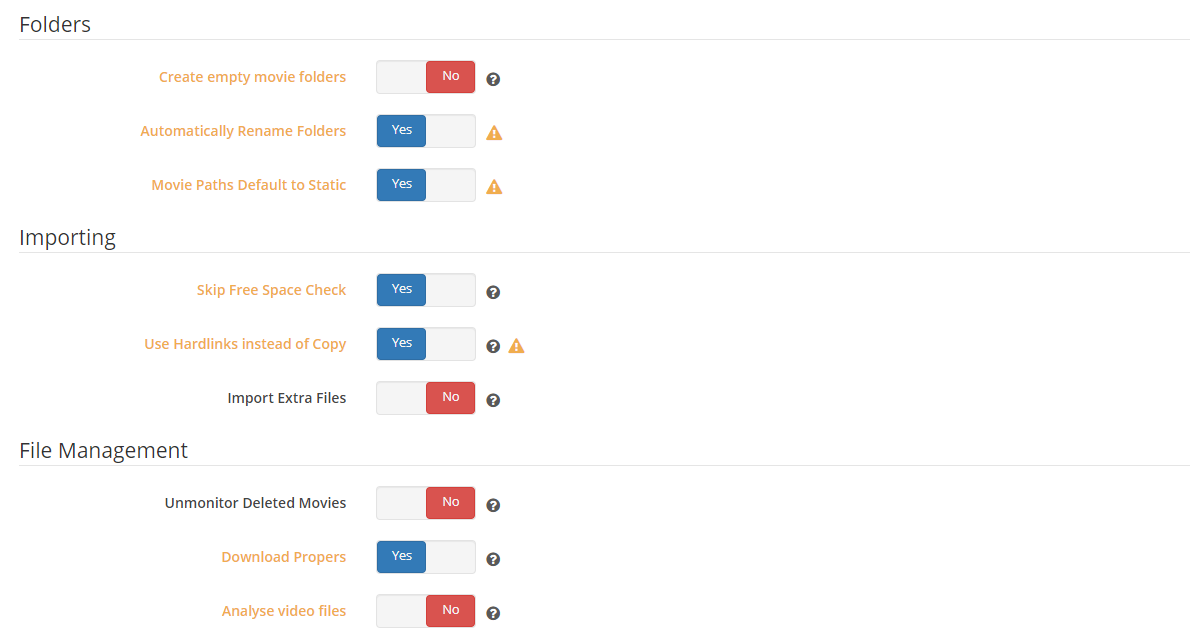

Updated Radarr/Jackett this morning
Checked network, i'm running 1000/55 with good ping times and DNS is resolving
I did force everything in AppData/Downloads/Domains over to my cache
Tried 2 files (5gb and 7gb) and it took 30 minutes to import. Its like hardlinking isnt working (And yes i know downloads is in cache now, it was in array before and doing the same thing)
Edited by Remamian
sp
It seems if Radarr automatically imports when it finds a new file, it takes no time, but if i manually do it it takes forever. I'm pretty sure, i'll have to do more testing.
Edit: After testing, it is loading quickly/normal when it automatically pulls in, but indeed the manual import is what takes forever.

Link of screenshot of my setup
RuTorrent : Autotool : https://imgur.com/6bcTNXk
RuTorrent : Unpack : https://imgur.com/bRsDE4b
Radarr : Media Management : https://imgur.com/wfE1e7w
Radarr : Download Clients : https://imgur.com/slPNQWD
Thank you
