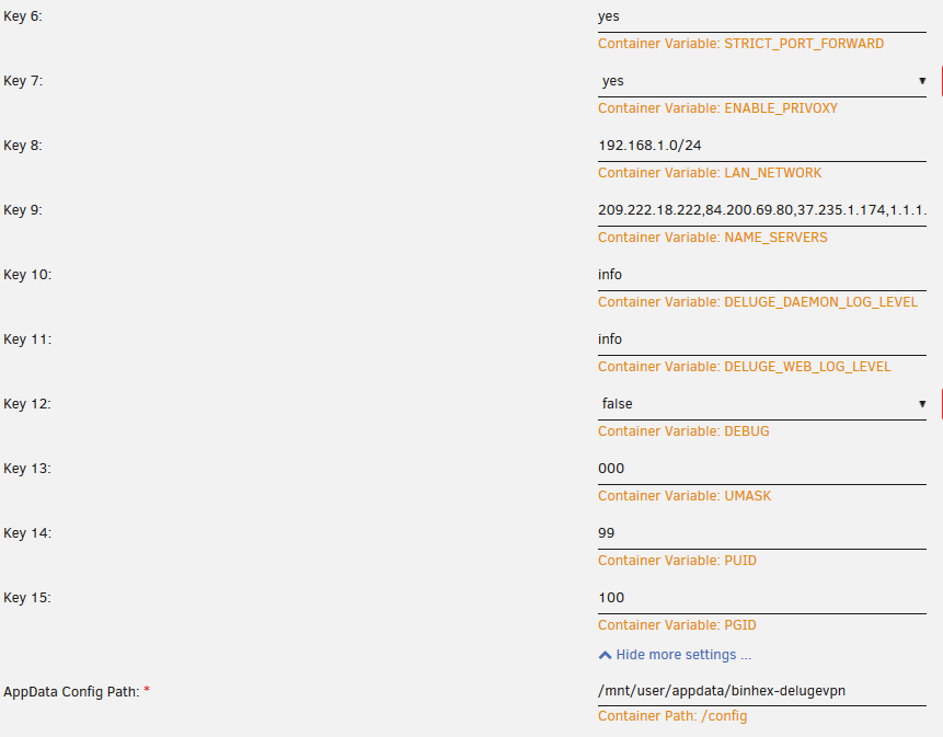

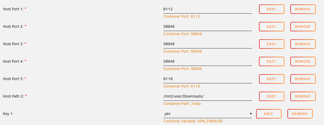

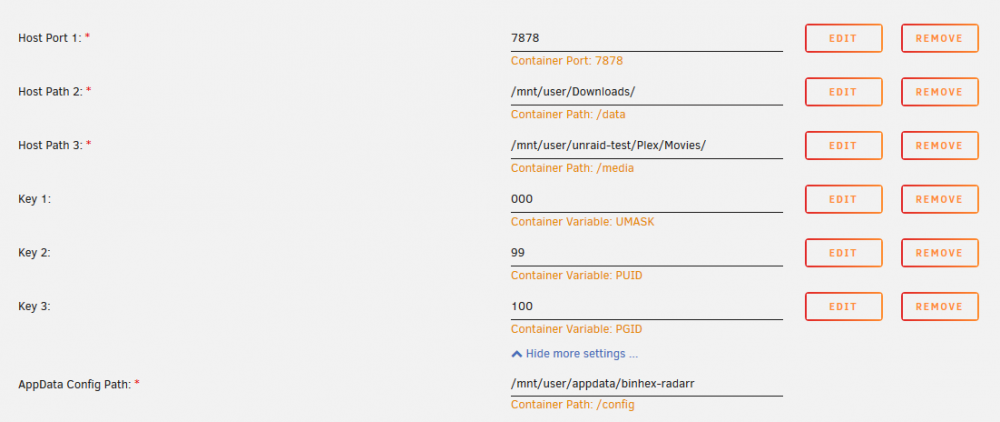

Hi Binhex,
Had a glance over my settings, I think they are ok?
Can you notice anything out of whack? My Sonarr works grand and renames etc
What are you using to download? Post a screenshot of the config for that
Sent from my CLT-L09 using Tapatalk
I am using your Deluge container :)
deluge1.thumb.PNG.1ae1f0a67c1097b46ac451c1e6b2b386.PNGdeluge2.PNG.16278230fe41374281cad5276267401b.PNG

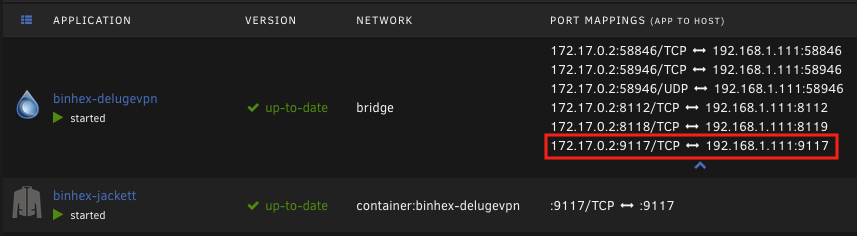

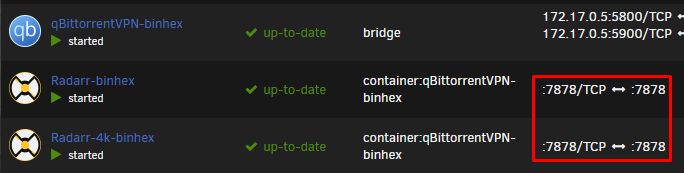

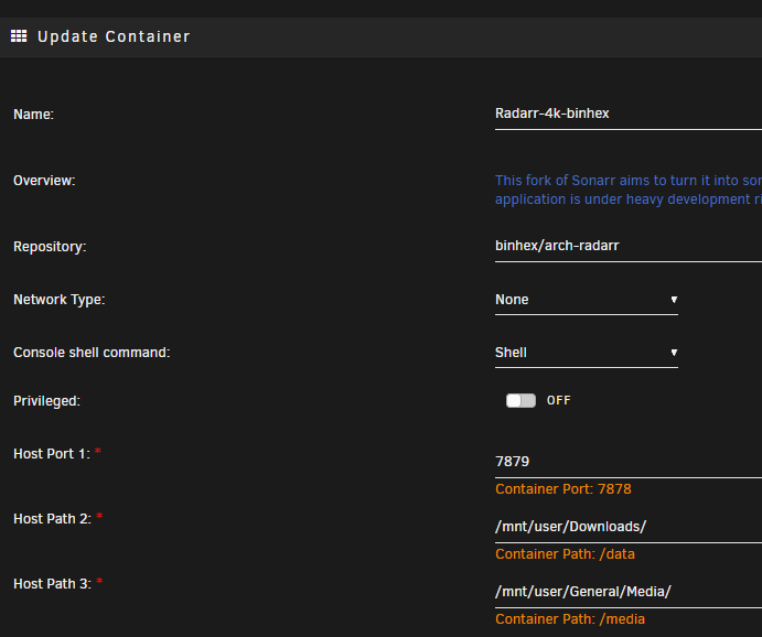

I want to run two instances of Radarr through my VPN container (qBittorrentVPN). It doesn't work though as I can't change the container port, only the host port.
What's the best way of getting around this as I'm struggling to find a way. Thanks!
You would have to change the application port from the Radarr UI under settings/general:
Then map the host port to the new application port, but you need to do that on the VPN container when you are using it’s network (not the Radarr container). I don't believe the container port mapping is actually used at all when using the network from another container.
Here's an example to illustrate.
If you are using two Radarr containers, you need to add two custom port mappings to the VPN container.
Edited by Jorgen
