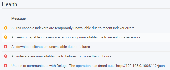

I've some issues with the Radarr and Sonarr. All connection to Jackett and DelugeVPN fails:
The connections to Plex and Slack are working. Tried to downgrade Radarr back to the previous version, but when startiing it's stuck on the logon screen.
Upgraded Sonarr to V3, same connection issues.
Couldn't find any errors in the logs.
Just a guess but check your privoxy is running on Deluge. I’m assuming you have Radarr Sonarr and Jackett proxy configured to connect to deluge.
Good point, I had problems with a previous version of DelugeVPN, could've forgotten to set the privoxy.
Checked it, and Privoxy is enabled and configured in every container. Jackett can connect to the indexers without any issues through Deluge.
So, I've tried averything I could think of. There was a new Jackett version available, so I upgraded it. I installed a clean 0.2.0.1504-1-02 version, still couldn't connect to DelugeVPN or Jackett... Any ideas what I should try?
Update: I've turned the proxy off, and now I can connect without any issues. I don't know why doesn't it work, it ahd no issues in the past, I'll check tomorrow.

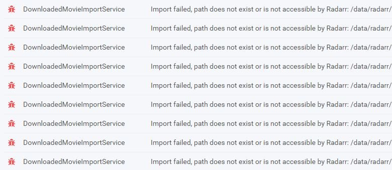

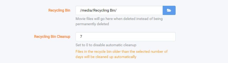

These last updates broke a whole bunch of stuff. The importer no longer works. I have over 300 pages of errors identical to this and a bunch of things stuck in limbo. For some reason, possibly related to this, it has downloaded three different copies of the same movie in no particular order. It's not replacing a lower quality copy with a higher quality copy, I think it doesn't see the file moved, so it tries another release.
The thing that really sucks is the recycling bin enabled a default option to delete ALL files in that folder older than 7 days. I hadn't gone in and manually fixed the files sitting in that folder yet, so it wiped that entire directory. This should have been an opt-in instead of the default configuration, considering this is an in-place upgrade and not a new installation.
