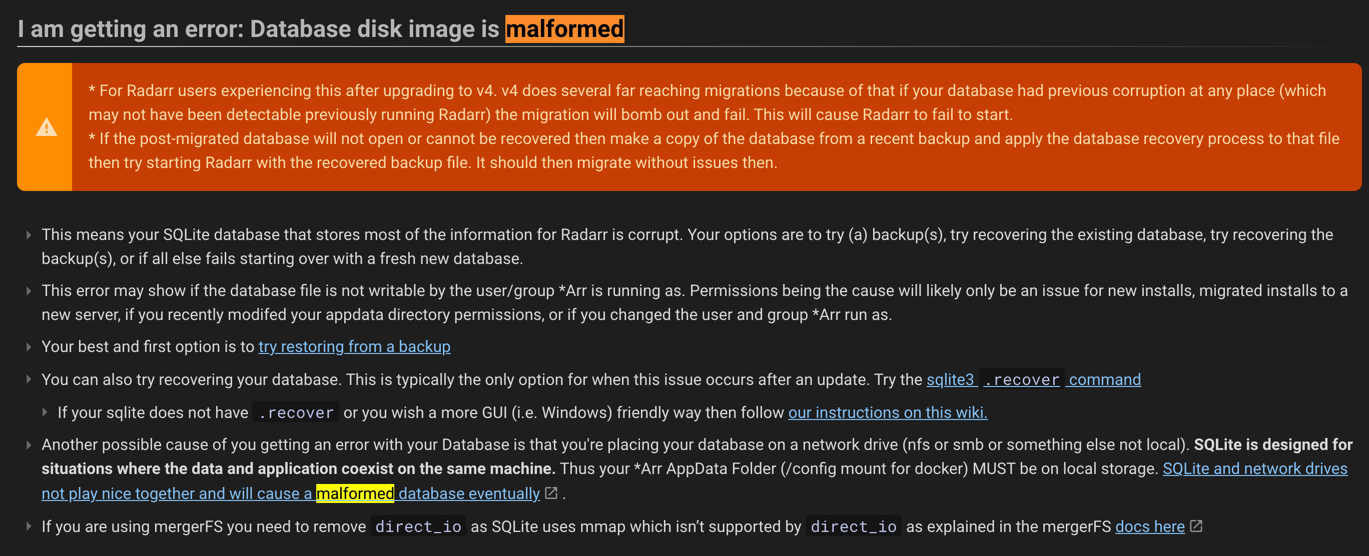

the official Radarr forum has a few other things that can be attempted to repair corruption in existing database, I might try to do that before starting anew. The step by step guide is here:
https://wiki.servarr.com/useful-tools#recovering-a-corrupt-db-ui

Same here. Worth noting that I followed the link in the post below before I updated & went up to step 14 without seeing any errors. Not sure if that's an indicator of how the migration is likely to go or just coincidence. From sounds of things, I would've expected some errors during the process at some point if the db was corrupt in any way.

Hi all - I can see others have been recently having malformed database issues after an upgrade. I have had similar problems, and have restored the appdata files including the DB from my CA Backup/Restore Plugin. I have done this for three different backups going back three months, and all of these are somehow still coming up with malformed database errors in the logs.
Am I screwed and need to start from scratch or is there any other steps I might be missing?
