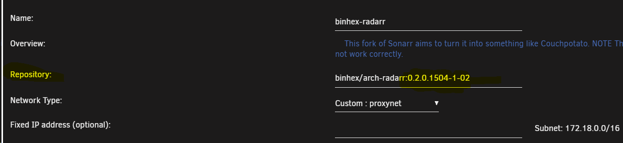

8 minutes ago, TRusselo said:
how do I roll back until fixed?
never had to do this before...
Googling told me to change the branch from "latest" to another tag found on docker page....?
i cannot find "latest" in the docker / edit page...
Edit the repository. After the name of the repo type a colon and then the release number from the link that @xxDeadbolt posted.
Cheers, thought I'd added that in as well 🤣
thank you.
for others, with 1 less brain cell than I,  edit docker container:
add :0.2.0.1504-1-02  to the end of repository, click save at bottom
***  It will never update with this tag !!!!!  remove later when you want to update

48 minutes ago, GeekMajic said:
This is very helpful, hopefully someone posts when fixed and we can remove the repo static release .
You could always install an instance of the docker without the static repo and an instance with the static repo and have both with the same template options so that once it is fixed you can just stop the static one and remove it and restart the non static docker so that all your settings are kept. Just make sure that you link the same directories on both but change the docker name itself for the static one. This way you can keep using the docker and functioning normally until then
