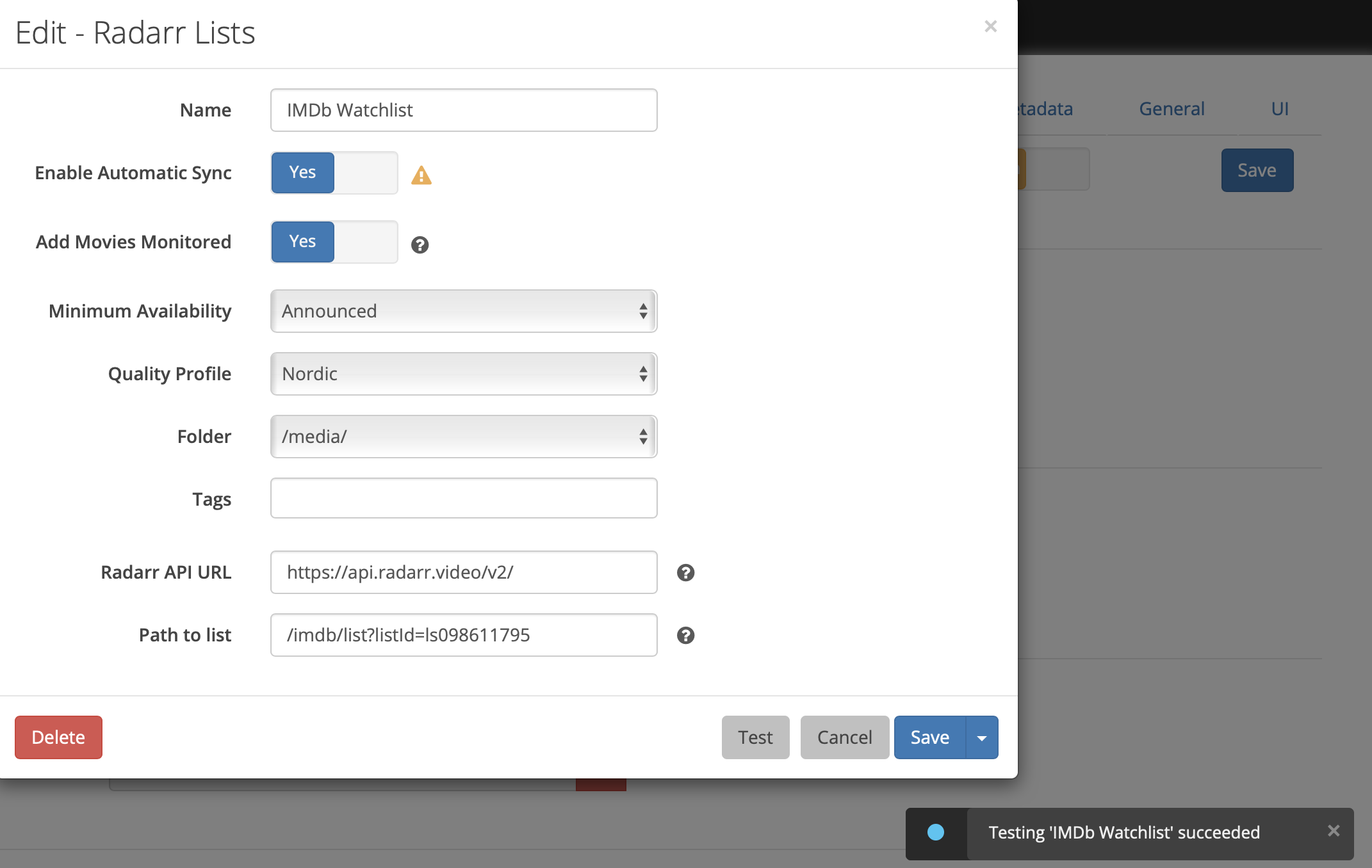

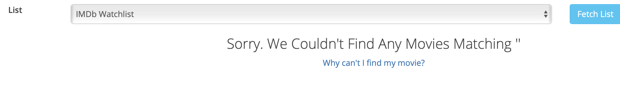

Hey!
I hope somebody are able to help me. I am having some problems with adding movies from a IMDB watch list.
I have created the list, as seen in the picture, and the connection works. When I first did it, I was able to fetch the list and add movies without problems. But when I try to add the movies from the list now, I just receive the error ' Sorry. We Couldn't Find Any Movies Matching " '.
I don't know if anybody can help me, but I can't seem to find any answer on how to solve this.
image.thumb.png.502b1dd82cbe831b19eff0b2f1126374.pngimage.thumb.png.894c94d2cf9ad40dd91660f1bfdeb803.png

I think there is an issue with the IMDB servers/Radarr API. MY list doesn't error, but no movies I have added since yesterday morning are showing up. I went directly to the Radarr API (take the two URL pieces and paste them together in your browser) and the list shown there does not match my IMDB watchlist on IMDB's web site. It's as if the list was cached in the API sometime yesterday morning and not getting the newest list. I don't know if this is a Radarr API issue, or if the IMDB server the Radarr API connects to is not syncing with the rest of IMDB's servers. I was able to create a brand new list and get movies added there to show so it leads me to believe it is a Radarr API issue and not an IMDB, but I don't know for sure. I figure I'll give it another day or two and see what happens as I have plenty to watch in the mean time. If it hasn't been resolved I'll stat investigating the issue further on the Radarr forums.
It works for me now, so guess you're right :D Thanks anyway
