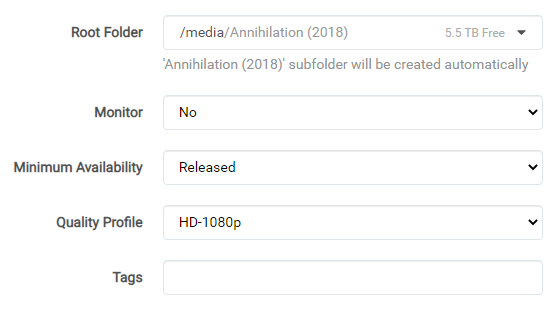

Hello -
I was wondering why it was not finding my current movie share.  It wants to look in /media/movie name and I have the following set up as
Is it weird? Like it doesn't see all of the current movies that I have in the share. I had figured that /media/ would signal to Radarr to look in the /mnt/user/Movies folder...*shrug* I'm just curious is all.
Edited by cbr600ds2
2 minutes ago, cbr600ds2 said:
Is it weird?
This is proper behavior. The app inside the container sees /media/<name of movie>. The actual location on your server will be /mnt/user/Complete/<name of movie>
The app should see all files in the Complete folder when it browses /media/.
hahaha Thanks WG!  It's working so I'm not going to trip about it.  One last weird question - if the movie is "monitored" it still seems like I have to go in to it and click on the glasses to search for it.  What setting am I missing to do this ish automatically?

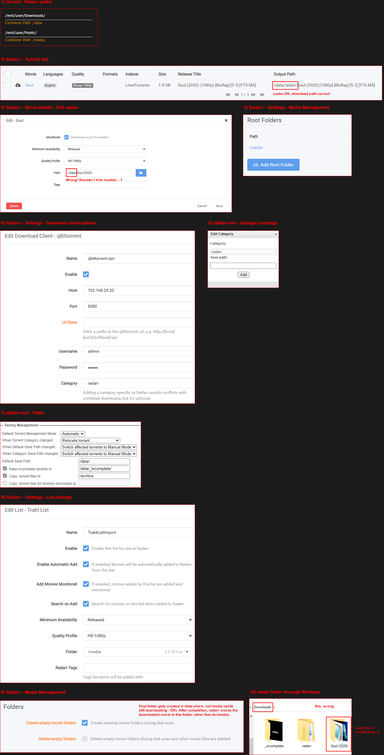

I'm new to radarr so this might be a little confusion from my side, but I've tried to tweak around and nothing seems to work
My downloads are renamed correctly but and transferred to the wrong location: to /data/[movie]/ instead of /movies[movie]/
At first I thought the default qbittorrent destination (#7 below) would be the problem, but I noticed that the /data/[movie]/ gets created while the file is still downloading (due to #9 - so OK), but when it's completed radarr moves the files to /data/[movie]/ regardless ☹️
both qbittorrent and radarr are binhex's
references:
Edited by timmyx
wording
Pic #3.  Just change the path.  Radarr uses "root" folders, and it uses the last one you've set as a default.  Add a new movie, Add a new path for a root folder and it'll use that one going forward by default.
Edit: Now working! Apparently all I had to do was delete and create a new list for trakt.
tks for the help Squid 😃
 Thanks! It did the trick for manually added movies, but it's not working for the trakt list ☹️
I did this: manually added a new movie and let radarr do its thing -- all good: files renamed, moved to the correct folder I added manually
So next I added a new movie to my trakt list and had radarr fetch it
the "old" folder is there as default
but if I add manually it defaults to the correct one
Edited by timmyx
works now
