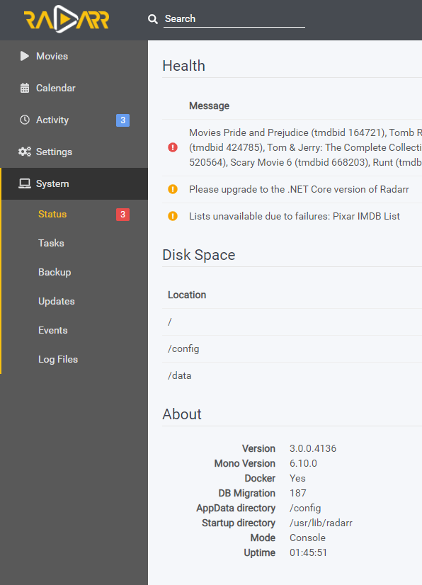

I have this warning in my dashboard:
V3 is a nice upgrade!
Please upgrade to the .NET Core version of Radarr
https://wiki.servarr.com/Radarr_System#update-to-net-core-version

Just received an update to binhex-radarr and it wont start.  The log shows:
2020-11-29 18:19:20,658 DEBG fd 8 closed, stopped monitoring <POutputDispatcher at 22513266745792 for <Subprocess at 22513267025856 with name radarr in state STARTING> (stdout)>
2020-11-29 18:19:20,658 DEBG fd 10 closed, stopped monitoring <POutputDispatcher at 22513267026576 for <Subprocess at 22513267025856 with name radarr in state STARTING> (stderr)>
2020-11-29 18:19:20,658 INFO exited: radarr (exit status 2; not expected)
2020-11-29 18:19:20,658 DEBG received SIGCHLD indicating a child quit
2020-11-29 18:19:23,663 INFO spawned: 'radarr' with pid 67
2020-11-29 18:19:23,673 DEBG 'radarr' stderr output:
Cannot open assembly '/usr/lib/radarr/Radarr.exe': No such file or directory.
Seems the executable does not exist.  I am not sure how to fix it, any suggestions?
