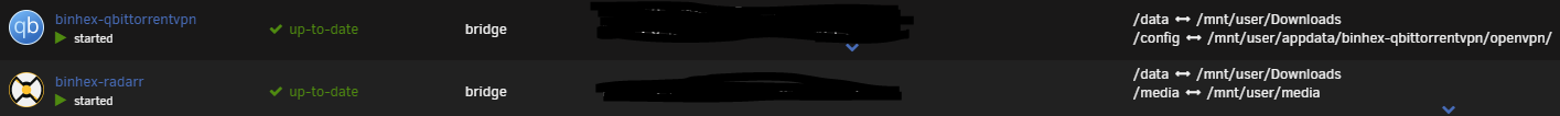

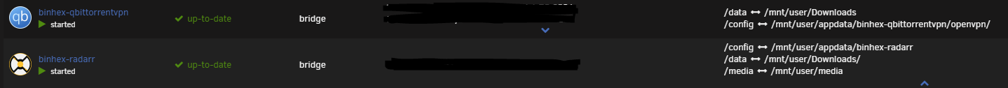

I'm getting the "Import failed, path does not exist or is not accessible by Radarr:"
Yesterday I changed all the paths to match in the docker container. I then deleted the database, and started over again, so the paths would be updated. I thought that had fixed it.
But now I'm getting the import failed error again.
Radarr creates the new file folder. It can see where they are, and if I manually move the files into the newly created folders, it can rename them.  What am I missing?
Match what? Post the docker run command for your downloader and radarr.
Downloader:
root@localhost:# /usr/local/emhttp/plugins/dynamix.docker.manager/scripts/docker run -d --name='binhex-sabnzbdvpn' --net='bridge' --privileged=true -e TZ="America/Los_Angeles" -e HOST_OS="Unraid" -e 'VPN_ENABLED'='yes' -e 'VPN_USER'='*********' -e 'VPN_PASS'='********' -e 'VPN_PROV'='pia' -e 'VPN_OPTIONS'='' -e 'STRICT_PORT_FORWARD'='no' -e 'ENABLE_PRIVOXY'='no' -e 'LAN_NETWORK'='192.168.1.0/24' -e 'NAME_SERVERS'='209.222.18.222,84.200.69.80,37.235.1.174,1.1.1.1,209.222.18.218,37.235.1.177,84.200.70.40,1.0.0.1' -e 'ADDITIONAL_PORTS'='8081' -e 'DEBUG'='false' -e 'UMASK'='000' -e 'PUID'='99' -e 'PGID'='100' -p '9876:8080/tcp' -p '8090:8090/tcp' -p '8118:8118/tcp' -v '/mnt/user/media/':'/data':'rw' -v '/mnt/user/appdata/binhex-sabnzbdvpn':'/config':'rw' 'binhex/arch-sabnzbdvpn'
Radarr:
root@localhost:# /usr/local/emhttp/plugins/dynamix.docker.manager/scripts/docker run -d --name='binhex-radarr' --net='bridge' -e TZ="America/Los_Angeles" -e HOST_OS="Unraid" -e 'UMASK'='000' -e 'PUID'='99' -e 'PGID'='100' -p '7878:7878/tcp' -v '/mnt/user/media/':'/data':'rw' -v '/mnt/user/media/':'/media':'rw' -v '/mnt/user/appdata/binhex-radarr':'/config':'rw' 'binhex/arch-radarr'
Remove the /mnt/user/media = /media mapping.
I removed the media mapping.  Got a system health message:  Multiple root folders are missing: /media/Movies  That checks, I just removed it.
Clicked update library. --> In logs "Import failed, path does not exist or is not accessible by Radarr: /data/Movies/..."

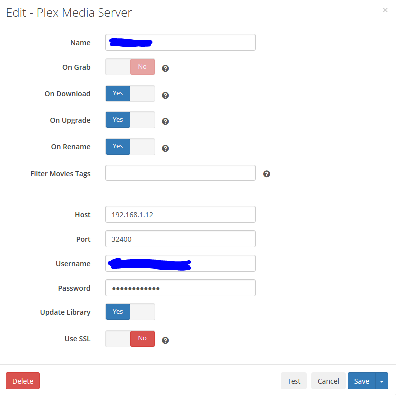

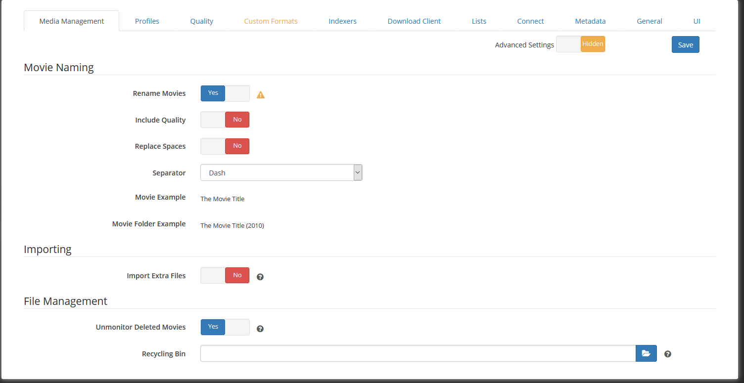

Hello All,
I was wondering if anyone could assist me with getting Radar to rename the movies? Previously this worked, I think I had to reinstall the docker and since then it isn't removing full stops etc. My binhex-sonar is working fine though and I verified the settings off of each of the containers, they appear near enough identical in all aspects.
I uploaded screenshots of what I believe are the relevant settings. Is there something obvious I am missing? :)
cheers
