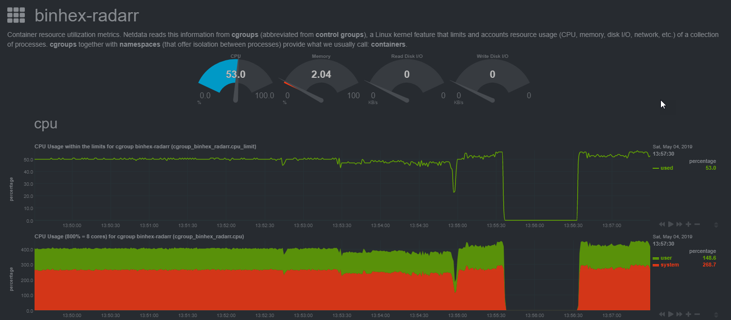

Anyone having a high CPU usage even with radarr off? sonarr is ~20% which is high also

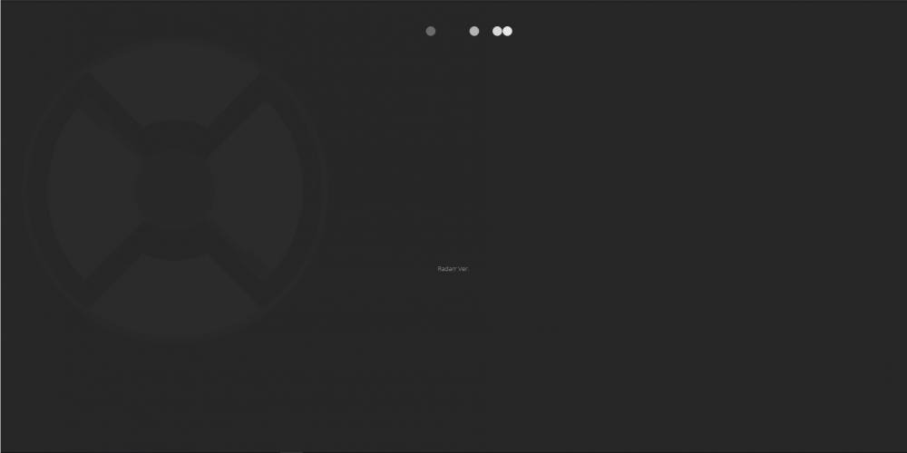

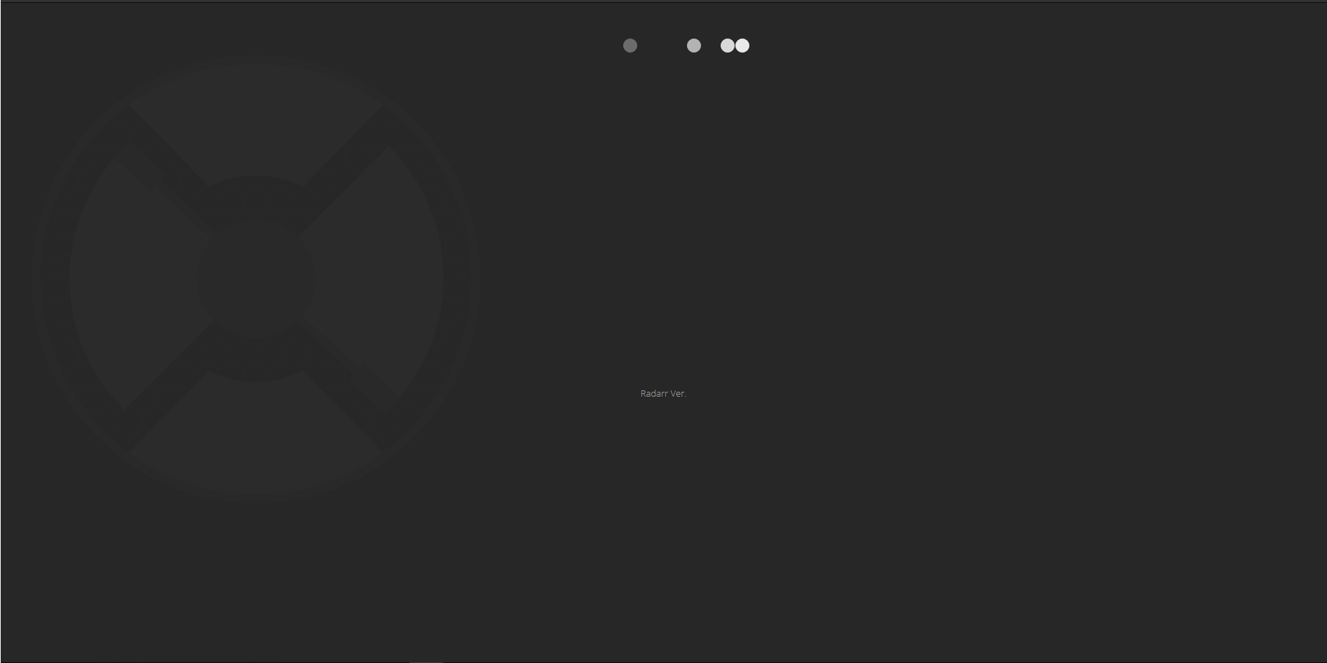

Not quite sure what's going on here but I've been stuck seeing this whenever I try to access radarr from a web browser. Issue started last night. I can access the radarr main page from my phone where I'm shown a mobile version of the site, the issue only seems to occur when I try to access it from windows PC's.
Does anyone have an idea why this is happening? Or what I can do to resolve it?
Also as a separate whenever I try to update library I get a failed message. Again, this has only been happening since last night.
I seem to be having an issue in the last few weeks of Radarr not being able to connect to my Newznab indexer. Sonarr however has no issues connecting to it with the same URL and API key. @trurl @Squid @binhex Any thoughts on why this may be?
Edited by Arcaeus
Removing the docker, deleting the Radarr folder inside appdata and reinstalling fixed all issues. Cause still unknown but at least it's been cured.

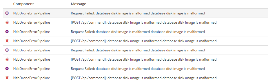

I have what I'm hoping is a simple question on this one.
It seems, no matter what I do (restricting config to one specific brand new disk, splitting it, whatever) I am finding the Radarr database constantly getting corrupted.
It seems if I restart the docker, it leads to a screwed up database, and I'm usually going to end up having to restore from backup, or reinstall completely. Which means more scans, etc etc.
I just go into the log and see this over and over:
CommandExecutorStarting 2 threads for tasks.5:12pm
TaskExtensionsTask Error: database disk image is malformed database disk image is malformed5:10pm
SignalR exception thrown by Task: System.AggregateException: One or more errors occurred. ---> System.IO.IOException: Unable to write data to the transport connection: Connection reset by peer. ---> System.Net.Sockets.SocketException: Connection reset by peer at System.Net.Sockets.Socket.Send (System.Byte[] buffer, System.Int32 offset, System.Int32 size, System.Net.Sockets.SocketFlags socketFlags) [0x00017] in /build/mono/src/mono/mcs/class/referencesource/System/net/System/Net/Sockets/Socket.cs:1540 at System.Net.Sockets.NetworkStream.Write (System.Byte[] buffer, System.Int32 offset, System.Int32 size) [0x0009b] in /build/mono/src/mono/mcs/class/referencesource/System/net/System/Net/Sockets/NetworkStream.cs:591 --- End of inner exception stack trace --- at System.Net.Sockets.NetworkStream.Write (System.Byte[] buffer, System.Int32 offset, System.Int32 size) [0x000c3] in /build/mono/src/mono/mcs/class/referencesource/System/net/System/Net/Sockets/NetworkStream.cs:602 at System.Net.ResponseStream.InternalWrite (System.Byte[] buffer, System.Int32 offset, System.Int32 count) [0x0001b] in /build/mono/src/mono/mcs/class/System/System.Net/ResponseStream.cs:136 at System.Net.ResponseStream.Write (System.Byte[] buffer, System.Int32 offset, System.Int32 count) [0x0008d] in /build/mono/src/mono/mcs/class/System/System.Net/ResponseStream.cs:162 at Microsoft.Owin.Host.HttpListener.RequestProcessing.ExceptionFilterStream.Write (System.Byte[] buffer, System.Int32 offset, System.Int32 count) [0x00024] in <208c8ef8a4ba4b878f0e4420d5960bea>:0 at Microsoft.AspNet.SignalR.Owin.ServerResponse.Write (System.ArraySegment`1[T] data) [0x00000] in C:\projects\radarr-usby1\src\Microsoft.AspNet.SignalR.Owin\ServerResponse.cs:50 at Microsoft.AspNet.SignalR.Infrastructure.BinaryTextWriter+<>c.<.ctor>b__0_0 (System.ArraySegment`1[T] data, System.Object state) [0x00000] in C:\projects\radarr-usby1\src\Microsoft.AspNet.SignalR.Core\Infrastructure\BinaryTextWriter.cs:12 at Microsoft.AspNet.SignalR.Infrastructure.BufferTextWriter+ChunkedWriter.Flush (System.Byte[] byteBuffer, System.Boolean flushEncoder) [0x00027] in C:\projects\radarr-usby1\src\Microsoft.AspNet.SignalR.Core\Infrastructure\BufferTextWriter.cs:182 at Microsoft.AspNet.SignalR.Infrastructure.BufferTextWriter+ChunkedWriter.Flush (System.Boolean flushEncoder) [0x00008] in C:\projects\radarr-usby1\src\Microsoft.AspNet.SignalR.Core\Infrastructure\BufferTextWriter.cs:163 at Microsoft.AspNet.SignalR.Infrastructure.BufferTextWriter+ChunkedWriter.Flush () [0x00000] in C:\projects\radarr-usby1\src\Microsoft.AspNet.SignalR.Core\Infrastructure\BufferTextWriter.cs:155 at Microsoft.AspNet.SignalR.Infrastructure.BufferTextWriter+ChunkedWriter.Write (System.ArraySegment`1[T] data) [0x00000] in C:\projects\radarr-usby1\src\Microsoft.AspNet.SignalR.Core\Infrastructure\BufferTextWriter.cs:149 at Microsoft.AspNet.SignalR.Infrastructure.BinaryTextWriter.Write (System.ArraySegment`1[T] data) [0x00000] in C:\projects\radarr-usby1\src\Microsoft.AspNet.SignalR.Core\Infrastructure\BinaryTextWriter.cs:31 at Microsoft.AspNet.SignalR.Transports.PersistentResponse.WriteMessages (System.IO.TextWriter writer, Newtonsoft.Json.JsonTextWriter jsonWriter) [0x00063] in C:\projects\radarr-usby1\src\Microsoft.AspNet.SignalR.Core\Transports\PersistentResponse.cs:167 at Microsoft.AspNet.SignalR.Transports.PersistentResponse.Microsoft.AspNet.SignalR.Json.IJsonWritable.WriteJson (System.IO.TextWriter writer) [0x000f5] in C:\projects\radarr-usby1\src\Microsoft.AspNet.SignalR.Core\Transports\PersistentResponse.cs:131 at Microsoft.AspNet.SignalR.Json.JsonNetSerializer.Serialize (System.Object value, System.IO.TextWriter writer) [0x0000a] in C:\projects\radarr-usby1\src\Microsoft.AspNet.SignalR.Core\Json\JsonNetSerializer.cs:61 at NzbDrone.SignalR.Serializer.Serialize (System.Object value, System.IO.TextWriter writer) [0x0001f] in C:\projects\radarr-usby1\src\NzbDrone.SignalR\Serializer.cs:20 at Microsoft.AspNet.SignalR.Transports.LongPollingTransport.PerformSend (System.Object state) [0x00085] in C:\projects\radarr-usby1\src\Microsoft.AspNet.SignalR.Core\Transports\LongPollingTransport.cs:315 at Microsoft.AspNet.SignalR.Transports.LongPollingTransport+<>c.<Send>b__43_0 (System.Object state) [0x00000] in C:\projects\radarr-usby1\src\Microsoft.AspNet.SignalR.Core\Transports\LongPollingTransport.cs:157 at Microsoft.AspNet.SignalR.Infrastructure.TaskQueue.<Enqueue>b__14_0 (System.Func`2[T,TResult] next, System.Object nextState) [0x00000] in C:\projects\radarr-usby1\src\Microsoft.AspNet.SignalR.Core\Infrastructure\TaskQueue.cs:85 at Microsoft.AspNet.SignalR.TaskAsyncHelper.FromMethod[T1,T2] (System.Func`3[T1,T2,TResult] func, T1 arg1, T2 arg2) [0x00000] in C:\projects\radarr-usby1\src\Microsoft.AspNet.SignalR.Core\TaskAsyncHelper.cs:764 --- End of inner exception stack trace --- ---> (Inner Exception #0) System.IO.IOException: Unable to write data to the transport connection: Connection reset by peer. ---> System.Net.Sockets.SocketException: Connection reset by peer at System.Net.Sockets.Socket.Send (System.Byte[] buffer, System.Int32 offset, System.Int32 size, System.Net.Sockets.SocketFlags socketFlags) [0x00017] in /build/mono/src/mono/mcs/class/referencesource/System/net/System/Net/Sockets/Socket.cs:1540 at System.Net.Sockets.NetworkStream.Write (System.Byte[] buffer, System.Int32 offset, System.Int32 size) [0x0009b] in /build/mono/src/mono/mcs/class/referencesource/System/net/System/Net/Sockets/NetworkStream.cs:591 --- End of inner exception stack trace --- at System.Net.Sockets.NetworkStream.Write (System.Byte[] buffer, System.Int32 offset, System.Int32 size) [0x000c3] in /build/mono/src/mono/mcs/class/referencesource/System/net/System/Net/Sockets/NetworkStream.cs:602 at System.Net.ResponseStream.InternalWrite (System.Byte[] buffer, System.Int32 offset, System.Int32 count) [0x0001b] in /build/mono/src/mono/mcs/class/System/System.Net/ResponseStream.cs:136 at System.Net.ResponseStream.Write (System.Byte[] buffer, System.Int32 offset, System.Int32 count) [0x0008d] in /build/mono/src/mono/mcs/class/System/System.Net/ResponseStream.cs:162 at Microsoft.Owin.Host.HttpListener.RequestProcessing.ExceptionFilterStream.Write (System.Byte[] buffer, System.Int32 offset, System.Int32 count) [0x00024] in <208c8ef8a4ba4b878f0e4420d5960bea>:0 at Microsoft.AspNet.SignalR.Owin.ServerResponse.Write (System.ArraySegment`1[T] data) [0x00000] in C:\projects\radarr-usby1\src\Microsoft.AspNet.SignalR.Owin\ServerResponse.cs:50 at Microsoft.AspNet.SignalR.Infrastructure.BinaryTextWriter+<>c.<.ctor>b__0_0 (System.ArraySegment`1[T] data, System.Object state) [0x00000] in C:\projects\radarr-usby1\src\Microsoft.AspNet.SignalR.Core\Infrastructure\BinaryTextWriter.cs:12 at Microsoft.AspNet.SignalR.Infrastructure.BufferTextWriter+ChunkedWriter.Flush (System.Byte[] byteBuffer, System.Boolean flushEncoder) [0x00027] in C:\projects\radarr-usby1\src\Microsoft.AspNet.SignalR.Core\Infrastructure\BufferTextWriter.cs:182 at Microsoft.AspNet.SignalR.Infrastructure.BufferTextWriter+ChunkedWriter.Flush (System.Boolean flushEncoder) [0x00008] in C:\projects\radarr-usby1\src\Microsoft.AspNet.SignalR.Core\Infrastructure\BufferTextWriter.cs:163 at Microsoft.AspNet.SignalR.Infrastructure.BufferTextWriter+ChunkedWriter.Flush () [0x00000] in C:\projects\radarr-usby1\src\Microsoft.AspNet.SignalR.Core\Infrastructure\BufferTextWriter.cs:155 at Microsoft.AspNet.SignalR.Infrastructure.BufferTextWriter+ChunkedWriter.Write (System.ArraySegment`1[T] data) [0x00000] in C:\projects\radarr-usby1\src\Microsoft.AspNet.SignalR.Core\Infrastructure\BufferTextWriter.cs:149 at Microsoft.AspNet.SignalR.Infrastructure.BinaryTextWriter.Write (System.ArraySegment`1[T] data) [0x00000] in C:\projects\radarr-usby1\src\Microsoft.AspNet.SignalR.Core\Infrastructure\BinaryTextWriter.cs:31 at Microsoft.AspNet.SignalR.Transports.PersistentResponse.WriteMessages (System.IO.TextWriter writer, Newtonsoft.Json.JsonTextWriter jsonWriter) [0x00063] in C:\projects\radarr-usby1\src\Microsoft.AspNet.SignalR.Core\Transports\PersistentResponse.cs:167 at Microsoft.AspNet.SignalR.Transports.PersistentResponse.Microsoft.AspNet.SignalR.Json.IJsonWritable.WriteJson (System.IO.TextWriter writer) [0x000f5] in C:\projects\radarr-usby1\src\Microsoft.AspNet.SignalR.Core\Transports\PersistentResponse.cs:131 at Microsoft.AspNet.SignalR.Json.JsonNetSerializer.Serialize (System.Object value, System.IO.TextWriter writer) [0x0000a] in C:\projects\radarr-usby1\src\Microsoft.AspNet.SignalR.Core\Json\JsonNetSerializer.cs:61 at NzbDrone.SignalR.Serializer.Serialize (System.Object value, System.IO.TextWriter writer) [0x0001f] in C:\projects\radarr-usby1\src\NzbDrone.SignalR\Serializer.cs:20 at Microsoft.AspNet.SignalR.Transports.LongPollingTransport.PerformSend (System.Object state) [0x00085] in C:\projects\radarr-usby1\src\Microsoft.AspNet.SignalR.Core\Transports\LongPollingTransport.cs:315 at Microsoft.AspNet.SignalR.Transports.LongPollingTransport+<>c.<Send>b__43_0 (System.Object state) [0x00000] in C:\projects\radarr-usby1\src\Microsoft.AspNet.SignalR.Core\Transports\LongPollingTransport.cs:157 at Microsoft.AspNet.SignalR.Infrastructure.TaskQueue.<Enqueue>b__14_0 (System.Func`2[T,TResult] next, System.Object nextState) [0x00000] in C:\projects\radarr-usby1\src\Microsoft.AspNet.SignalR.Core\Infrastructure\TaskQueue.cs:85 at Microsoft.AspNet.SignalR.TaskAsyncHelper.FromMethod[T1,T2] (System.Func`3[T1,T2,TResult] func, T1 arg1, T2 arg2) [0x00000] in C:\projects\radarr-usby1\src\Microsoft.AspNet.SignalR.Core\TaskAsyncHelper.cs:764 <---7:39am
TorznabAn error occurred while processing feed. http://192.168.1.44:9117/api/v2.0/indexers/ettv/results/torznab/api?t=movie&cat=2000,2010,2020,2030,2035,2040,2045,2050,2060&extended=1&apikey=(removed)&offset=0&limit=100: Torznab error detected: Jackett.Common.IndexerException: Exception (ettv): Request to https://www.ettv.to/torrents.php?c49=1&c1=1&c2=1&c3=1&c47=1&c76=1&c42=1&c65=1&c51=1&c67=1&c66=1&search=&sort=id&order=desc&incldead=1 failed (Error 522) - The tracker seems to be down. ---> System.Exception: Request to https://www.ettv.to/torrents.php?c49=1&c1=1&c2=1&c3=1&c47=1&c76=1&c42=1&c65=1&c51=1&c67=1&c66=1&search=&sort=id&order=desc&incldead=1 failed (Error 522) - The tracker seems to be down. at Jackett.Common.Indexers.BaseWebIndexer.CheckTrackerDown(WebClientStringResult response) in /home/appveyor/projects/jackett/src/Jackett.Common/Indexers/BaseIndexer.cs:line 579 at Jackett.Common.Indexers.BaseWebIndexer.RequestStringWithCookies(String url, String cookieOverride, String referer, Dictionary`2 headers) in /home/appveyor/projects/jackett/src/Jackett.Common/Indexers/BaseIndexer.cs:line 446 at Jackett.Common.Indexers.CardigannIndexer.PerformQuery(TorznabQuery query) in /home/appveyor/projects/jackett/src/Jackett.Common/Indexers/CardigannIndexer.cs:line 1230 at Jackett.Common.Indexers.BaseIndexer.ResultsForQuery(TorznabQuery query) in /home/appveyor/projects/jackett/src/Jackett.Common/Indexers/BaseIndexer.cs:line 331 --- End of inner exception stack trace --- at Jackett.Common.Indexers.BaseIndexer.ResultsForQuery(TorznabQuery query) in /home/appveyor/projects/jackett/src/Jackett.Common/Indexers/BaseIndexer.cs:line 351 at Jackett.Common.Indexers.BaseWebIndexer.ResultsForQuery(TorznabQuery query) in /home/appveyor/projects/jackett/src/Jackett.Common/Indexers/BaseIndexer.cs:line 815 at Jackett.Server.Controllers.ResultsController.Torznab(TorznabRequest request) in /home/appveyor/projects/jackett/src/Jackett.Server/Controllers/ResultsController.cs:line 3676:20am
TorznabAn error occurred while processing feed. http://192.168.1.44:9117/api/v2.0/indexers/rarbg/results/torznab/api?t=movie&cat=2000,2010,2020,2030,2035,2040,2045,2050,2060&extended=1&apikey=(removed)&offset=0&limit=100: Torznab error detected: Jackett.Common.IndexerException: Exception (rarbg): Error reading JObject from JsonReader. Path '', line 0, position 0. ---> System.Exception: Parse error ---> Newtonsoft.Json.JsonReaderException: Error reading JObject from JsonReader. Path '', line 0, position 0. at Newtonsoft.Json.Linq.JObject.Load(JsonReader reader, JsonLoadSettings settings) at Newtonsoft.Json.Linq.JObject.Parse(String json, JsonLoadSettings settings) at Jackett.Common.Indexers.Rarbg.PerformQuery(TorznabQuery query, Int32 attempts) in /home/appveyor/projects/jackett/src/Jackett.Common/Indexers/Rarbg.cs:line 195 --- End of inner exception stack trace --- at Jackett.Common.Indexers.BaseWebIndexer.OnParseError(String results, Exception ex) in /home/appveyor/projects/jackett/src/Jackett.Common/Indexers/BaseIndexer.cs:line 842 at Jackett.Common.Indexers.Rarbg.PerformQuery(TorznabQuery query, Int32 attempts) in /home/appveyor/projects/jackett/src/Jackett.Common/Indexers/Rarbg.cs:line 268 at Jackett.Common.Indexers.Rarbg.PerformQuery(TorznabQuery query) in /home/appveyor/projects/jackett/src/Jackett.Common/Indexers/Rarbg.cs:line 142 at Jackett.Common.Indexers.BaseIndexer.ResultsForQuery(TorznabQuery query) in /home/appveyor/projects/jackett/src/Jackett.Common/Indexers/BaseIndexer.cs:line 331 --- End of inner exception stack trace --- at Jackett.Common.Indexers.BaseIndexer.ResultsForQuery(TorznabQuery query) in /home/appveyor/projects/jackett/src/Jackett.Common/Indexers/BaseIndexer.cs:line 351 at Jackett.Common.Indexers.BaseWebIndexer.ResultsForQuery(TorznabQuery query) in /home/appveyor/projects/jackett/src/Jackett.Common/Indexers/BaseIndexer.cs:line 815 at Jackett.Server.Controllers.ResultsController.Torznab(TorznabRequest request) in /home/appveyor/projects/jackett/src/Jackett.Server/Controllers/ResultsController.cs:line 36712:16am
DetectSample[/media/Yoga (2009)/Yoga (2009).mp4] has a runtime of 0, is it a valid video file?Yesterday
TorznabAn error occurred while processing feed. http://192.168.1.44:9117/api/v2.0/indexers/rarbg/results/torznab/api?t=movie&cat=2000,2010,2020,2030,2035,2040,2045,2050,2060&extended=1&apikey=(removed)&offset=0&limit=100&imdbid=0145660: Torznab error detected: Jackett.Common.IndexerException: Exception (rarbg): Error reading JObject from JsonReader. Path '', line 0, position 0. ---> System.Exception: Parse error ---> Newtonsoft.Json.JsonReaderException: Error reading JObject from JsonReader. Path '', line 0, position 0. at Newtonsoft.Json.Linq.JObject.Load(JsonReader reader, JsonLoadSettings settings) at Newtonsoft.Json.Linq.JObject.Parse(String json, JsonLoadSettings settings) at Jackett.Common.Indexers.Rarbg.PerformQuery(TorznabQuery query, Int32 attempts) in /home/appveyor/projects/jackett/src/Jackett.Common/Indexers/Rarbg.cs:line 195 --- End of inner exception stack trace --- at Jackett.Common.Indexers.BaseWebIndexer.OnParseError(String results, Exception ex) in /home/appveyor/projects/jackett/src/Jackett.Common/Indexers/BaseIndexer.cs:line 842 at Jackett.Common.Indexers.Rarbg.PerformQuery(TorznabQuery query, Int32 attempts) in /home/appveyor/projects/jackett/src/Jackett.Common/Indexers/Rarbg.cs:line 268 at Jackett.Common.Indexers.Rarbg.PerformQuery(TorznabQuery query) in /home/appveyor/projects/jackett/src/Jackett.Common/Indexers/Rarbg.cs:line 142 at Jackett.Common.Indexers.BaseIndexer.ResultsForQuery(TorznabQuery query) in /home/appveyor/projects/jackett/src/Jackett.Common/Indexers/BaseIndexer.cs:line 331 --- End of inner exception stack trace --- at Jackett.Common.Indexers.BaseIndexer.ResultsForQuery(TorznabQuery query) in /home/appveyor/projects/jackett/src/Jackett.Common/Indexers/BaseIndexer.cs:line 351 at Jackett.Common.Indexers.BaseWebIndexer.ResultsForQuery(TorznabQuery query) in /home/appveyor/projects/jackett/src/Jackett.Common/Indexers/BaseIndexer.cs:line 815 at Jackett.Server.Controllers.ResultsController.Torznab(TorznabRequest request) in /home/appveyor/projects/jackett/src/Jackett.Server/Controllers/ResultsController.cs:line 367
Any thoughts on what is going wrong? I'm liking the program, but I am really getting sick of redoing from scratch three times a week.
Edited by Merijeek
Some people have reported similar issues and have fixed the problem by changing the path to appdata. For some reason /mnt/user/appdata/<nameofdocker> causes dB corruption but /mnt/cache/appdata/<nameofdocker> doesn’t (assuming your appdata is on the cache disk).
I’ve never experienced this issue and AFAIK the true cause hasn’t been identified, but you might try editing the path to your appdata if you haven’t already. Might work.
I'll try that. For what it's worth, I'm not using a cache disk yet. So I'm trying it off /mnt/disk6/dockerconfigs/radarr.
We'll see.
Edited by Merijeek
EDIT: Found help with the Radarr/Sonarr issues here: Binhex-Sonarr support thread
We'll see.
So....seemed good for bit, and then poof, bad Plex database.
Ive put in a 1.5TB 7200RPM cache disk, and am now running off of /mnt/cache/appdata/binhex-plexpass. And rebuilding, yet again.
...and there we go:
That was with my config located at: /mnt/disk6/appdata/binhex-radarr
I'll try bumping it to /mnt/cache/appdata/binhex-radarr, but I'm not feeling terrible confident at this point.

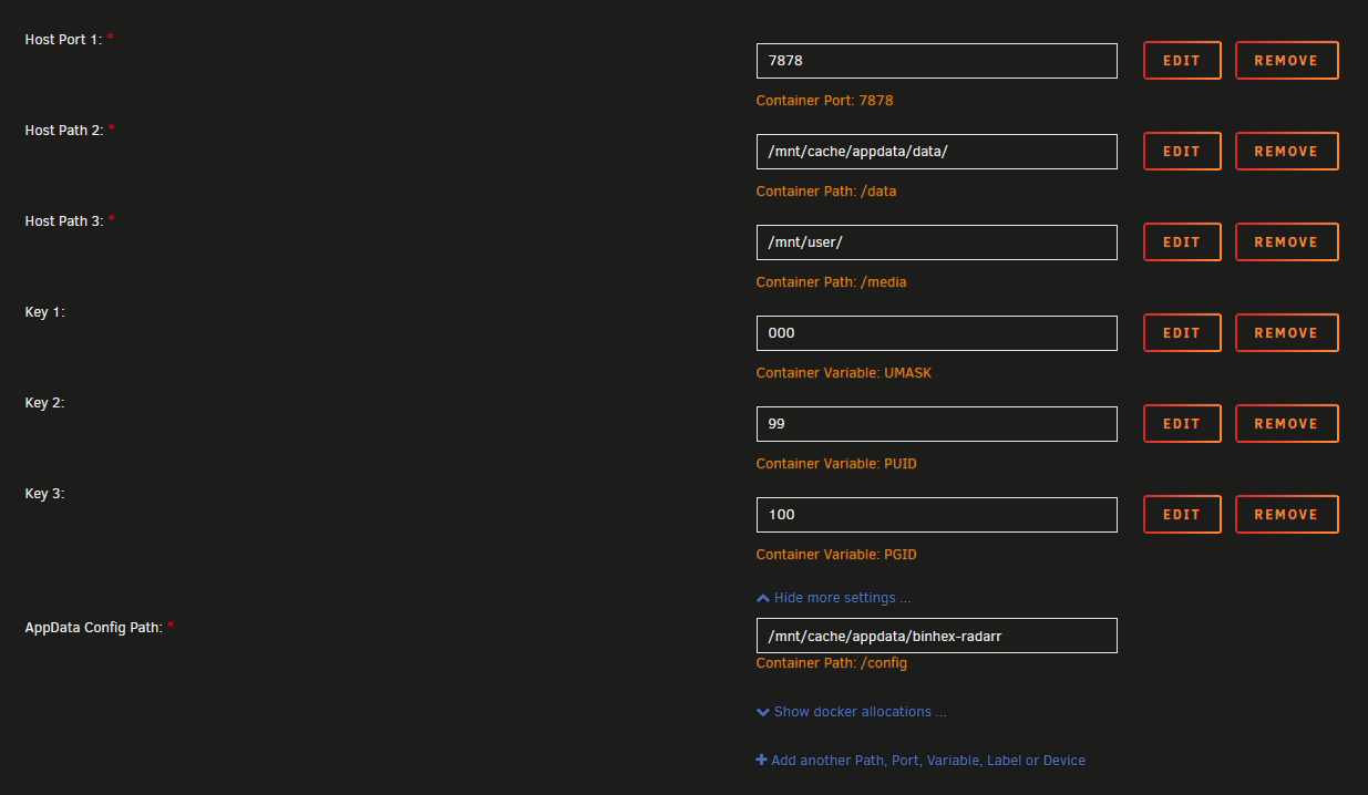

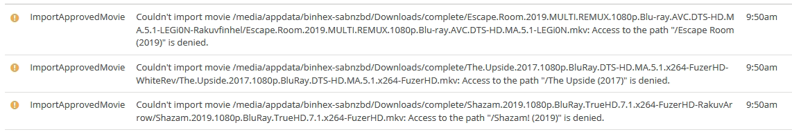

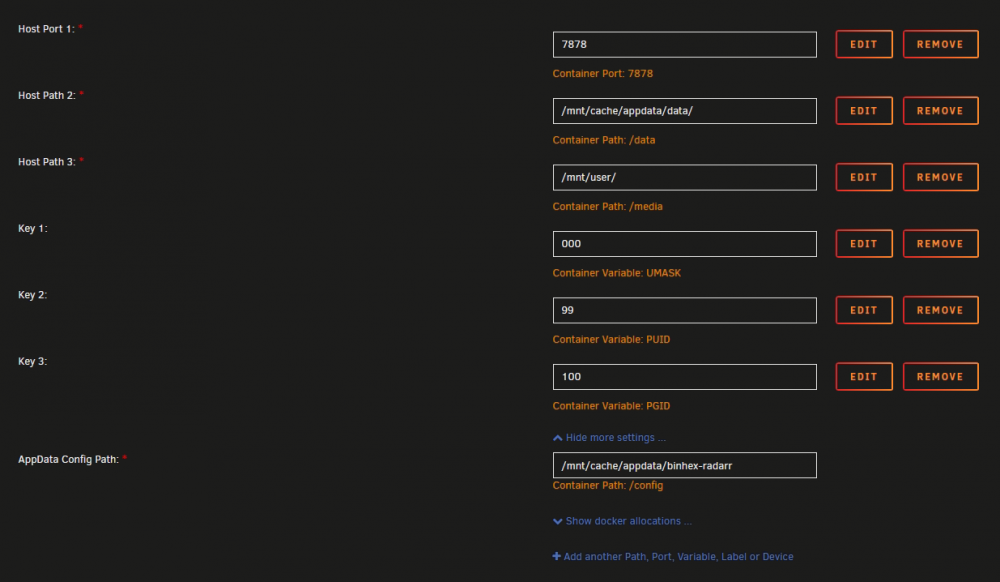

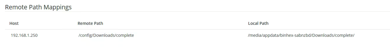

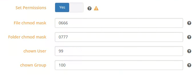

Hey guys.
Having some problems with permissions. Tried fix docker permission and tried new permissions too.
Keep getting this error in Radarr
Couldn't import movie /media/appdata/binhex-sabnzbd/Downloads/complete/"moviefolder"/"moviefile.mkv": Access to the path "/"movieFolder(date)"" is denied.
Using Sabnzb and radarr in dockers.
Settings as follows:
Radarr permissions:
Radarr Remote Paths
Just not sure if I have something wrong somewhere as it used to work.
Appologies in advance. I have limited knowledge of the unraid system and I fumble my way through things till they work. So I'm not sure if I have done something wrong somewhere. A movie downloaded last night and it seemed to work, but now I just get this error with all downloads.
Thanks!
59 minutes ago, jaemiem said:
Hey guys.
Radarr permissions:
Radarr Remote Paths
Thanks!

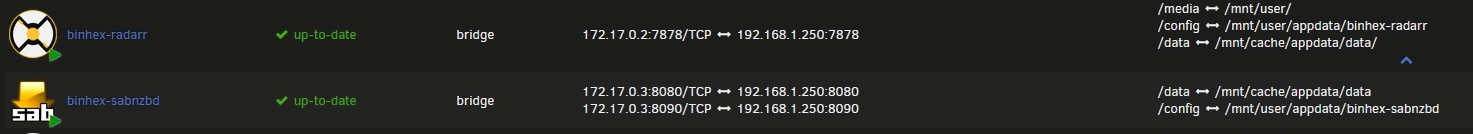

Your mappings don't match between the two apps
https://forums.unraid.net/topic/57181-real-docker-faq/page/2/#comment-566086
Thanks for that link. Still slightly confusing to me, appologies.
So would I be putting those mappings into one of the host paths? Or making a new path called /downloads?
I also presume that:
nzbGet                /config              /mnt/cache/appdata/nzbget
                         /downloads        /mnt/cache/appdata/downloads
nzbGet can be substituted with binhex-radarr / binhex-sabnzbd / etc?
EDIT: nm that last bit, re-read it all...
EDIT EDIT: I'm now reinstalling everything and trying to make sure all paths are the same. Will let you know. Thanks
Edited by jaemiem
