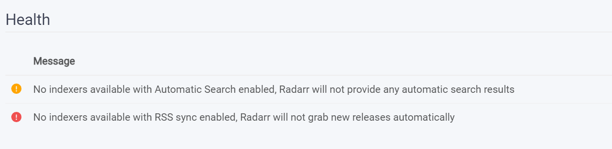

I just tryed to add radarr into prowlarr.
But i dont get the indexers from prowlarr into radarr. What can i do?
This is from radarr
Edited by DanielPT

On 11/5/2022 at 8:29 PM, DanielPT said:
EDIT: Okay you have to wait to the sync to run. All okay :)
This is from radarr
I think it's a prowlarr setting. Do you get a green check when you run a test of the radarr app in prowlarr?
Here is a guide that covers most of the setup.

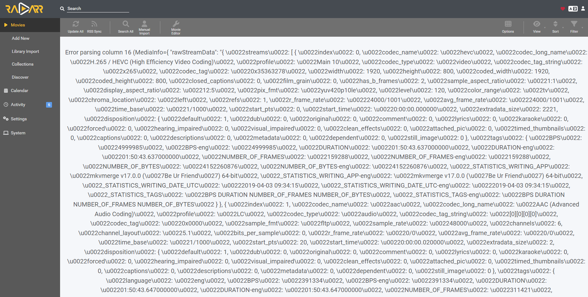

Hey all. Looking for some assistance. Having some issues with Radarr. The docker starts fine, but I get an error on the home page (see attached .png). I've removed the docker and re-installed it using previous apps in the apps tab of Unraid to no avail. I've attached the error & warning sections of the log. I really don't want to completely remove it and lose all my settings. Any ideas are appreciated. Thank you.
logs.txt
The logs contains Kill Bill Vol. 1 2003 Bluray-1080p.mkv, maybe the file is damaged or something. I would remove it and refresh the share.
Edited by Hogwind
Thank you for the help. I removed the movie, and reinstalled the docker to no avail, but I was able to restore a previous backup in the docker which worked. Thanks again!

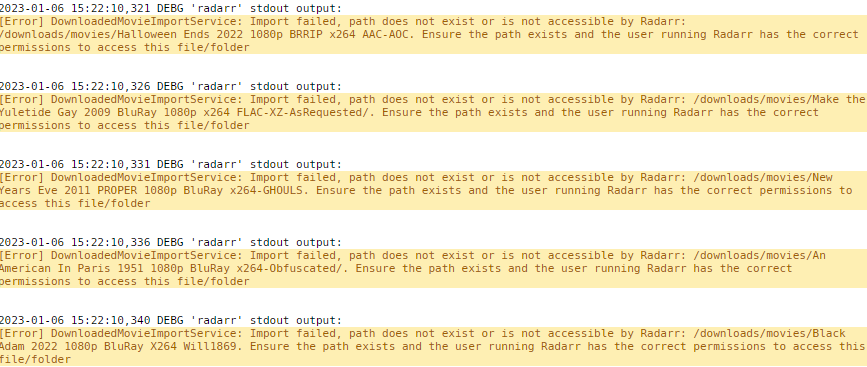

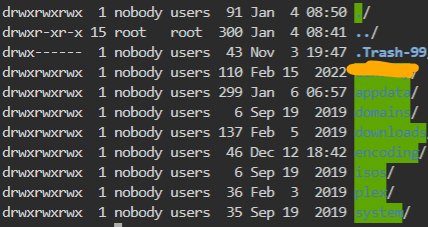

Hello,
I've had a near perfect running set up for almost 2 years now. About a week ago, i started to experience constant "All indexers are unavailable due to failures". This seems to be consistent for Sonarr and Radarr. I've tried rebuilding from backup databases, deleting and re-installing the apps from fresh, and from appdata backups. Sometimes I can manually download one or two files, then i'll get this issue from all my indexers. Any help would be greatly appreciated.
Radarr Logs.txt blackhole-diagnostics-20230101-2103.zip
3 hours ago, Cburners said:
Hello,
Radarr Logs.txt 28.58 kB · 0 downloads blackhole-diagnostics-20230101-2103.zip 110.48 kB · 0 downloads

I have been having an issue with radarr and sonarr the past couple weeks, where it can't import anything it downloads. I just get the error "Import failed, path does not exist or is not accessible by Radarr." I tried working through these issues in another thread. I've run the new permissions action on the share, but that did not work. Any ideas?
