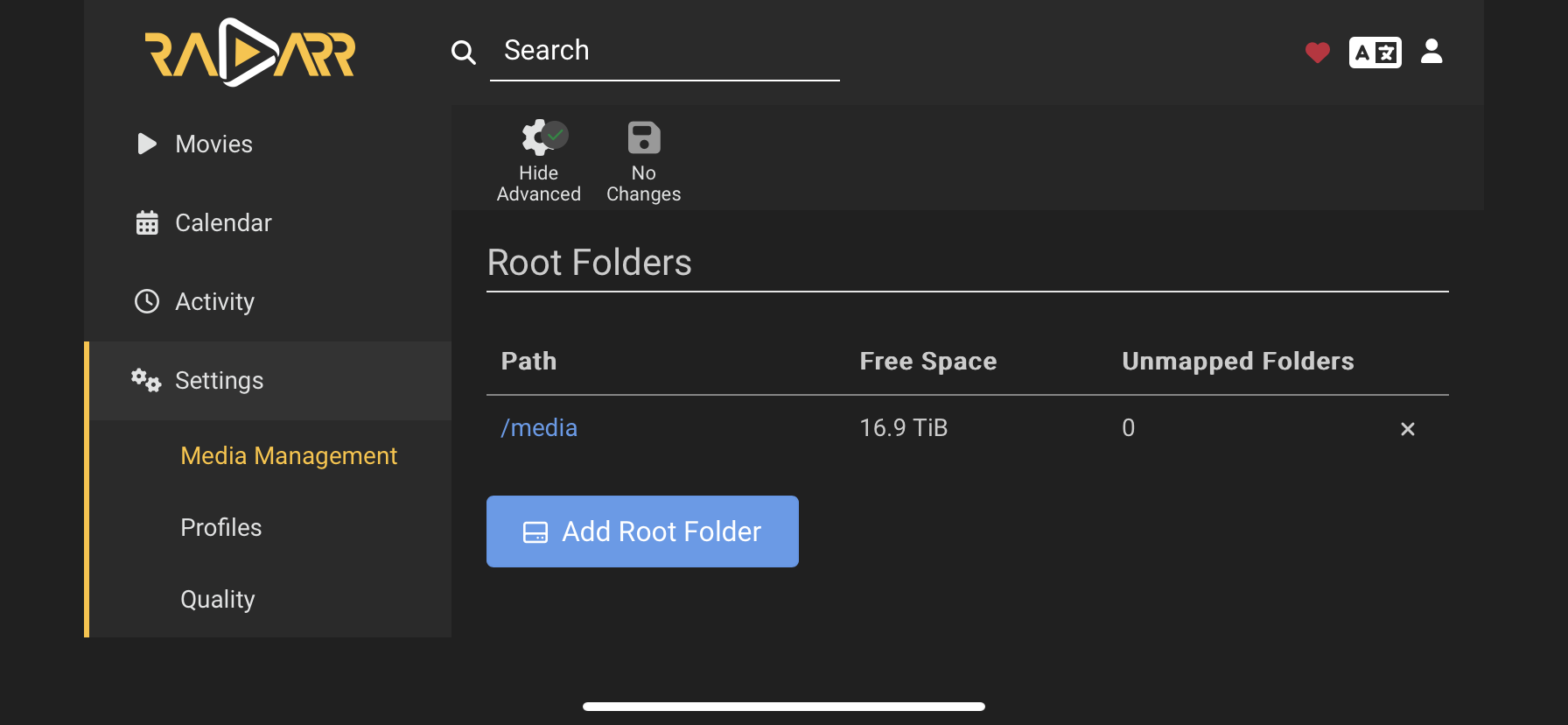

6 hours ago, wgstarks said:

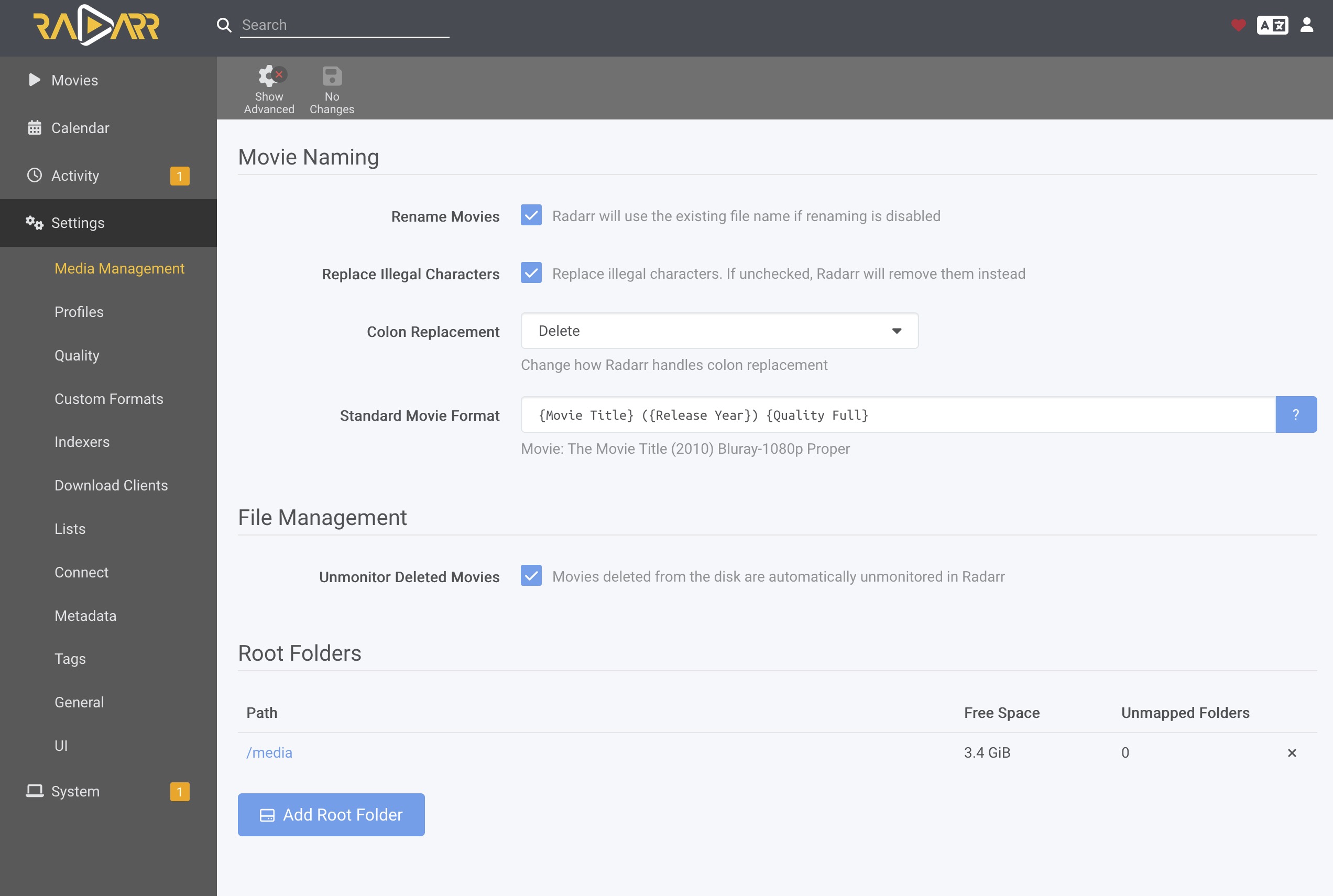

Here is what I have for root folders.
Just to be sure I’m understanding your issue correctly, you’re saying that Radarr is copying your movies from your download client (/data)  to your download client (/data)? How can you tell this is happening?
This was my issue, I had advanced options enabled and missed this field 🤦🏻‍♂️ Thanks for the help!

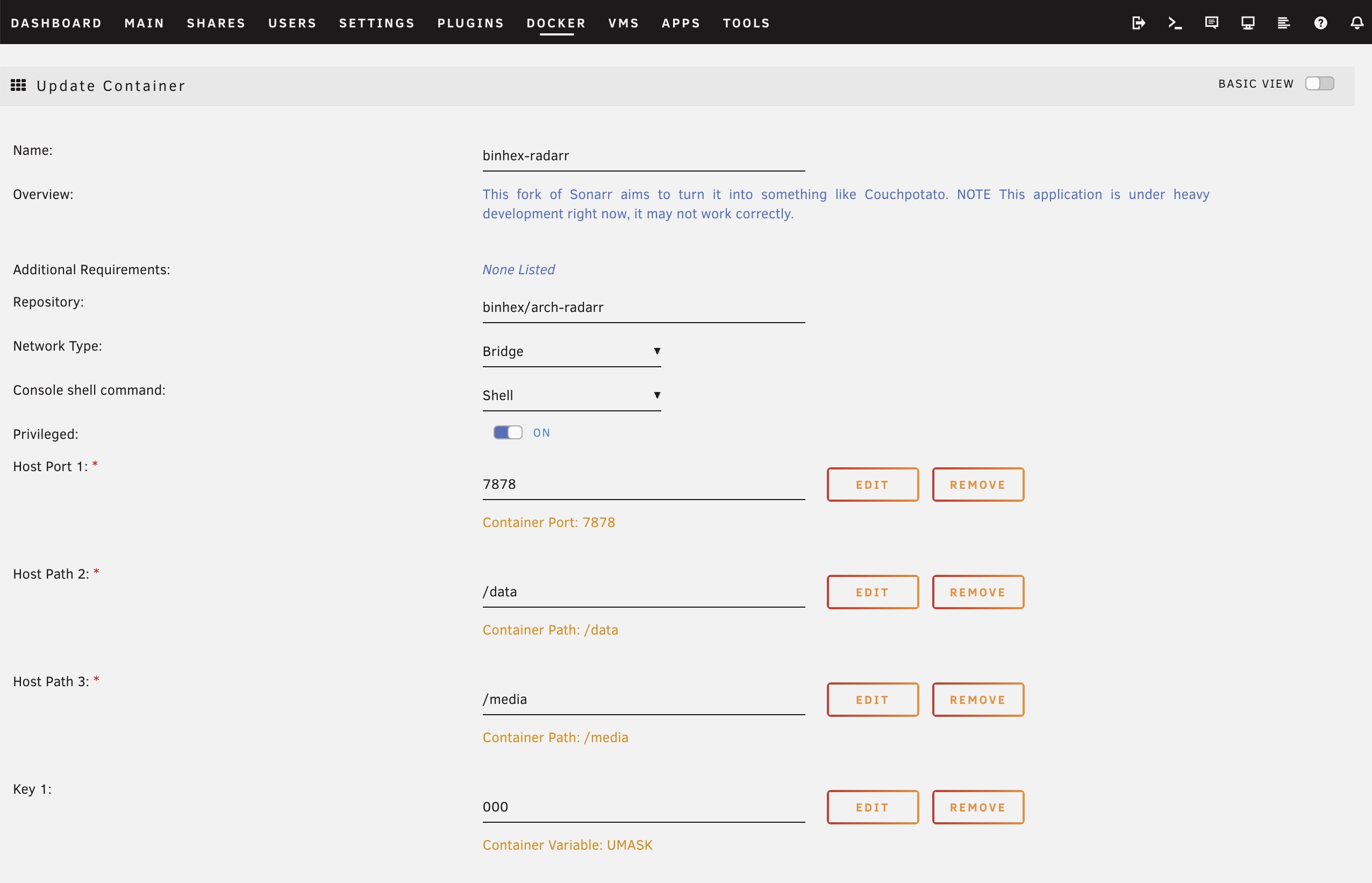

Hi. I'm new to Radarr and I've seen several videos and read several posts but I still have some problems I don't know how to solve. I've got the qbittorrent-vpn up and running and Radarr is configured and linked to qbittorrent, so when I add a movie it gets downloaded right away. From what I've read, it seems the *rr apps can later move the downloaded content to different folders (in my case /data/movies, /data/tvshows and /data/music) but I'm making some mistake because I don't know how to do that.
qBittorrent is configured to put all the downloads on the /data/downloads folder. I think that's OK, but from there, my doubts are now with Radarr (still haven't installed the others). I've got the /data/movies folder created, and I would like the Radarr downloaded content to be moved there. My Radarr configuration, though, seems to not be able to "see" the /data" folder even if I've tried to configured that in Unraid.
I don't even know why there is a /media second container path there, but again, the folder is there and I think that's OK. The problem is, when I go to Radarr settings and Media Management, the folder seems to have just 3.4GB free (¡?), when in fact the /data and /media folders are on my main array, which has 20TB.
How can I correct that, and how to "automove" those downloads to the right folder?
This video will likely answer most of your questions. If you still have any unresolved issues you can post them.
https://youtu.be/j6lT7zDkT4M?si=lLxfzrTVF0lwDi7_
Also, if you’re still having problems post your docker run commands for Radarr and your download client.

Thank you @wgstarks , after watching the video I've understood better those paths on the container configuration and now everything is going as I wanted, at least on my current tests. I've also configured Bazarr for subtitles and it is running perfectly too. It feels almost like magic when everything works and is on its place :)
Regards!

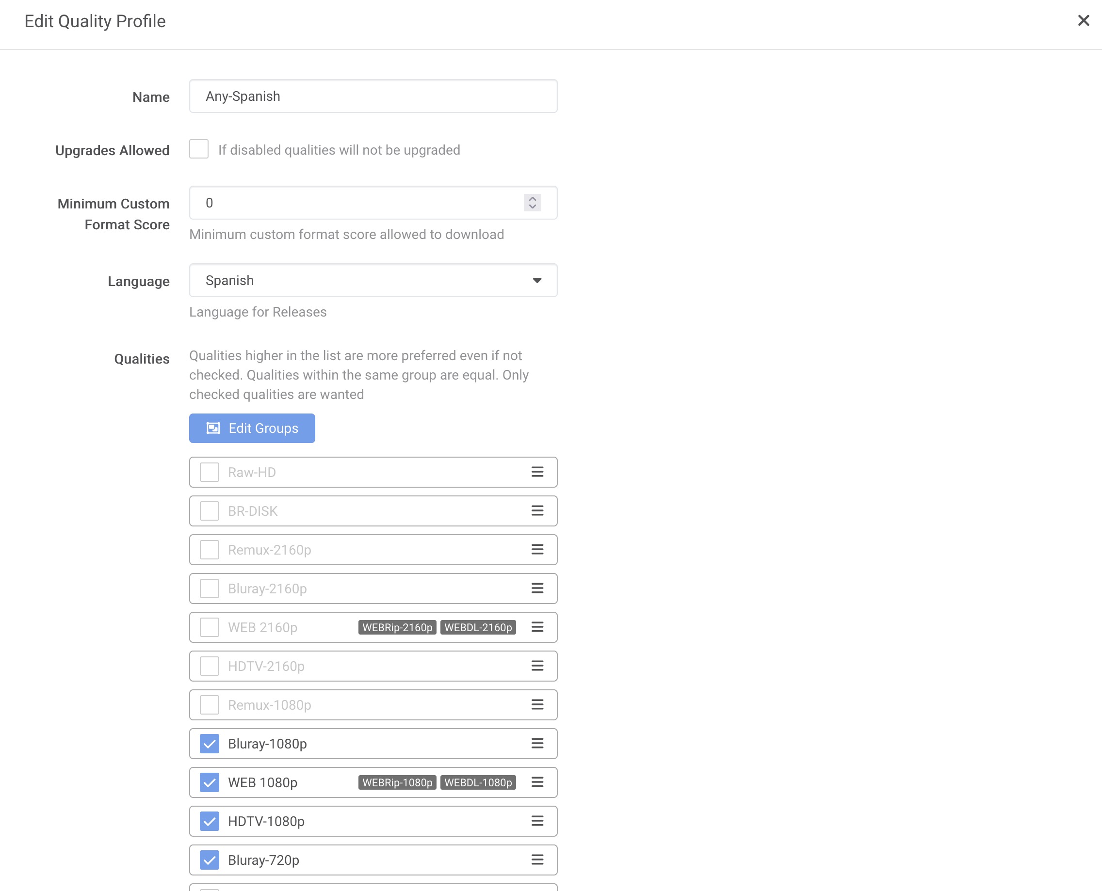

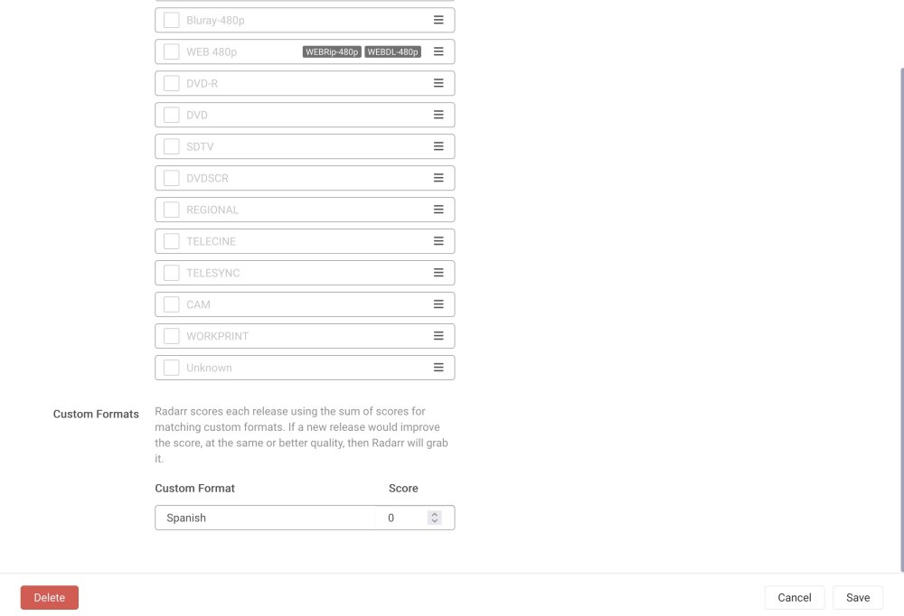

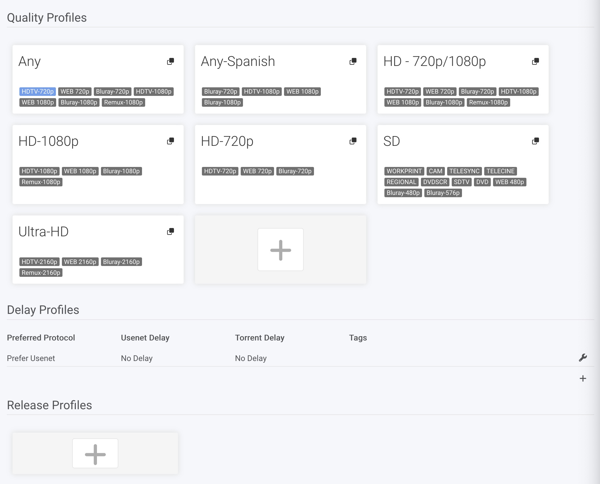

BTW, now there I'm here, I'm trying to use custom profiles to get certain movies in certain languages besides english, but I'm making some mistake again.  I've tried to create a quality profile called Any-Spanish, for example but I don't know if what to put on the Score option.
1813339786_Capturadepantalla2023-12-13alas18_53_22.thumb.jpg.b55ae6515c969ddda00ec51e23f7e7a0.jpg
107212309_Capturadepantalla2023-12-13alas18_53_45.thumb.jpg.d925414a866885252b55917bc8c675f6.jpg
Besides that, I don't know how to select (or force) the "Any-Spanish" profile when searching for new movies. I don't see that option, and even in the search options on a particular movie, where several torrent appear with language, I don't see Spanish, though I would have expected to.
Can someone explain me how to do that and in that case download the version in the language that I want, not having it in English  and then in Spanish, for example (if it appears as a search result)?
You would assign a value for each custom format at the bottom of your screenshot (1 for example) and then set a minimum value near the top. Radarr will check the available torrents and assign a score to them based on the total of all custom formats that apply. It will then download the highest scoring torrent.
For your situation if you only have the Spanish custom format and give it a score of 1 and also set the minimum score to 1 only Spanish language torrents will be downloaded. The rest should get skipped.
You can also set a language on the quality profiles. For instance you could create a 1080p Spanish profile and set it when you add the movie in Radarr.

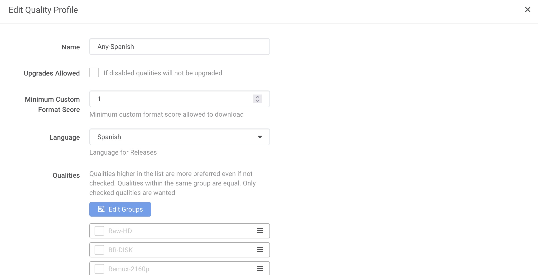

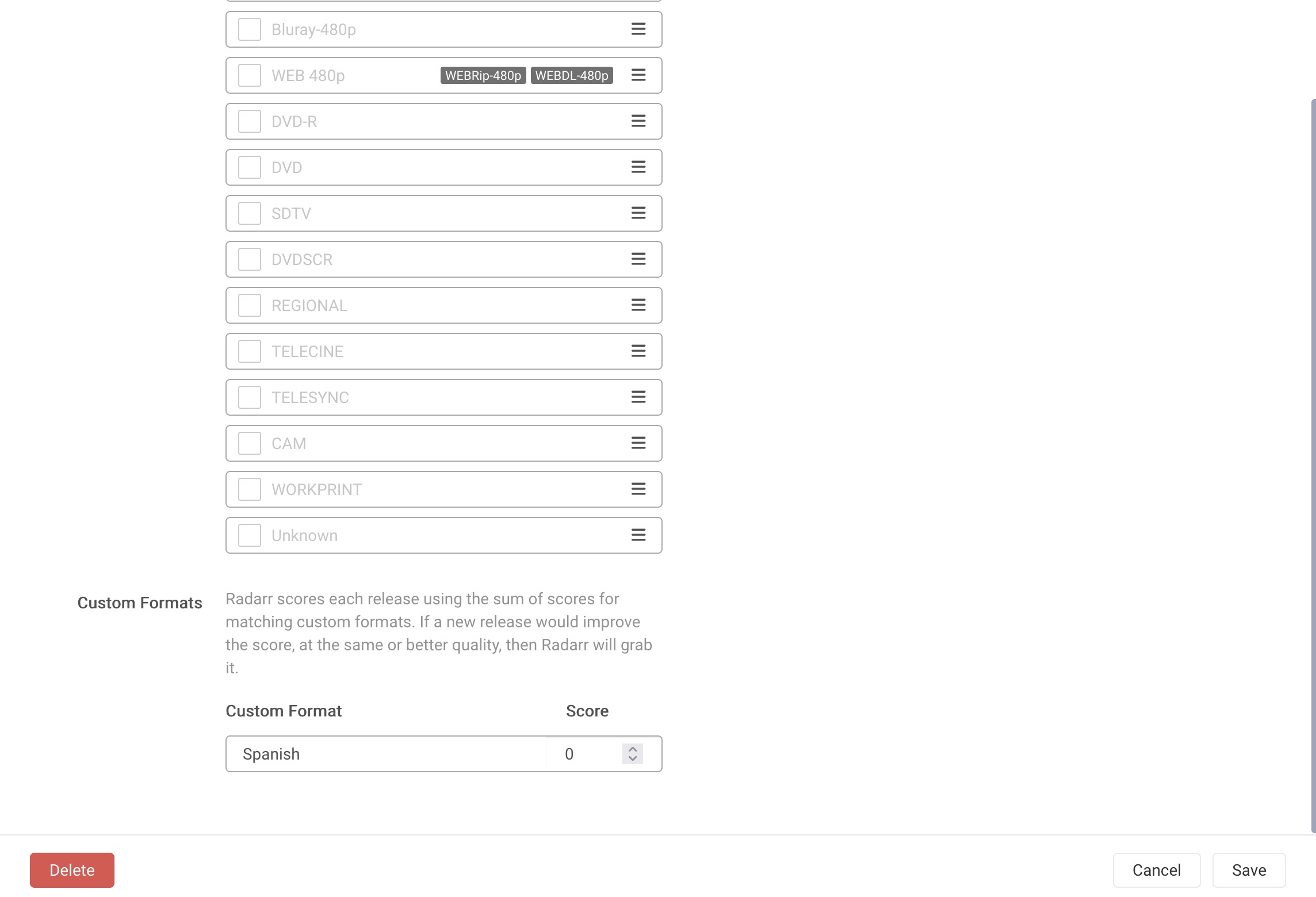

I'm afraid I still don't know how to do that. I've set the score to 1 and also set the minimum score to 1 in the quality profile I've created, but even with that i've tried several movies —some of them do have Spanish versions— and they still ignore that preference. Do I have to "move" quality profile "cards" to put "Any-Spanish" before "Any" or something like that?
355125285_Capturadepantalla2023-12-14alas9_31_45.thumb.jpg.3b74f59ea170700796e1b7d813e4f09e.jpg
1652095524_Capturadepantalla2023-12-14alas9_30_40.thumb.jpg.d6be18000e66714b695608e17b274956.jpg
Please describe exactly what you mean by “tried”.

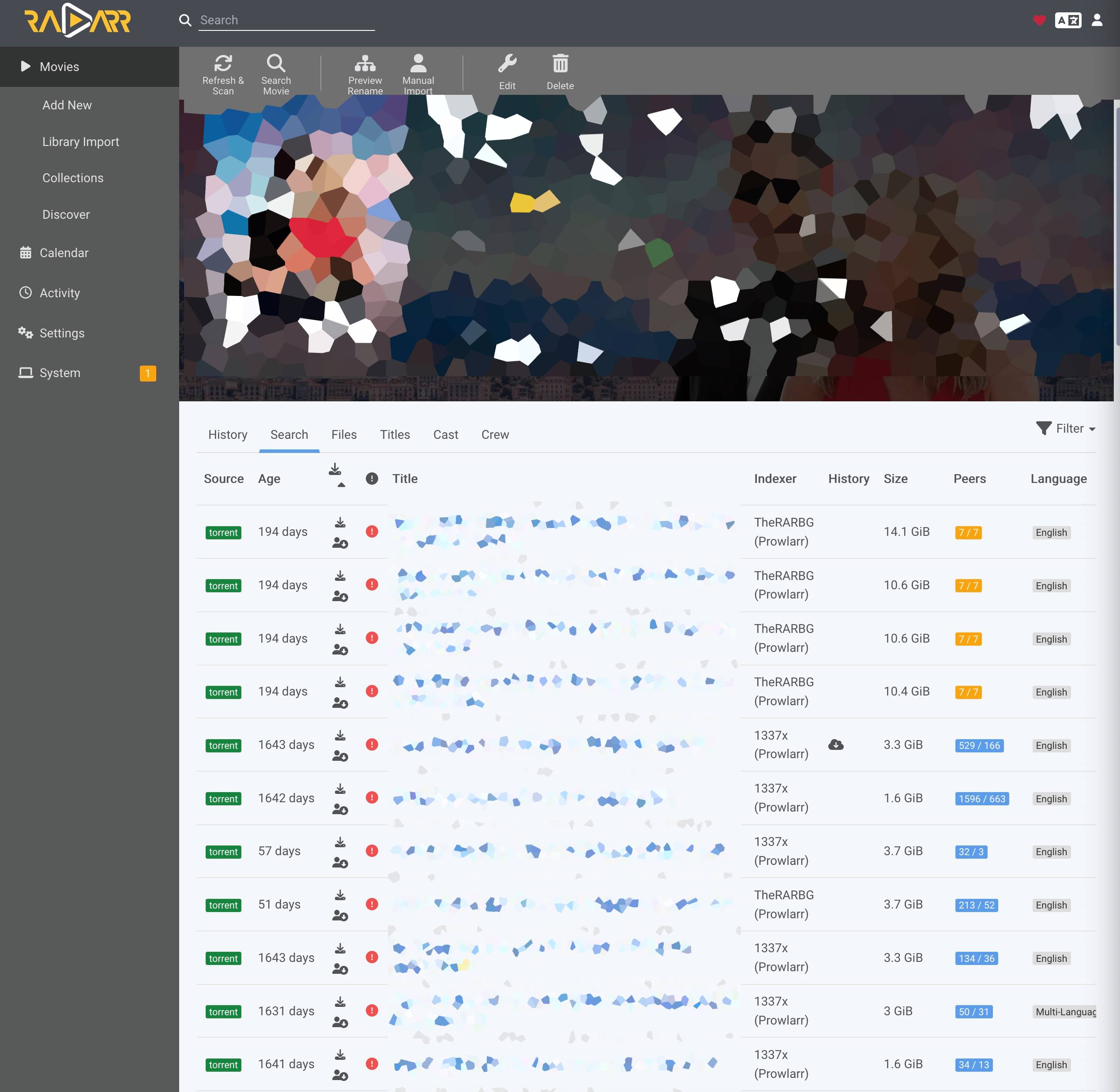

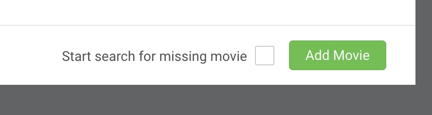

Oh, ok. So the process is:
Search for certain movie in Radarr. It gives some search results, I select the one I'm interested in, but I disable the "Start search for missing movie" right away because if i select that it starts downloading the English version (because I have made some mistake and I don't know how to select the Spanish if I want that version instead in some cases).
1940742825_Capturadepantalla2023-12-14alas17_13_08.jpg.92cb7b2fa78a6295b8872b927a9d1514.jpg

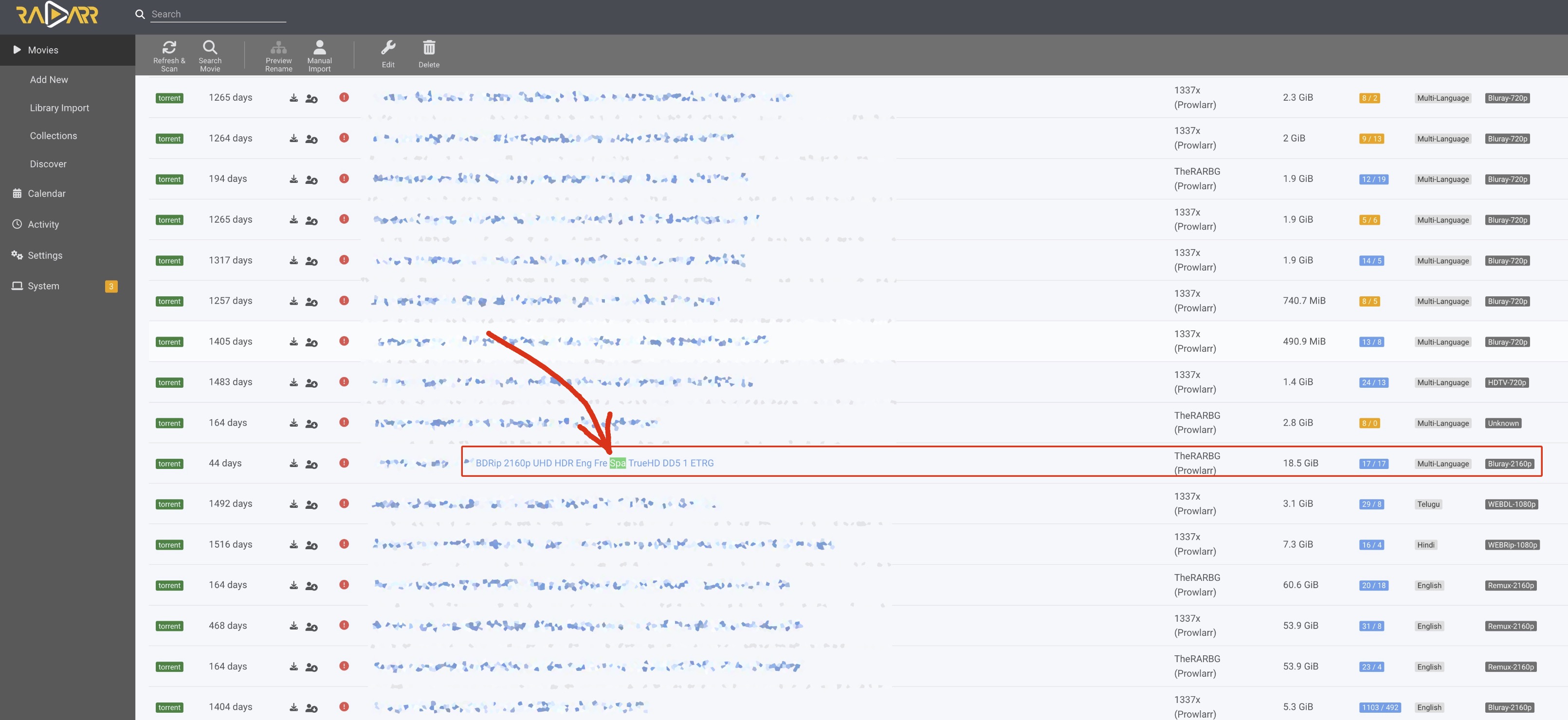

If I click in the movie poster and then I click on the "Search" tab I get a list of possible torrent files with their features. Some of them include the Spanish language and those would be the ones I'm interested in, but my current configuration downloads the English ones, not the ones I would want (again, not always, but sometimes).
477540025_Capturadepantalla2023-12-14alas17_19_46.thumb.jpg.dd6a17b87541177d8d37e916af0feb46.jpg
So two qestions. One, how to make that Radarr knows and selects that "Spa" version of the image (it's an example), and two, how to be able to select English for certain searches, and Spanish for others. I've tried to consult Radarr's documentation, but the Audio Language part isn't really clarifying for me.
On the same screen where you are disabling the “Start search for missing movie” there is also an option to select the Quality Profile. If you select the Any Spanish profile here it should only download a Spanish language version. To be clear though, I haven’t tested this. It could be broken. If that doesn’t work for you I would suggest posting on the Radarr forum. More people there with a better understanding of Radarr under the hood.
That makes sense. I'm trying to test it but for some reason, even though I've got several indexers and Prowlar and some of them should include results in Spanish, they always show results in Hindi and Italian. It's weird. I'll test more and see where this goes. And I'll ask too in the Radarr forum to see if there's any luck.
