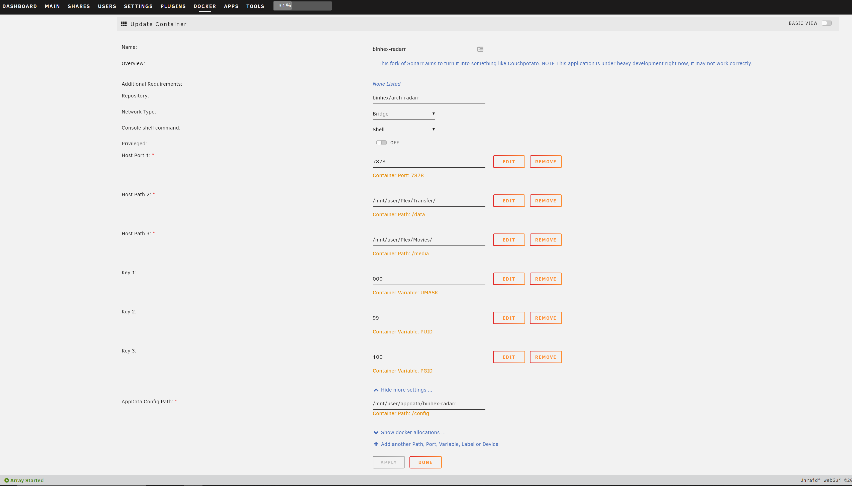

I mapped the folder that has all the movies exactly like i did with the TV shows for Sonarr  but then i try and add it in the radar app  its blank and no movies show up i keep reading its possible a permission issue but not sure how to fix this  any advice is appriciated
What do the logs show when you attempt to import the files?

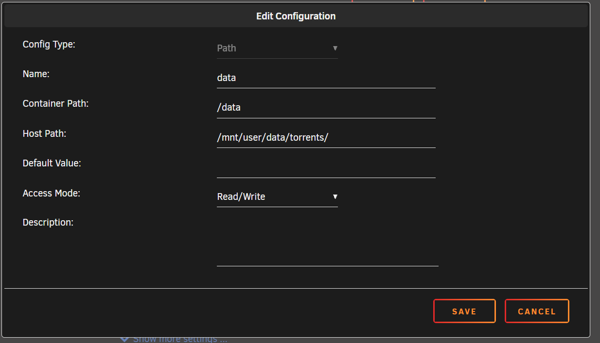

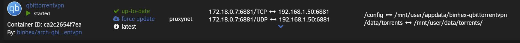

Hmm i really dont understand why i get this error
You are using docker; download client Qbittorrent places downloads in /data/media/torrents/movies but this directory does not appear to exist inside the container. Review your remote path mappings and container volume settings.
Looking at this
https://trash-guides.info/Hardlinks/How-to-setup-for/Unraid/
And this:
Qbitorrent:
Default save path: /data/torrents
radarr:
Can somebody figure this out? :)
Thanks!

Thanks for the reply :)
I just followed Ibracoprs guide :)
But i still get the error?
QBit:
radarr:
Isent that correct?

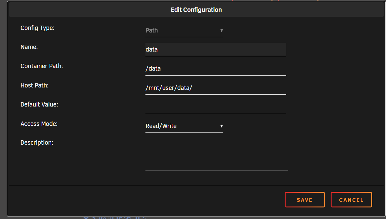

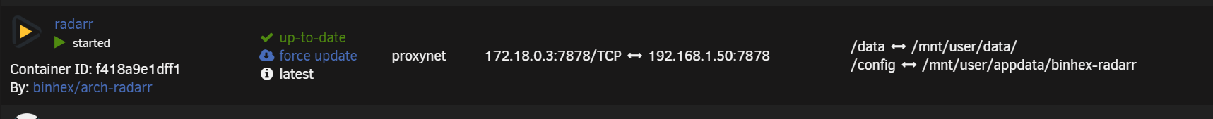

2 hours ago, DanielPT said:
Isent that correct?
No. They don’t match. This configuration will result in Radarr not being able to find the completed downloads and results in the error you posted. Change your qbit and Radarr configurations to /data:/mnt/user/data/torrents.
Ahh i changed it in Radarr and now it works!
Thanks man!
