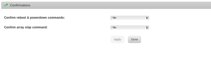

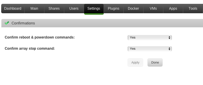

one of my servers had the setting for confirmation of reboot and powerdown set to no
the other had the same settings set to yes
both rebooted with no confirmation using the reboot button on the main page

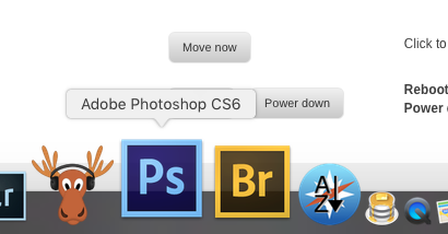

with them being at the bottom of the page now, i've already accidentally clicked them twice trying to start an app from mac dock with unraid webui still open.
both servers reboot regardless of whatever is set there
this is going to get annoying rather quickly

the screenshots of the unraid settings page for confirmations are from two different servers, yes or no setting makes no difference, both reboot with an errant slip on my macbook trackpad.
I don't see that behavior, meaning confirmation works as expected.  This is with a test server with no plugins.
Maybe tabbed view would be better for you?
whatever is set for confirmations, yes or no , the server reboots or powers down with a single click/tap on the respective button.
I don't see that behavior.  If confirmation is set to yes I see a "Proceed?" diaglog box pop up.  If set to no then it does execute the action immediately.  Again, on a stock install, no plugins.

whatever is set for confirmations, yes or no and on either server, one click on the respective button shuts down or restarts the server.
