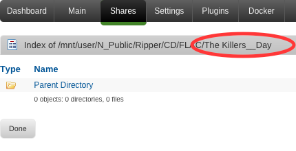

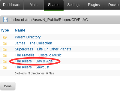

There's a minor display problem when browsing folders within the Dynamix GUI if a folder contains the ampersand "&" character. The folder name is truncated at the ampersand and the folder is displayed as empty. Here's what it looks like at the command line:
root@Northolt:~# ls -l "/mnt/user/N_Public/Ripper/CD/FLAC/The Killers__Day & Age"
total 323592
-rw-rw-r-- 1 nobody users 32838728 Feb  5 17:08 01\ Losing\ Touch.flac
-rw-rw-r-- 1 nobody users 29543389 Feb  5 17:11 02\ Human.flac
-rw-rw-r-- 1 nobody users 35121479 Feb  5 17:14 03\ Spaceman.flac
-rw-rw-r-- 1 nobody users 29049279 Feb  5 17:17 04\ Joy\ Ride.flac
-rw-rw-r-- 1 nobody users 25815710 Feb  5 17:19 05\ A\ Dustland\ Fairytale.flac
-rw-rw-r-- 1 nobody users 28058602 Feb  5 17:21 06\ This\ Is\ Your\ Life.flac
-rw-rw-r-- 1 nobody users 23348194 Feb  5 17:22 07\ I\ Can't\ Stay.flac
-rw-rw-r-- 1 nobody users 21549017 Feb  5 17:24 08\ Neon\ Tiger.flac
-rw-rw-r-- 1 nobody users 34590571 Feb  5 17:26 09\ The\ World\ We\ Live\ In.flac
-rw-rw-r-- 1 nobody users 43984558 Feb  5 17:29 10\ Goodnight,\ Travel\ Well.flac
-rw-rw-r-- 1 nobody users 27431861 Feb  5 17:31 11\ A\ Crippling\ Blow.flac
-rw-rw-r-- 1 nobody users    1034 Feb  5 17:31 Killers,\ The\ -\ Day\ &\ Age.m3u
root@Northolt:~#
and attached are GUI screen shots.
