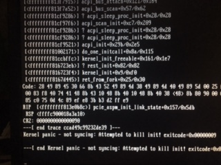

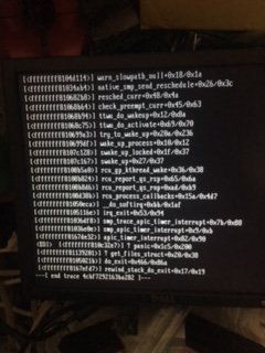

Getting kernel panics at boot up with 6.3. 1st picture is normal boot up with KP. 2nd doesnt have a KP but it freezes and i removed all plugins. Safe mode gives the KP.
I had this problem going from Version 6.3.0-rc6 to Version 6.3.0-rc9 as well but at the time didn't have time to trouble shoot it or report it.
Diag is attached but not sure if it will help at all since it wouldn't boot and i had to go back to 6.2

People - please don't post the same issue in multiple places.  If you think your issue is not receiving proper attention, the best way to pester me is via email: [email protected].
Probably because you guys didn't and those people with Kernel Panics need a way to roll back?
I had to spend 10min trying to find it myself.
The 6.2.4 download link has been restored here:
https://lime-technology.com/download/
However, it won't be there long.  All previous releases are EOL.
