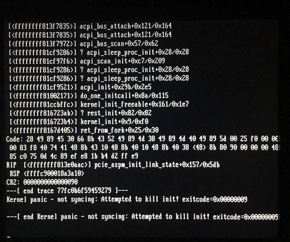

I just updated my monster Supermicro server after it finished its parity check, no issues so far.
I still get KP at boot up. Had to go back to 6.2.4. Diag attached is from 6.2.4
Kernel Panic - not syncing: Attemped to kill init! exit code=0x0000009
won't let me attached diag but you can find them from 2 days ago here http://lime-technology.com/forum/index.php?topic=56204.msg537031#msg537031
Good to know, I wont bother trying to update then.  They didn't even acknowledge this was a problem in the last build, so I wasn't expecting it to be resolved in this one.

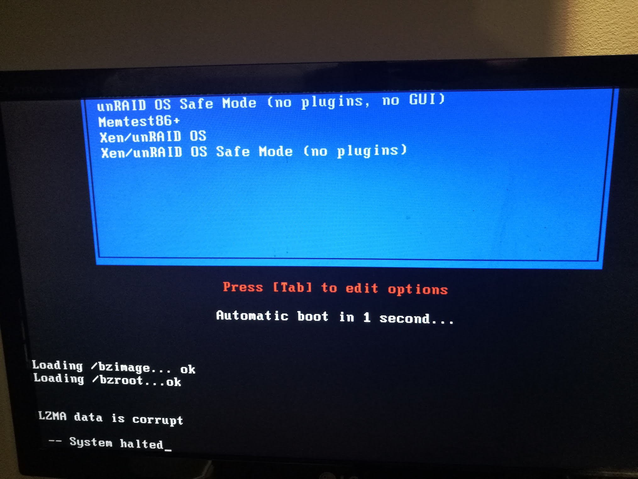

Updeted through webgui, said system needs to reboot. After reboot the server wouldn't boot properly so I connected a monitor and got message LZMA data is corrupt - System halted.
I pulled the usb drive and did a checkdsk, no errors reported. Plugged it back into the server but still got the same problem.
Attached photo
I didn't take a backup since i upgraded via webgui, but I have a diagnostics from a couple of weeks back.
Attached photo
Googling LZMA leads me to believe that the files on your flash drive are corrupted.  I would download the update and copy all of the bz* files to your flash drive and try again.
