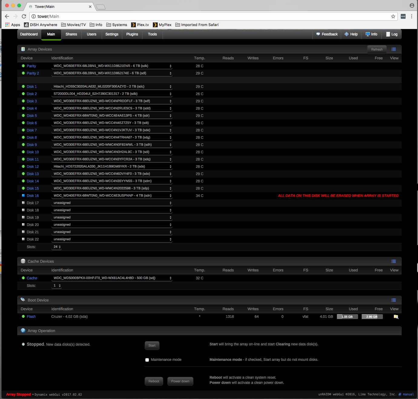

Hello - I'm attempting to preclear a 4TB drive to expand my array but after each successful preclear, the array appears to want to Clear it again before adding it.
I've attached diagnostics, preclear reports and a screenshot of the "Start will bring the array on-line and start Clearing new data disks" message I'm concerned about. Please let me know what else might be helpful to troubleshoot.
I'm hoping to avoid multiple hours of downtime by pre clearing and the language I'm seeing seems to tell me thats what unRAID intends to do once I click start. Am I misunderstanding the meaning or is something not right?
That's normal, unRAID only checks for the preclear signature after starting the array.

FYI, since v6.2 clear is done with the array online, but disk is not tested like when using preclear.

As a follow up to what you noted above, I proceeded with starting the array and unRAID picked up the preclear signature and prompted for only a quick format. Everything as you indicated. thx
