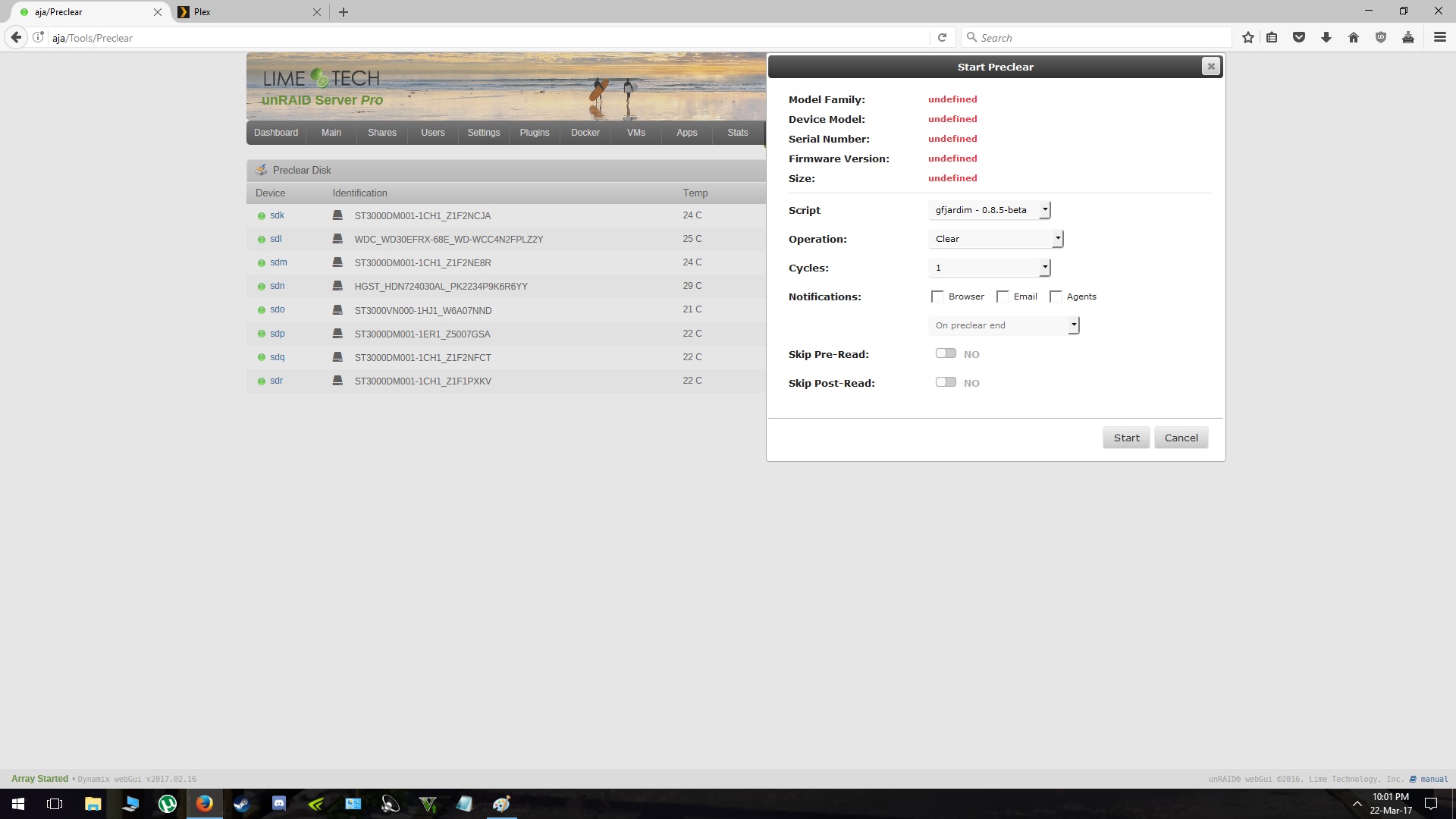

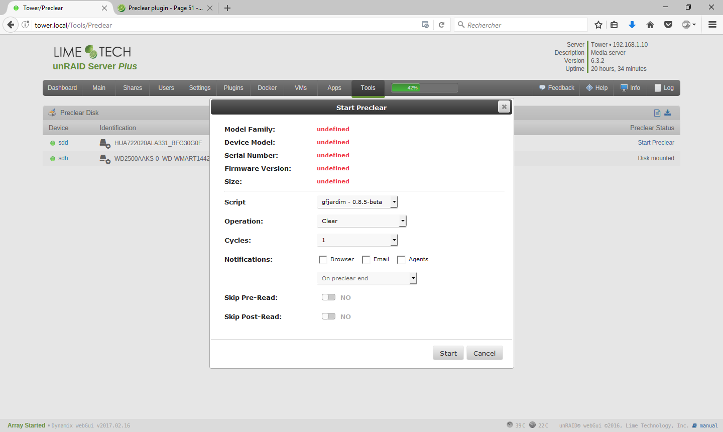

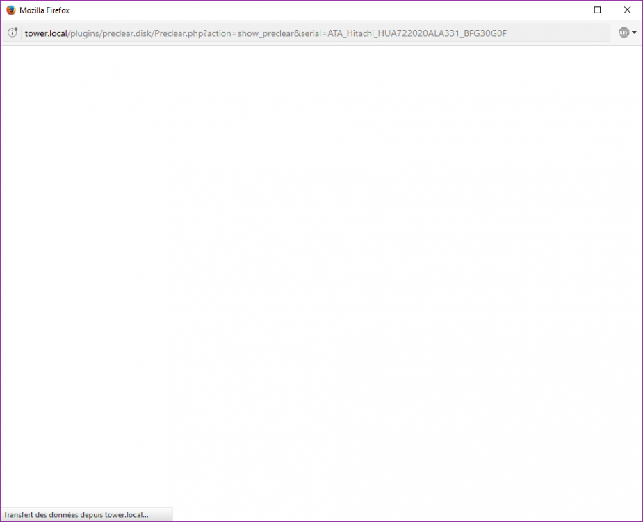

I am having the exact same issue, and the log is 0 bytes, nothing inside!
Nothing shows up in the log when I try to start the preclear. I have attached 2 screenshots. The main preclear window, and the popup that opens and closes right away.
New user here and Preclear will not run on my system.
It just says starting next to the disks that I've clicked start on.  What should I do next?  What did I do wrong?
mcp-diagnostics-20170322-2303.zip
