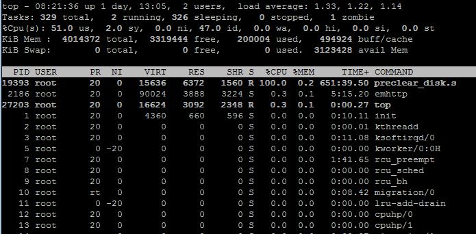

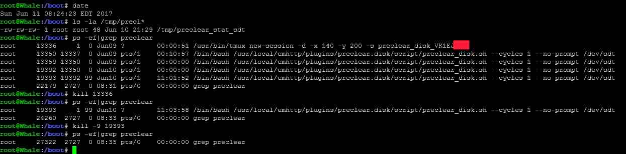

I am also having an issue with the plugin stalling. I am in the post-read step of a preclear of an 8TB disk, 22% in, it seems to have stalled. Percentage hasn't changed in hours, time elapsed is also stuck.
htop shows the preclear script as running (pegging the cpu core at 100% constantly) and there are two other related active processes: "cmp - /dev/zero" and "dd if=/dev/sdb bs=2097152 skip=1 iflag=direct".
Is the preclear still ongoing? Is it only the reporting aspect that is borked? Should I wait another 10 hours for it to finish?
The preclear log only shows that the post-read has started, nothing after that.
I checked the folder /temp/.preclear/sdb/ and the cmp_out, dd_output and the display_output haven't been modified in hours.
Thanks
