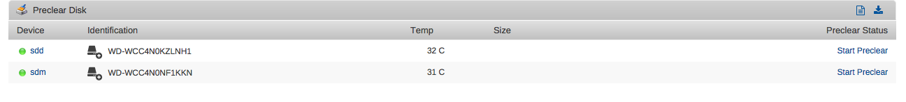

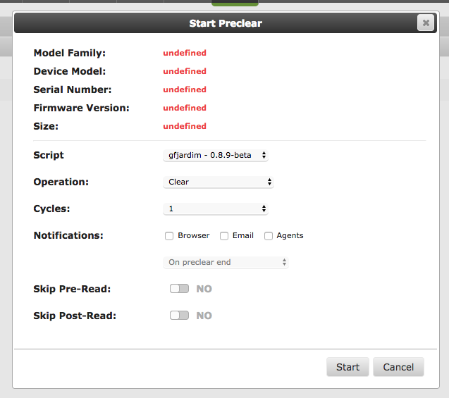

Just installed a new drive. Was about to preclear it however, everything about the drive is coming up undefined. It is the same for the other drive that I have (which is already precleared).
Any ideas? Have attached a screengrab and logs.

21 minutes ago, ekim said:
Think so.
This is the version I am running: 2017.07.04
That's right. Which disk are you having problems with?
Edited by gfjardim

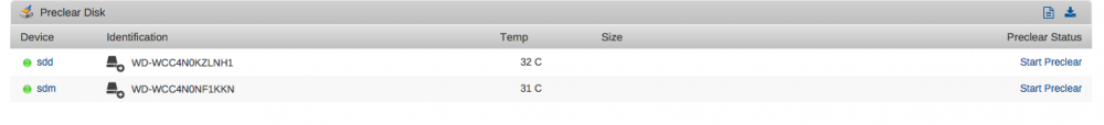

Both of the drives show the same "undefined" thing.
WCC4N0KZLNH1 is already precleared (did that about a month ago). WCC4N0NF1KKN is a new drive to me (although second hand) and what I was looking to preclear.

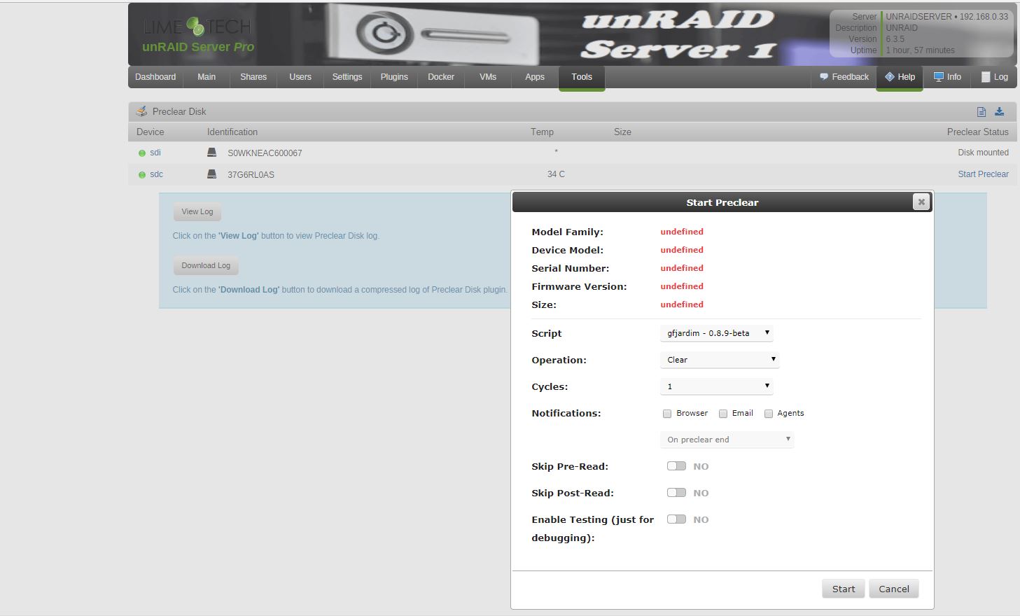

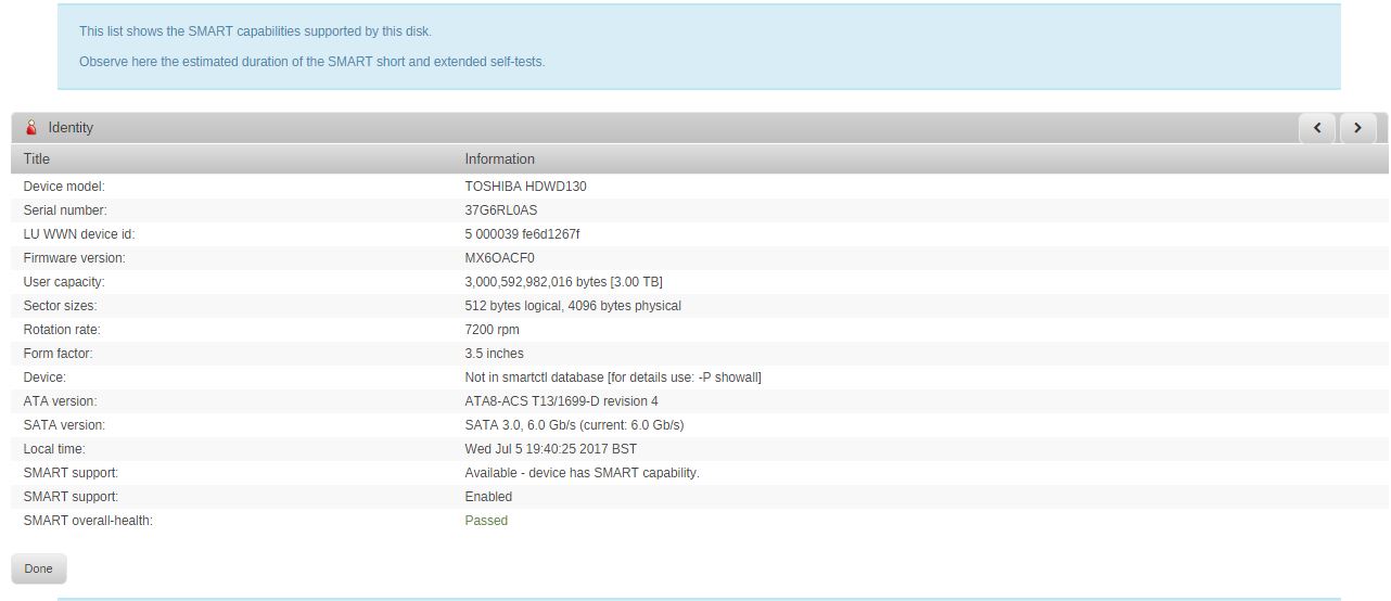

I am also having this issue, I started a new thread not realizing this existed, mods here it is if you want to delete it
Edited by mbc0
Wrong Pictures
Please update your plugins and send me the Preclear Disk logs as shown below.
