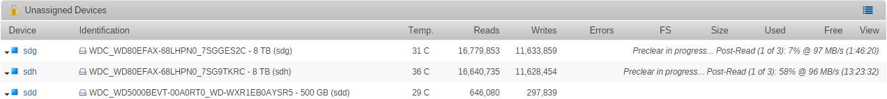

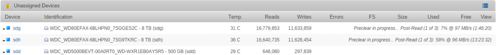

I will preface everything by saying I am not running the latest version of the plugin. I thought I updated it but before I started my latest preclear but I didn't. I am running the 2017.03.31 version.
I have 2 8TB WD Reds (WD80EFAX) that I shucked from external enclosures. They are both connected to a 2 port pci-e SATA expansion card. I launched a 3 cycle preclear on both drives within about 1 minute of each other. I checked them today and the preclear status messages are frozen (see image below) on sdg. The read and write operations are both still increasing at about the same pace. Is it safe to assume that the preclear operation is still proceeding as normal on sdg and the status updates are just frozen? Everything on sdh appears to be going as it normally would. I am wondering if I should kill the preclears and update the script or just keep going?
Update: the status updates have now frozen for sdh but it continues to accumulate reads. Is the preclear still running and the status updates are just frozen?
Edited by wsume99
